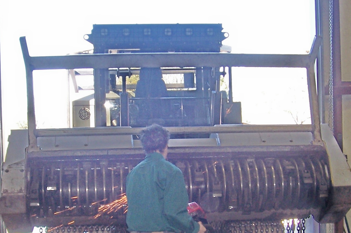

Oh forgot this one.
Yes a excavator is more efficent. Jon is right, turning a level turret is much easier than moving a 10k machine on 6' of tracks while raising the head and running it. You mulch on the down swing with an excavator so all your driving hyd is the head. Your only opening the sylinoid(spell) to let off pressure to boom down.
Also here is a picture of our big boy. A DAF-250Ex
