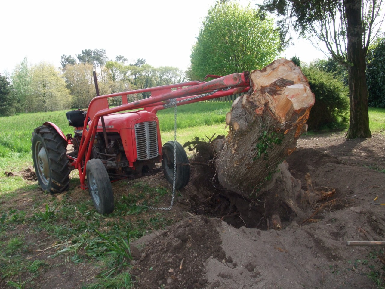

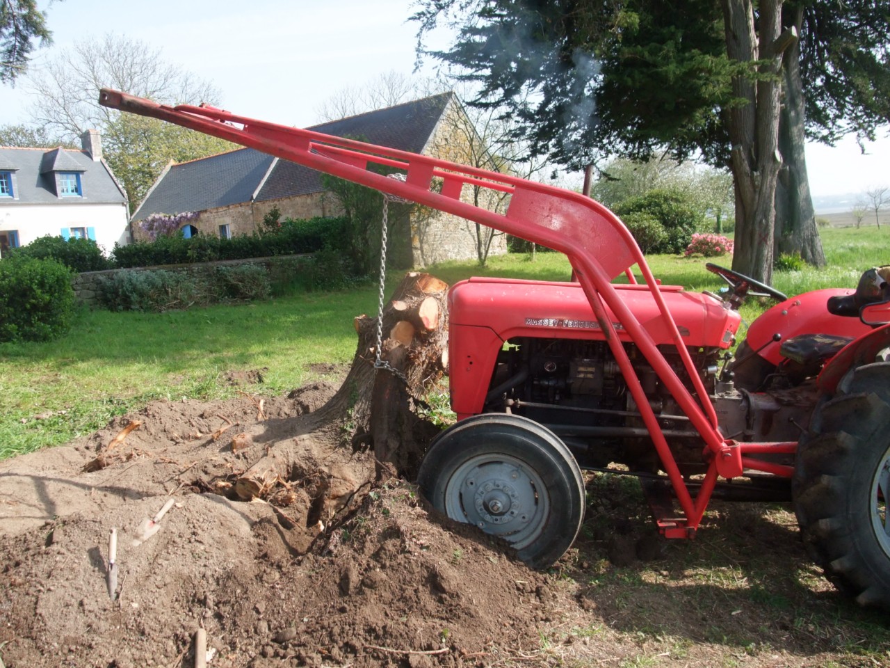

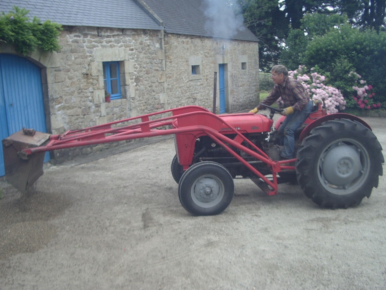

4WD and power steering as I now have on my JD 3520 sure make things easier and much more comfortable, but I used my MF 35 and her FEL for 14 years to carry dirt, stones, tree trunks, pull out stumps or do a bit of grading and found them very efficient too.
