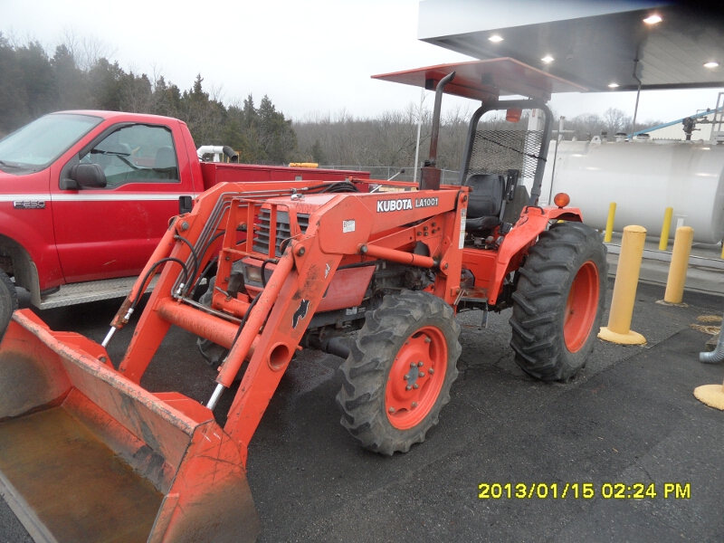

Call Messicks.
Going on about a year ago I was looking for a 40HP w/ 4WD & FEL for < $15K. Messicks had one. But I bought my M4700 w/ 4WD and FEL for about $12K first. 50HP, 10 more than I wanted, but I put up with it.
