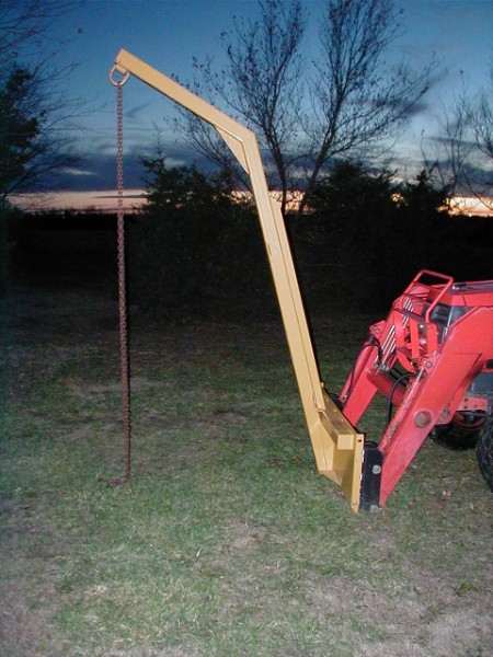

Rick,
Mine is factory built by Quality welding. This is their link,
http://www.qualityweldingservice.com/liftboom.html
It has been very handy, well designed and built. I don’t recall the exact total lift but it is around 20’. If you need the exact total I’ll hook it up and measure.
Jerry and Guy both built good looking attachments… I came across this one and figured it would be tough to improve on…
KennyV.

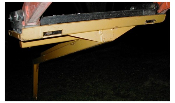

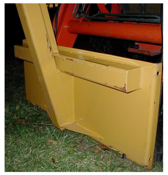

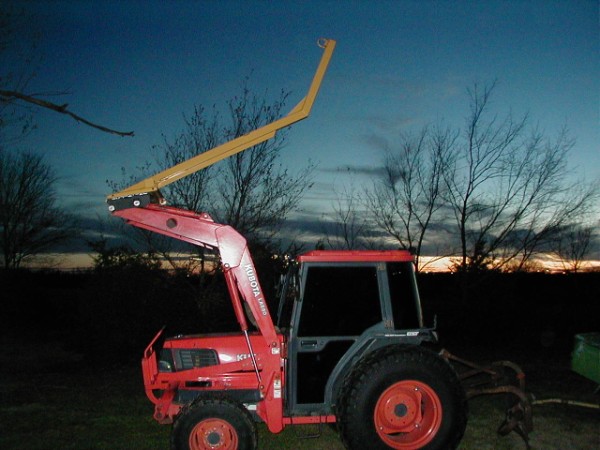

Dullpain…
I can give you a few measurements now but it will be after this wkend before I’ll be able to give you any exact angles, If you wish I will also attach it and get a few pictures that may be of more help. For now I can give you …
3.5 X3.5 Square tube… 7 foot and (I think at 45 degrees) 3 foot. Ends capped, welded.
Lift on my L4200/LA681 loader, with Quick-tach. 18’ 10”
Back rib is 2” X54” 3/8 plate
Gusset at boom 45 degree angle, 12” X 3” 3/8 plate
Skid steer bracket is 3/8” standard size.
With a 40” 3.5” X 3.5” square tube cross piece.
Boom is attached to plate at a few degrees from flat .. I’ll get a close up picture for you.
The distance from attachment plate will vary depending on position of bucket curl, (dump), but I will give you some measurements and a picture or two with that.
The price now looks like $645… check my earlier link to quality welding. I think I paid around $500-$550 with shipping. It weighs around 300 pounds as I recall. They at times have had these on Ebay.
If you think you want the other pictures & measurements, reply back to this post and I will get them this weekend. /forums/images/graemlins/laugh.gif KennyV.

   / FEL Boom Pole - Lift ? #17
Dullpain… This is a picture of loader max lift, with curl at max… Not really a useful position but I guess I could lift the cab off the tractor, /forums/images/graemlins/grin.gif Ha. KennyV.
   / FEL Boom Pole - Lift ? #20
Dullpain… This picture gives you a view of the attachment of boom to bottom of the plate. KennyV.
