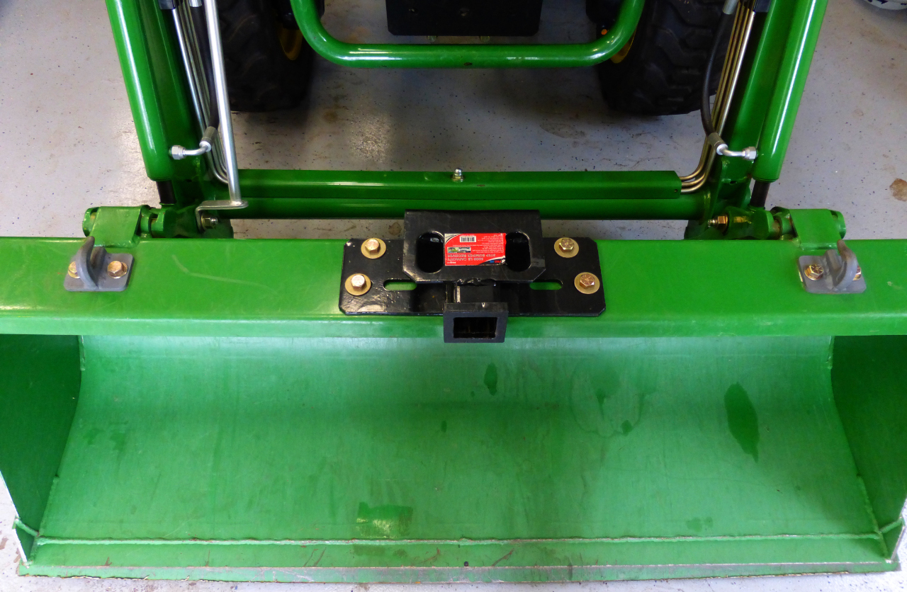

THE GOOD - Winter this year provided near weekly snow falls on the east coast so I had ample time to test out the snow moving capability of the 61 bucket (BW14146) on a 200CX loader mounted to the 2520 tractor. Let's just say this combination worked flawlessly on moderately steep terrain and handled up to 18 of snow with aplomb. Using only float mode, ice could be removed simply by tipping the bucket down to exert additional cutting force on the long asphalt driveway. I was extremely happy with the performance of the loader and tractor as it quickly dispatched the white snowy mess. :D

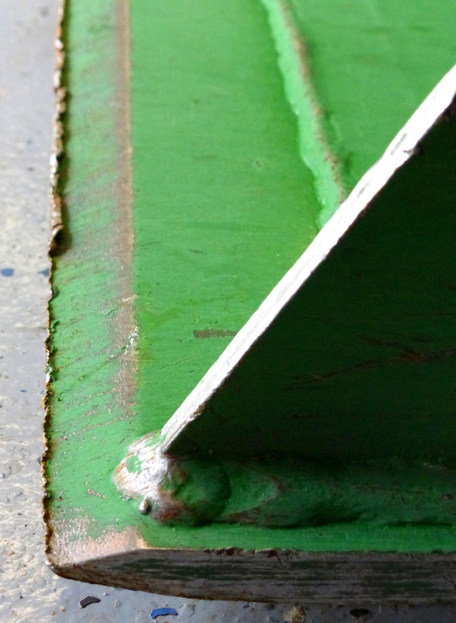

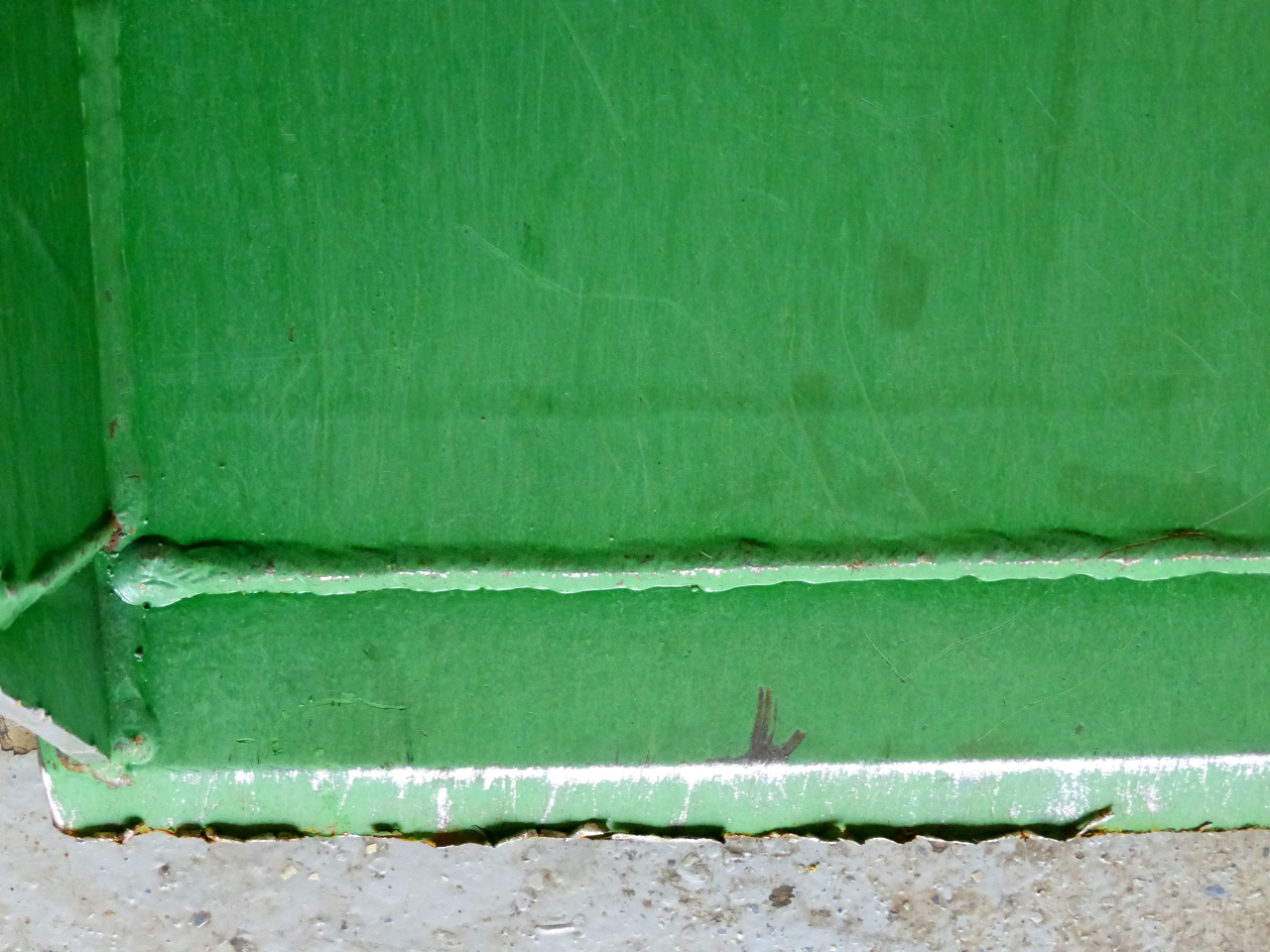

THE BAD - Attached are photos of the bucket's cutting edge after only one season of use since new. Basically the cutting edge is destroyed, since it's no longer straight along the front edge. Nearly セ inch is worn off at the bucket outside edges. Attachments, such a tooth bars, can no longer be affixed with a non-linear cutting edge. I was very surprised about the amount of wear on the cutting edge after only one winter season's use. Not happy. :(
THE UGLY I contacted my local John Deere dealer to inquire about the cost to replace the welded on bucket cutting edge. The estimate was about $600 parts and labor, and the bucket would have a "repaired" look to it when finished. The dealer provided the cost of a new bucket at just a shade over $800. Assuming worst case scenario, aka a heavy snow falls each year; I'll be spending $600 to $825 to move snow annually. There has to be a better way. :eek:
I'm evaluating different options before the next winter season. Below are a few options under consideration.
  • Repair bucket with a factory cutting edge and install a wear bar for snow removal. I believe W.R. Long manufactures a wear bar. $600 plus $300 = $900
  • Remove the damaged cutting edge and replace with a removable cutting edge that can be changed when worn. Cost and availability unknown.
  • Purchase a new bucket and wear bar for snow removal. Sell damaged bucket for few hundred $. $825 plus $300 = $1,125 (less proceeds from old bucket sale).
  • Purchase a new bucket. Sell damaged bucket for a few hundred $. Move to a snow free State currently under consideration. $825 (less proceeds from old bucket sale).
  • Do nothing. Forget about installing a tooth bar or wear bar with the bucket and continue to use it to remove snow on asphalt as usual. When the cutting edge wears back to near the wear plates, maybe 1 to 2 years more of snow removal, then make a decision to repair cutting edge or replace bucket.
If anyone on this board has other recommendations or constructive comments, I'd love the hear them. :anyone:
View attachment 372933View attachment 372934View attachment 372935
A bolt on cutting edge will give you twice the area for wear. You have enough metal there to drill holes for one.
If you do buy a new bucket get the JD 61" Heavy Duty Bucket. It is pre-drilled for the bolt on cutting edge.
Also try to keep the cutting edge flat when using the loader on hard surfaces so the wear is even across the entire width of the bottom of the edge, not just out on the point.

In Northern NJ we had similiar conditions this year with snow. From my past experience in earthworking I always used bolt on wear bars/cutting edges. I had a 4010 with 410 FEL I bought used. I had similiar wear on the bucket when I got it. I removed the bucket, turned upside down and drilled the bucket to install a 1/2 inch thick cutting edge from my local bucket supplier. They have all different sizes and will custom punch anything you need. The new edge was on the tractor for 6 years and showed little wear at all. Its a much better hardened steel designed for earthwork and scraping the ground. The fact that I was able to drill the cutting edge on the bucket ,with a magnetic drill of course, told me the OEM bucket was of softer steel than I was used to in excavating equipment. My new 3320 has the H/D bucket with a bolt on edge and after 389 hours of use its time to turn it around. If you can find some one to help you with a bolt on edge, I think you will be happy with the extra strength and wear you will get out of it. Just my :2cents:

Buckets are made to work mostly with dirt. Anytime you will use something across a hard surface, you will need a hardened replaceable edge. Snow plow blade's? You will see they all have a flippable lower hardened edge. Wears down on one side, flip it, wear down the other side... then replace it.
Because of what has already happened, you will want to see if there is enough edge there for a hardened edge can be bolted on.
