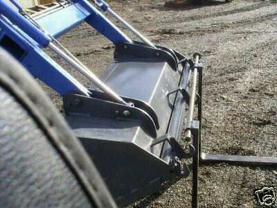

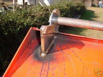

Great idea. I just purchased a b2630 Kubota and will try and make forks also. My thought is to use square tubing instead of round to hang the forks. This should stop the forks from swinging. I may also incorporate a foot on the lower rear edge of the fork to rest on the lower flange of the bucket. They can be adjusted the same way as your design. The only issue may be getting the forks squared up with the loader lip.

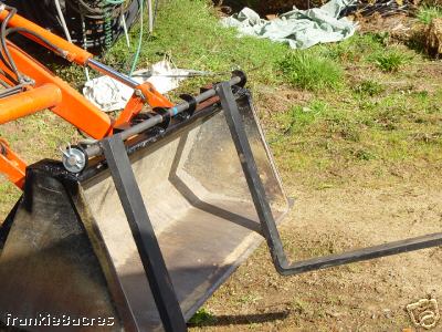

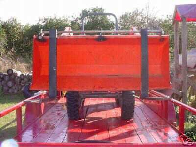

I am getting ready to make a set of forks for my bucket. Has anyone used this design from any Ebay seller? I am not connected or buying for him just interested in the designs.
Cary:cool:

Looks good. I'm going to try to incorporate both ideas. I will use sqaure tubing fixed to the upper lip of the bucket and make it adjustable by sliding the forks sideways like a class 3 receiver hitch. Hope everyone can follow what I'm saying.
