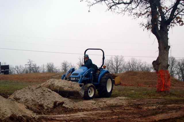

When traveling with a full bucket, keep it low to the ground. There's no need to have it more than about 6" high. Don't raise the bucket until you get to where you want to dump the load, then stop and raise the bucket to dump.
As you travel across rough terrain with a load that may be higher than your hood, keep your hand on the FEL joystick and drop the load to the ground instantly if your tractor becomes unstable.

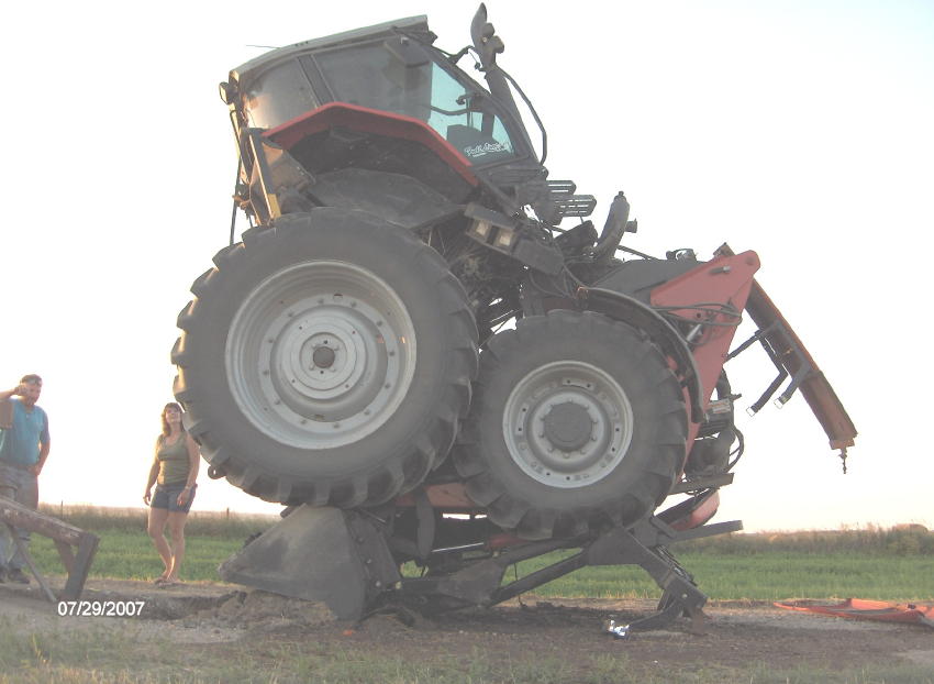

As long as we're giving out safety tips, if/when travelling with your bucket held low, ALWAYS keep the cutting edge curled up so it doesn't bite at unexpected times. :eek:

i have a MX5000 with a LA852 loader and HD bucket. Based on my experience with this unit you will be hard pressed to wear out the bucket in your life time.
When you travel down the road or anyplace at a high rate of speed use the locking lever to ensure you do not end up with the bent up mess pictured above.
