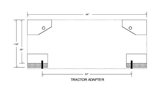

No standards for bucket connection widths. The tractor side of a Quick Attach is 44 inches wide:

If your going to do a skid steer quick attach, I recommend buying that first and then designing the width of the loader to that.
Before you do any metal work, take a few hours and make a loader out of 2x4 wood first. Does not need to be perfect. But good enough to find out all clearances that are needed before you start welding
