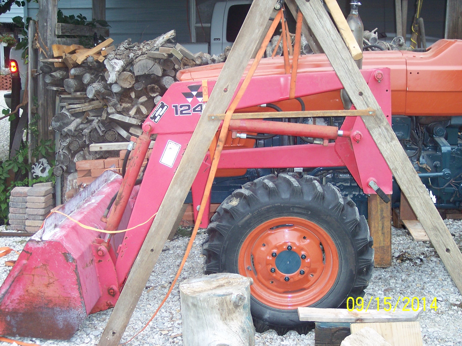

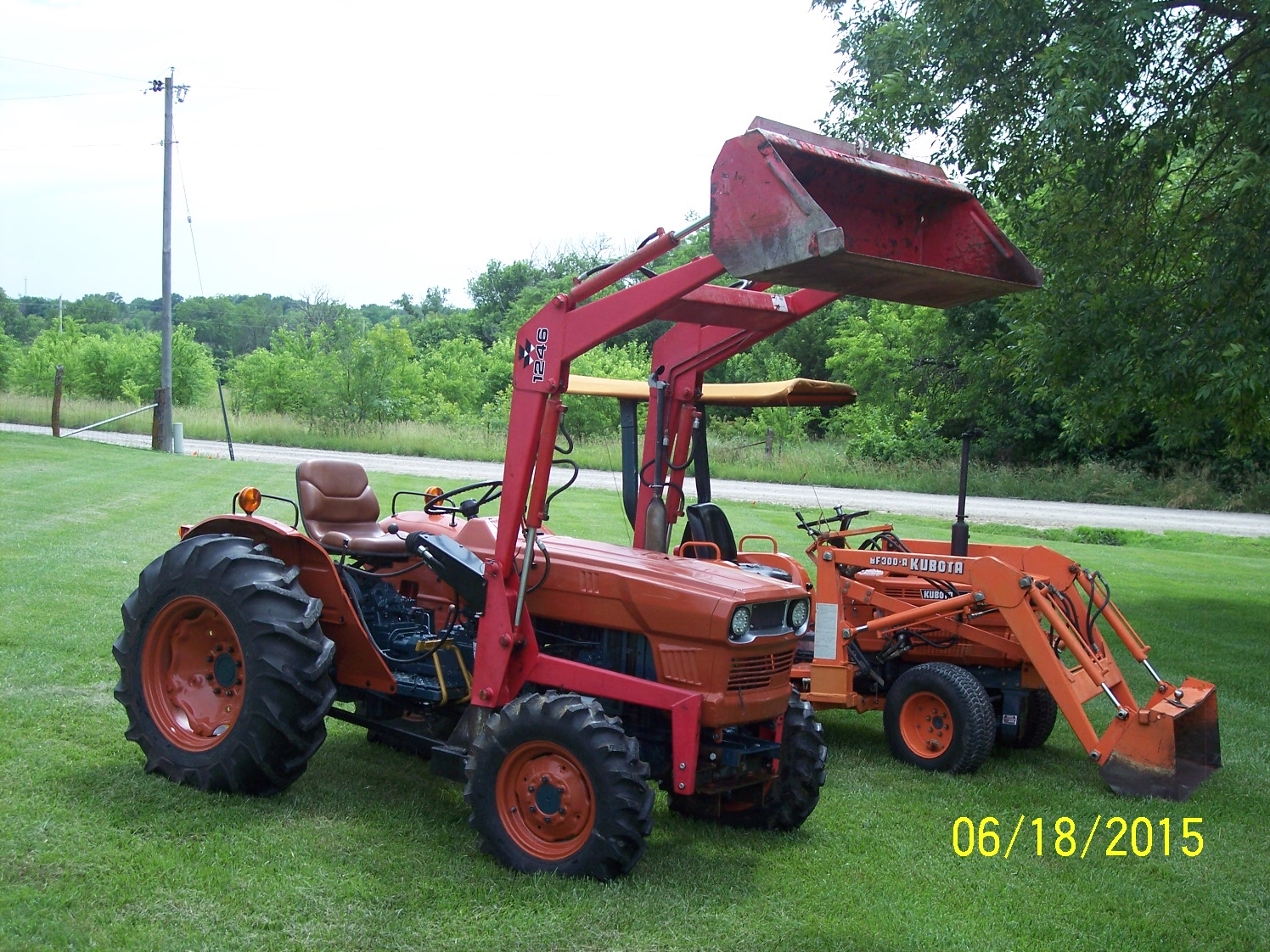

I bought a used loader and lengthened the ams to clear the front of the machine: FEL, TORO Groundsmaster Put Together

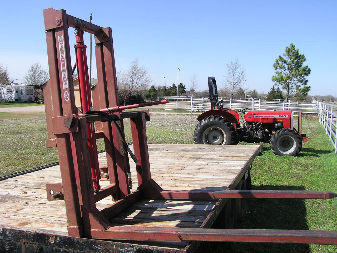

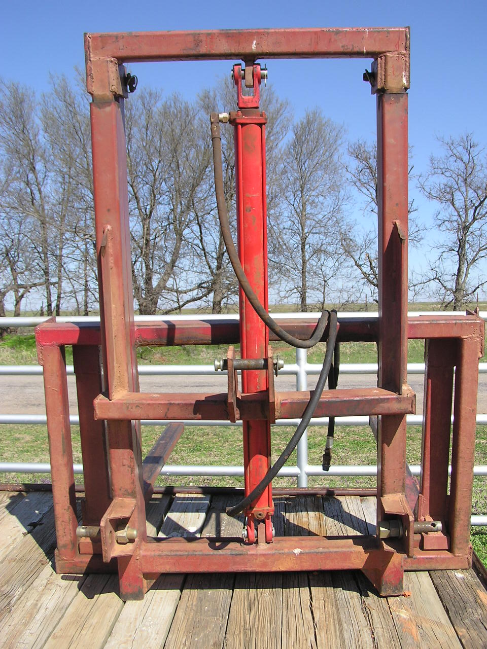

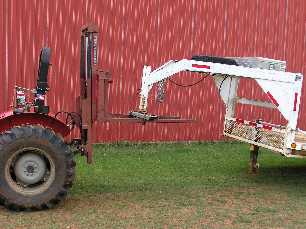

Are you wanting this loader for your MF35?
They make 3 point forklift attachments: 3 point forklift attachment at DuckDuckGo

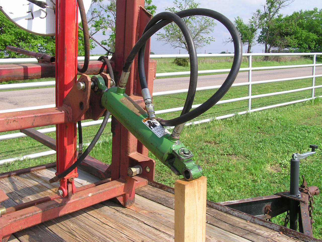

I had one on my MF240D because it didn't have a FEL. A hydraulic toplink is a necessity:
View attachment 589355 View attachment 589356
View attachment 589357 View attachment 589358
I have a hydraulic 3 point hitch top link but how did you feel about the power of the unit? Would it lift 1500 or so? Id much rather find a mid rise trucker mast like that over building a front end loader.
/ FEL build #35
I have a hydraulic 3 point hitch top link but how did you feel about the power of the unit? Would it lift 1500 or so? -------------------------------------------.
Yes, easily but it was Cat 2. The front tires were loaded and extra weight on the brush guard. It would lift the other tire completely off the ground if
the forklift was raised higher:
Removed the driveway with it:

I had one once and a gas engine MF35:
Didn't get a good picture of it until after I traded in on a MF235:
