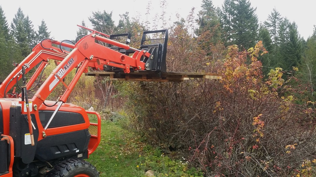

I think it's a good idea and much safer than a lot of options. But there are two important changes I would make:
1. If you are to be standing on this, the low sides and bucket back are a huge hazard. They provide an easy way if anything happens for you to flip over "head first" towards the ground. I would raise those up to railing height, plus they're really easy to trip over.
2. I would use plywood on the 2x4 sides to reinforce them. It doesn't see like racking would be a big deal with the ratchet straps, but it will stiffen them up a ton and prevent any issues from developing.
/ FEL carrie all, and work platform
#24
The low sides have been mentioned, and I will likely make some removable extensions that I can lock in place when I need them for safety sake. This is already what I'm going to do with the back panel (by the bucket).
The plywood idea is good. I don't think they need the extra stiffness, but it wouldn't hurt. My main challenges with this build is trying to keep it lite enough for one person to be able to get it in and out of the bucket (it is a REALLY tight fit). And being able to still see while transporting it or stuff with it, thus my intention to make all of the other parts removable.

Finally work and weather have permitted me to make some progress.
I had just enough screws yesterday to get this far.
#34
Today I picked up more screws and did this...
I have a what I think is a pretty simple and easy way to lock it in place when I need the back and pull it out easily when I don't.
#36
I will likely build at least one of the side extensions first to see how I will lock it in place and make sure my current idea will work.
#37
I made a little progress the other day. I finally decided on a method to anchor the back panel and it's working really well.
Both of these two methods work great to keep it locked down. Certainly the bolt and nut combo leaves no wiggle room, but I haven't had any wiggle either way.
No movement here either. It locks in quickly and comes out quickly.

#38
This isn't the first time I've used it, just the first picture. It's been very handy moving a number of loads of scrap(metal), trash, as well as loads of wood, and brush to the burn pile. I have also used it to reach a sliding barn door track that was falling apart. This door was locked, blocked, and unassailable from inside the barn and had been for a decade or two at least.
