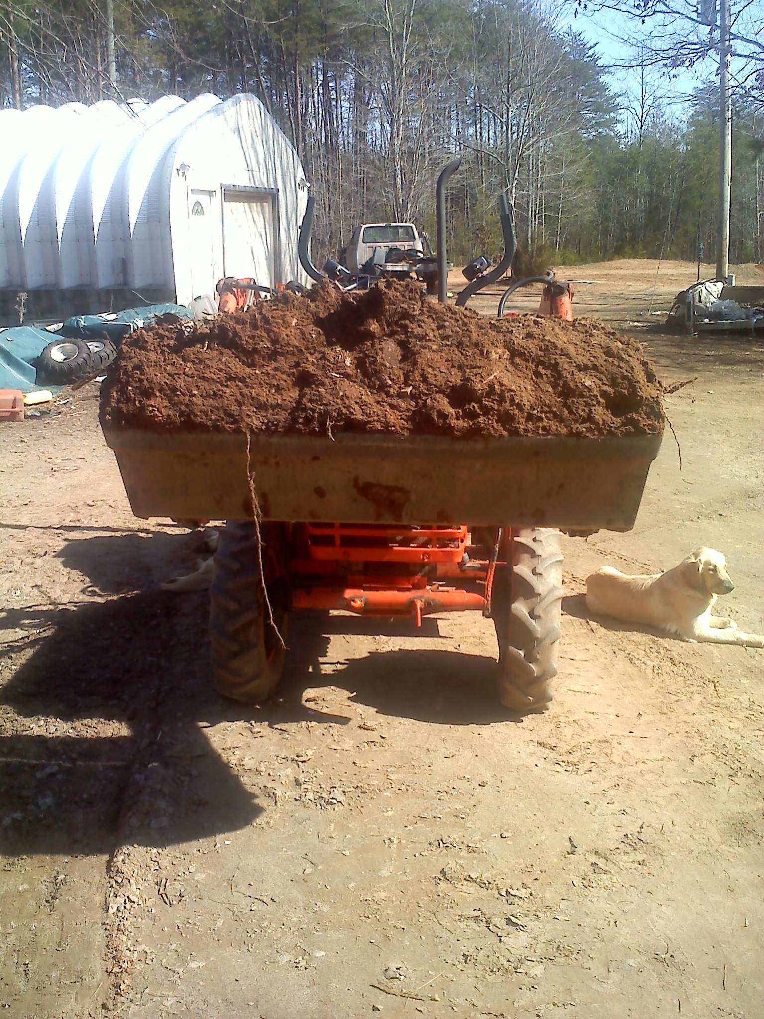

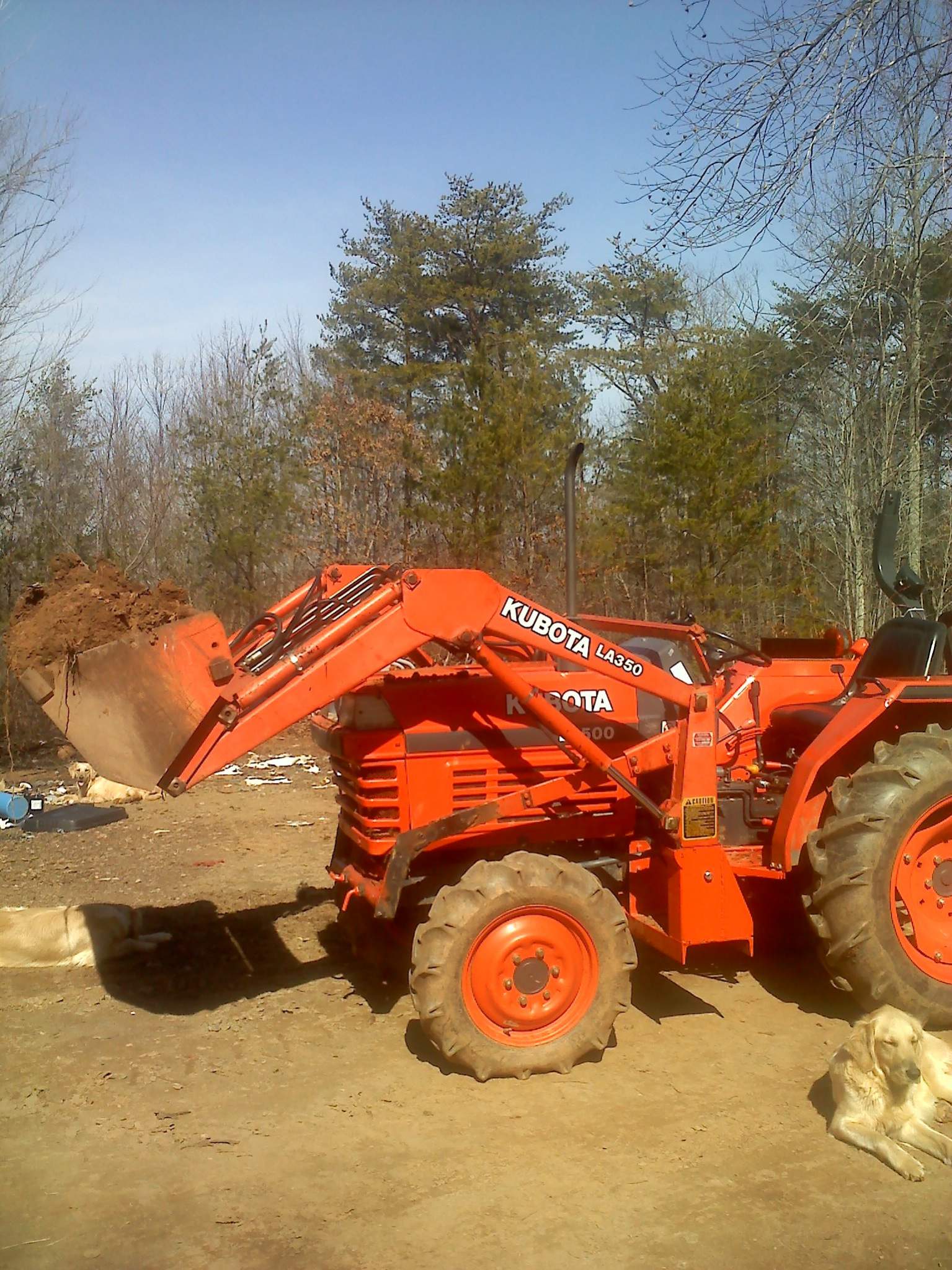

hello again here is few pics of what my son and I did and this is with bubbles in the hydraulic system??
Hope the pics worked
Thanks Carl[/ATTACH][/ATTACH]
