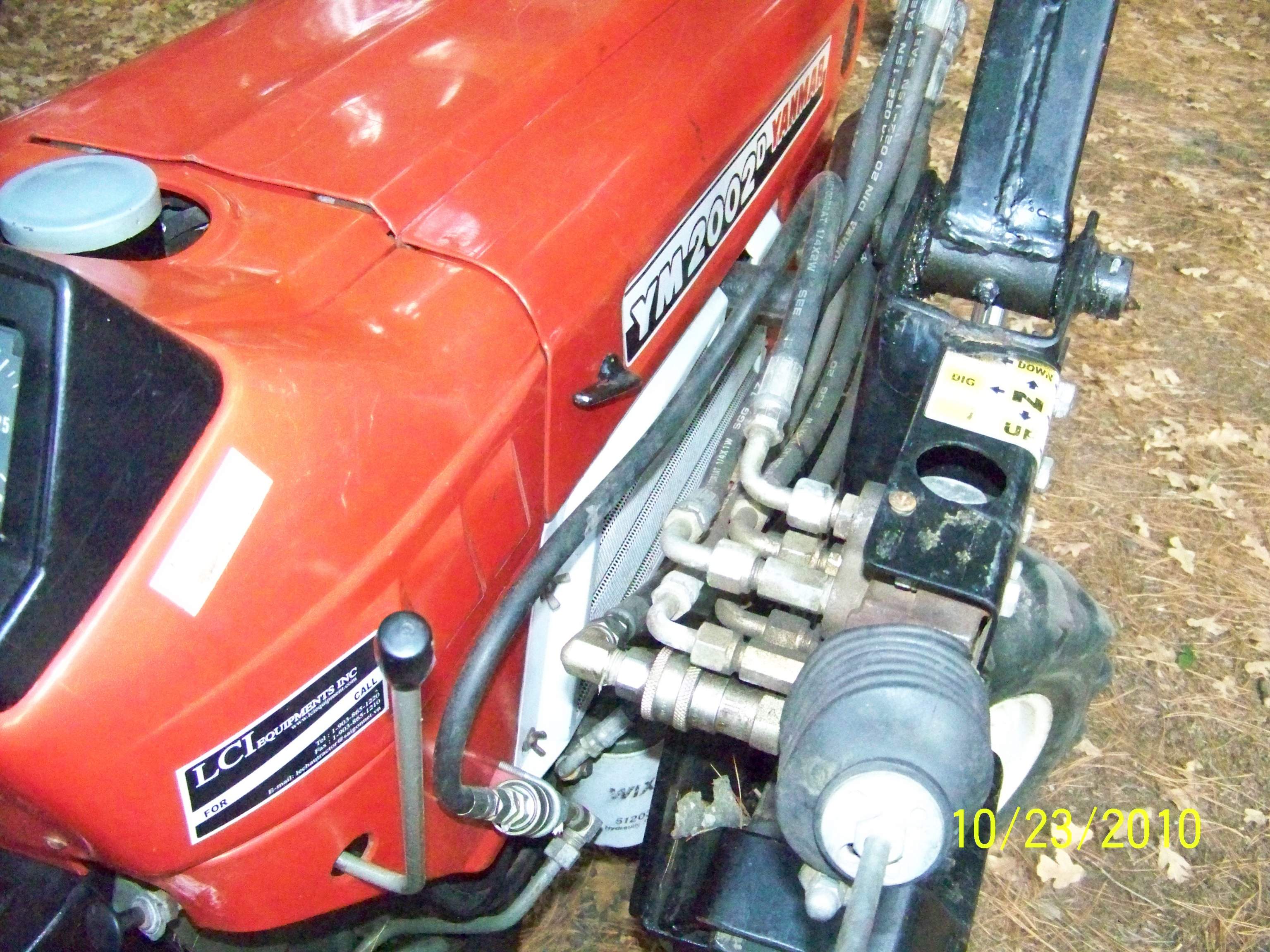

   / FEL control valve on YM1900 #22
Here are some pictures. Not very good and as I stated, this installation is not all that neat. Might give you an idea or two anyway. Good luck to you.:thumbsup:

Thanks for the photos, they showed me some things I did wrong. I should have mounted the loader valve sideways like yours. Would have made putting the hoses on a lot easier. I will use them for reference this winter when I change the routing to a simpler and cleaner run. I can see also that I should have ordered 90 degree fittings for the pump lines. Maybe I can find them locally.

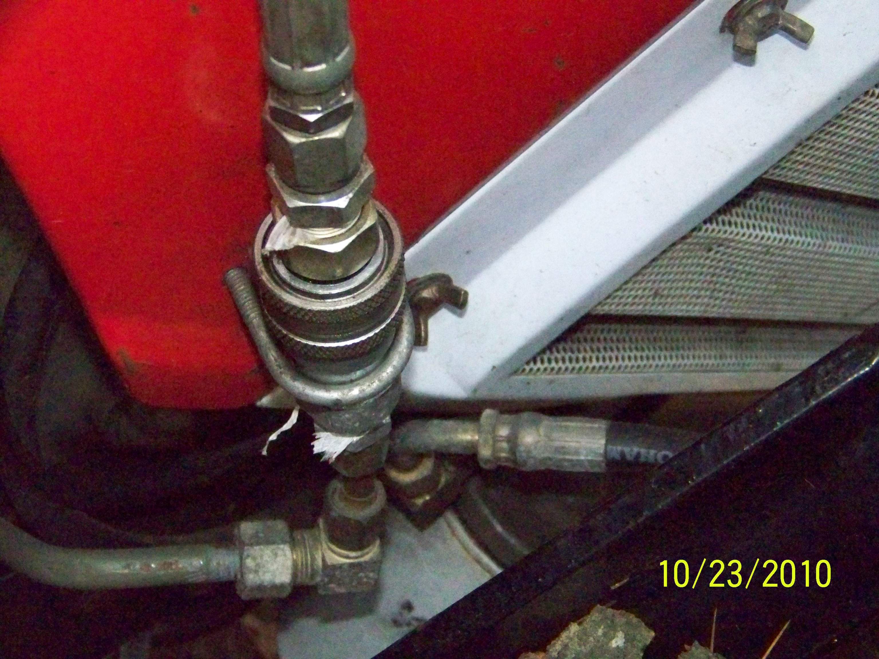

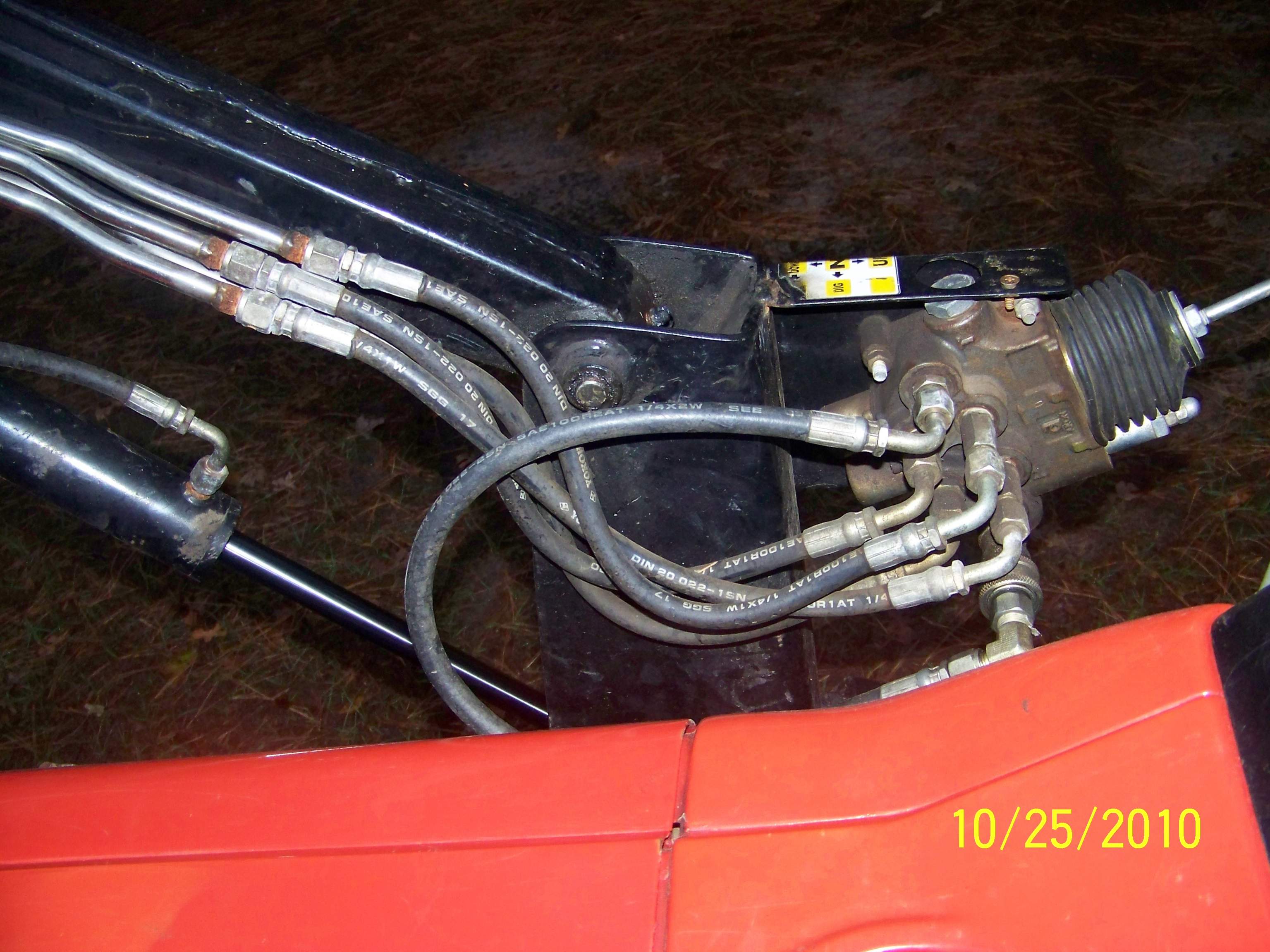

Gary, here is the way Buhler rout their lines
#25
Thanks for the photos. Between yours and Winston1's I have some ideas on how to get these lines finished. I see the loader valve is mounted horizontal. I probably should have done that instead of the 50 degree angle mine is set at. Would have made the hose bend radius work with shorter hoses.
I also like the line clamps they use. I've got some thin material that I think I can bend to the same shape. After wasting about 12' of steel line, I think I finally got the tubing bender figured out. When I get ready this winter to replace them, I'll have the lines and hoses made locally for me with different ends than what I'm using right now to clean it up.
The lines and hoses were the one thing I never gave much thought to when I decided to build the loader. Big mistake!

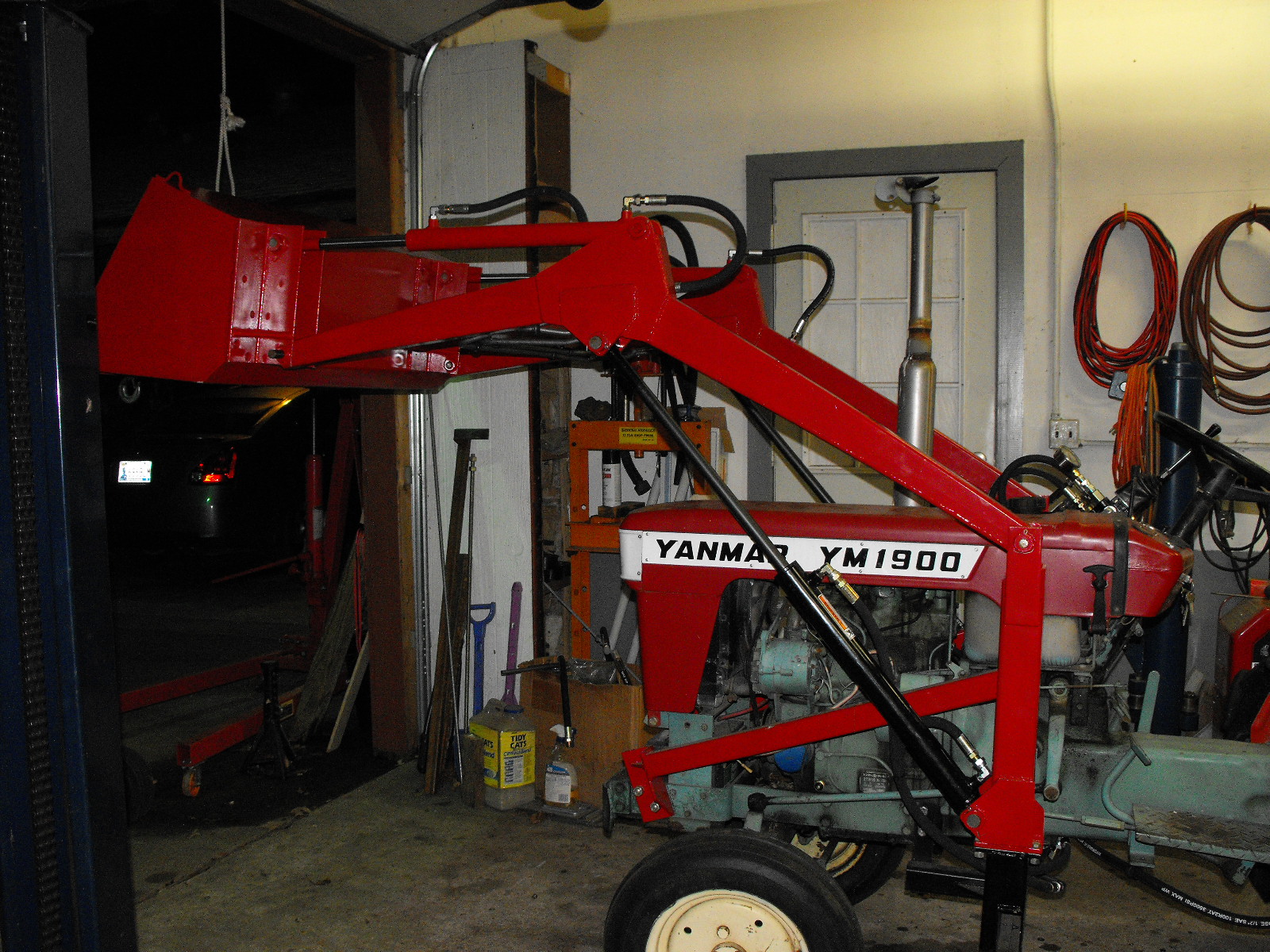

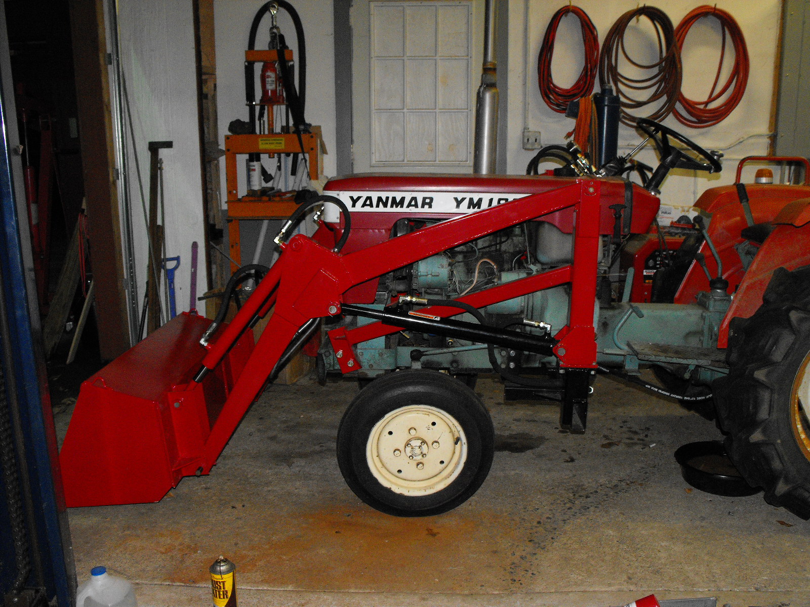

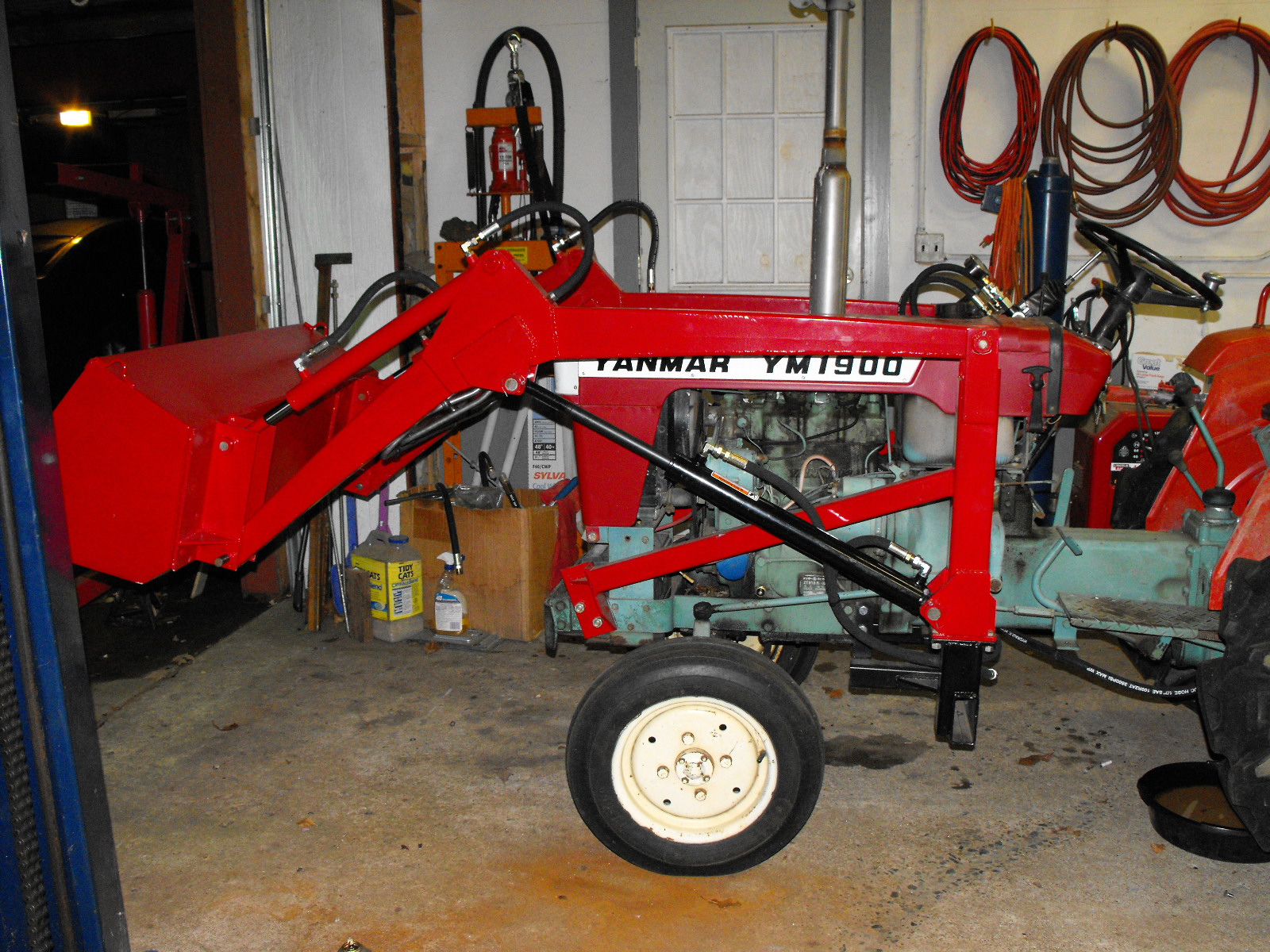

#28

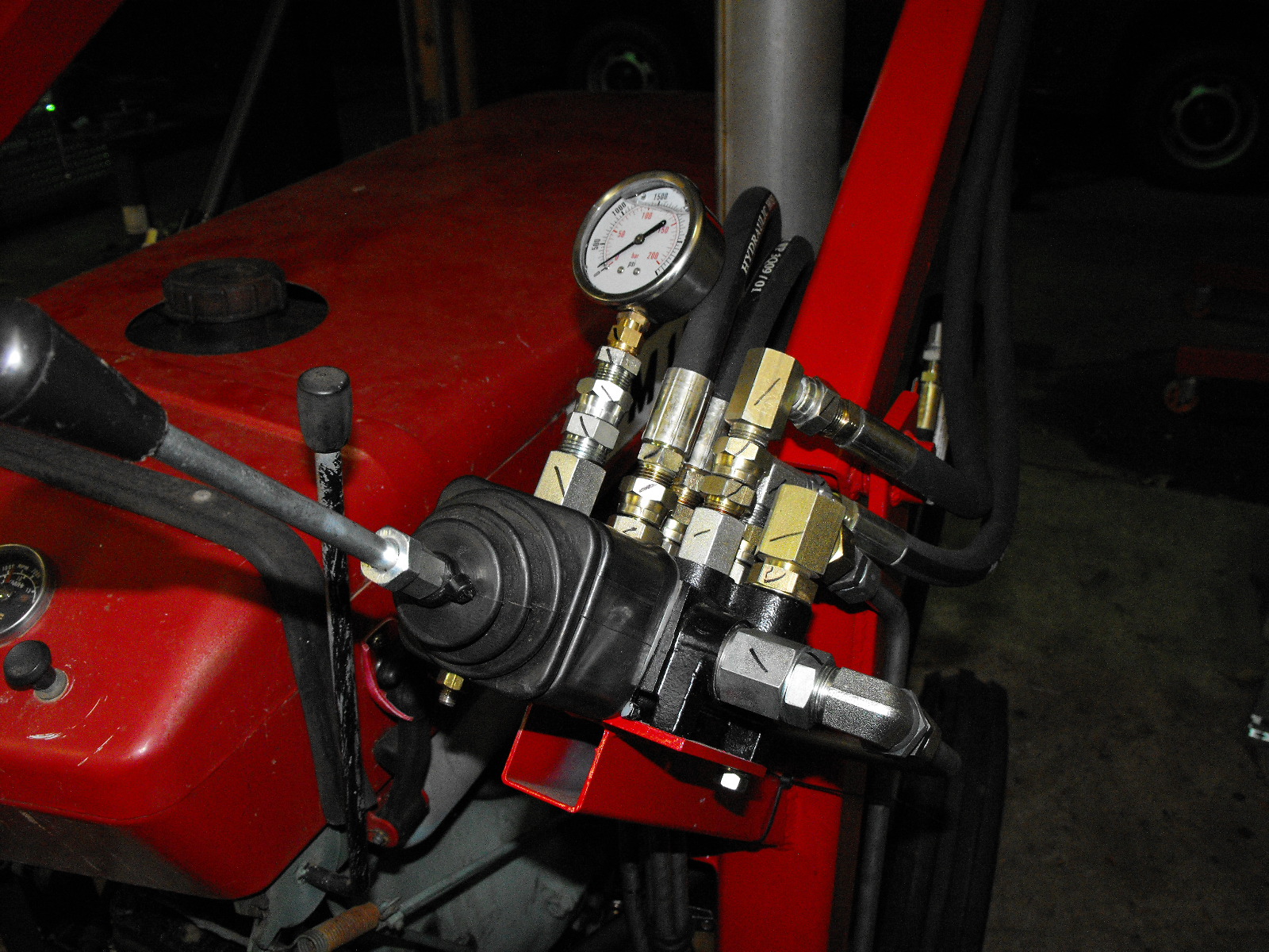

Here are some pics of the finished loader. Keep in mind this is my first (and last) attempt at building a loader. I plan on reworking the lines and hoses this winter but first I wanted to play with it to see what breaks or isn't right. I still have to machine the bucket pins for it to be complete.
I do have a question about the working pressure. The relief doesn't kick in until 2,200 lbs on the gauge. Since this loader isn't going to be used for heavy work, should I lower the pressure down on the loader valve and would there be any benefit? Don't have any leaks yet but it seems high for what I will be needing it for. I just stuck the gauge on it while I'm testing it. I really like the joystick valve. Very smooth and you can move the loader and bucket extremely slow if you want.

Never put a gauge on my loader relief valve but I have on my 2002d 3 point relief valve. Relief valve goes off on it at about 2100#. I would imagine your 1900 is pretty close to that. I wouldn't think your loader relief valve should be any higher than your 3 point relief valve. If you have a repair manual that setting is probably in it. Loader looks good!
