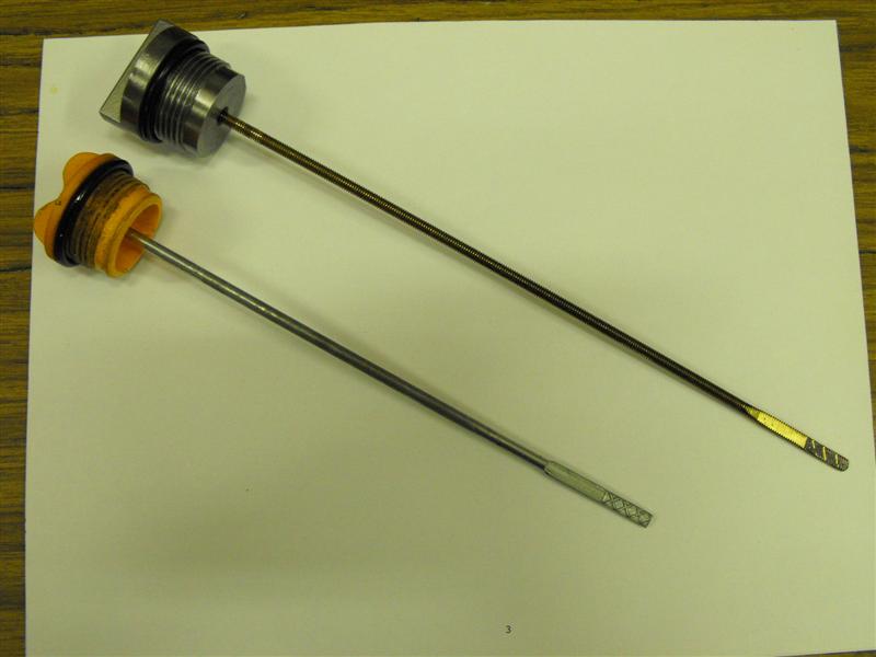

Finally found something to make the extended dipstick with. I settled on a piece of 8-32 brass all thread. Drilled and threaded the cap and used Vibra-TITE to lock it in. At least if it falls in the tranny, the gears should have no problem chewing up the brass:licking:

In regards to the transmission dipstick, I have a question:
Do you screw the dipstick all the way in or just set it on top of the hole to check the level? I ask this because it makes a difference of 1/2" on the stick. I can't find any reference to this in my service manual and I did search a bunch of posts but didn't find anyone asking about it. I never thought to check this in the past as I just put in the 4 gallons and left it at that.:ashamed:
Now that I have added the loader and made the longer dipstick I don't know which reading is correct and I would rather not have to take the lines off and put the original dipstick back in just to find out.
Do you screw the dipstick all the way in or just set it on top of the hole to check the level? .
Gary, I've read that if the dipstick is the threaded type it should be removed and wipe the stick and then set it back in on top of the hole ( do not thread back in ) to get an accurate reading, although if it is a push in type stick then it should be pushed all the way in for the correct reading,;)

Thanks guys. I just never thought about how to check it. I always change the tranny oil every year and just pored in the 4 gallons as it was always the same amount when I drained it. The oil is always a tan color when I change it and assumed it was getting condensation in the the case from being hot and cold.
