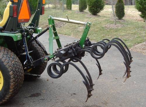

Here's what I'm leaving on the 3 pt for snow and other FEL work.
Have a little trouble with the tines gouging dirt or pavement if I go up a slope or into a dip though. Was thinking maybe something just attached to the drawbar similar to what you came up with.
Get some of that Rust Reformer (Rustoleum brand) or Rust Extender (NAPA brand) and put a couple coats on that metal to inert it and turn it black. This is what I used on the soil ripper.
Ralph

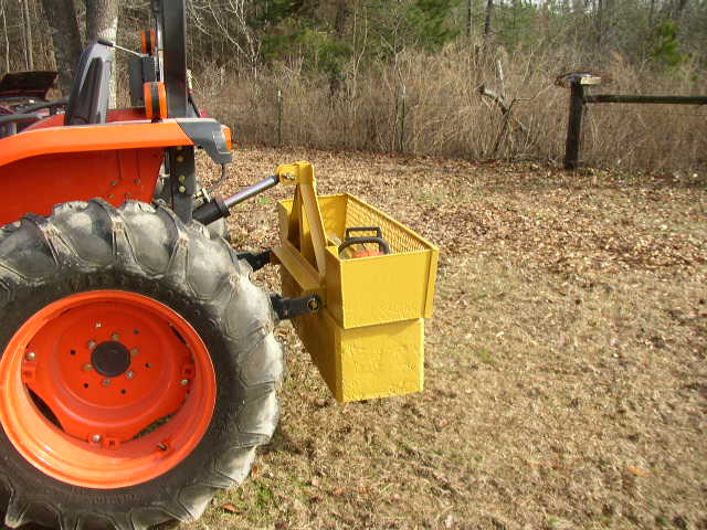

   / FEL CounterWeight On 3 Pt. Hitch #18
This is one I builded, at around 700# it's no problem with bouncing or anything like that. It feels like it adds more hp and it really makes a difference.. /forums/images/graemlins/smile.gif

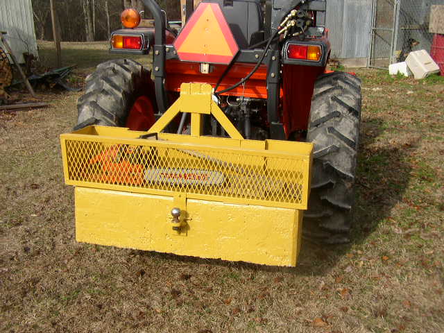

   / FEL CounterWeight On 3 Pt. Hitch #19
another shot
   / FEL CounterWeight On 3 Pt. Hitch #20
Now that's a very nice setup with a toolbox for the chainsaw and other acc. Nice job. Now I know what I need next. I'm tired of dumping my tools from the bucket by accident.
