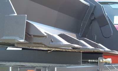

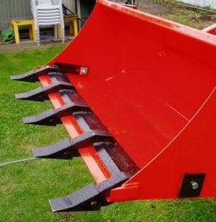

   / FEL Cutting edge - direction? #6
Just some pictures for clarification. Bevel on top
