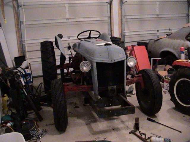

If I was you, I would pass on the loader. My 8N has [well, realy had] a front plow on it. It was a real BEAR to steer, and had no traction on the rear tires. Well after getting stuck for the 5th time last weekend, I popped the blade off. OMG it is a whole new tractor!! Steers great, fun to use, great traction. So I spent most of the week removing the whole plow assambly. Best mod I ever did. All I have left on now, it the front pump drive shaft,[have not figured out how it ccomes off yet] and the under carrage frame. So my input... Enjoy the tractor, don;t put a FEL on it.

There is a power steering kit that you can add to that model if you ever feel the need to put a FEL on it again. I don't know right now where to direct you but they are out there.

</font><font color="blue" class="small">( It was a real BEAR to steer, and had no traction on the rear tires. )</font>
you are right there, that is the main reason i stepped up to 4wd and p/s and hydro. my old arms, and legs could not take it anymore. some weight on the back helped with the traction , but not much. nice tractor tho.
