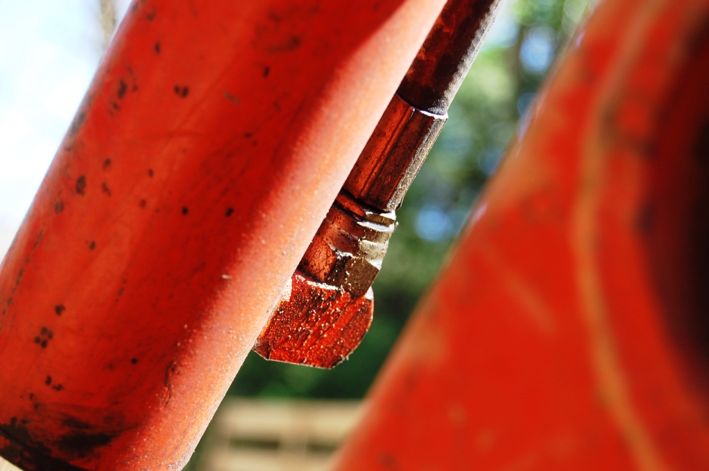

This is my first post but I've been researching on here for a while. I'm trying out a Kubota M5030SU with M1000 FEL. The lift on the FEL is leaking down kind of fast, even when its running. I raised it and measured last night and then disconnected the lines on the lift and it didn't drop any. The tilt on the bucket doesn't seem to be losing any pressure either. I lowered the bucket down and tilted it up putting pressure on the bucket, left it for several hours and hadn't moved any. I believe I've narrowed it down to the valve on the lift side. I don't really know where to go from here, or what to expect on a repair cost?
Another question, is there any reason that I couldn't switch the lines from the lift and tilt? I don't have any experience with hydraulic repair.

Just because you disconnected the lift lines form the valve and had no leak down does not mean a cylinder is not by-passing. If a cylinder packing is bad, it will leak equal pressure to both sides of the rod and base end having more surface will try to push up so loader won't drift if oil can't get away. There a couple of ways to test the cylinder:
Swap hoses from lift to tilt spool and try it. If it still leaks it is likely a cylinder packing.
Or raise lift part way (only a small ways off the ground), shut everything off, & disconnet QD from the valve then loosen a hose at the rod end of the lift. If it drifts and oil comes out the fitting 1 or both of the cylinders are leaking. Be very careful doing this. Put a rag over the fittings as you loosen it, if a bad leak it could drop quickly.

I found a line leaking on the tilt, Switched the lines between the tilt and lift at the quick disconnect and it is leaking down just the same as before.
