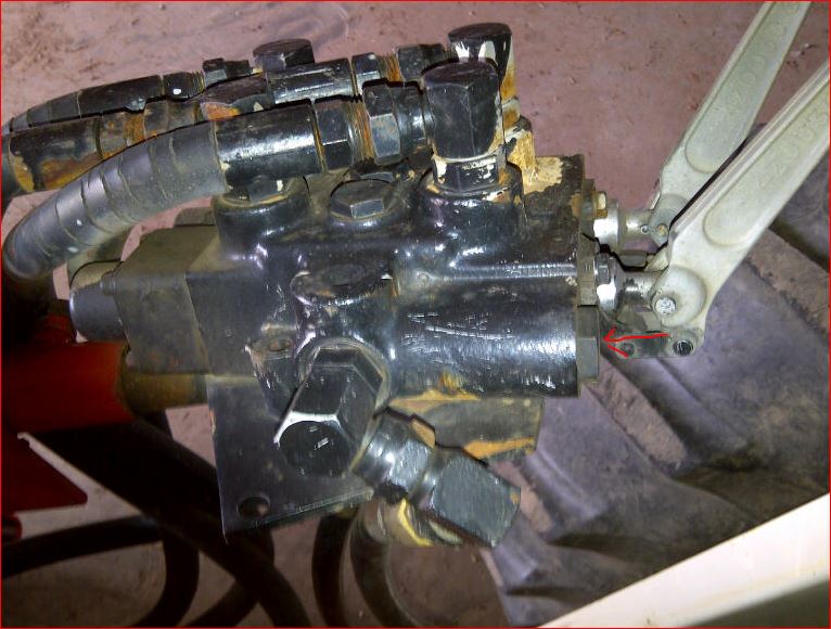

I'd start by locating the hydraulic filter you mentioned, and removing it and draining it into a clean container to see what comes out. Then replace it with a hydraulic, not an oil filter.
Also clean the valve assembly with a brush and degreaser, then air dry. The round protruding cap with 4 allen screws, just above question #5 is one of your spring loaded valve assemblies; which when carefully removed you can then inspect and clean, and see if there is any particulate matter possibly causing it to stick open. I'd take more pics and label each hyd hose as to exactly where it goes for re-assembly.
Chances are your valve body has been failing until it just gave up from worn parts/O-rings, or contamination, or both. Even if you don't figure out the exact valve mfg. you should be able to replace it, IF needed with a generic one from one of the online surplus hydraulic sellers.
Others like J_J can probably advise further on where to go, what to do....
Cleaning the filter and the valve assemblies makes sense, and is a low cost way to start. Certainly better than replacing the whole thing. Thanks.

Zing,
I did some looking at the Case IH parts and your tractor could have a single pump or double pump both are gear pumps. They also list what is called a "combining valve". I am not sure what function this valve performs. Also showed a filter mounted on the side of the transmission housing. parts view did not state which way was the front of the tractor but I suspect the filter is on the right side but could be 100% wrong.
Do you have a service manual that would show the hydraulic schematic. It would help reduce some of the guessing as to what the problem(s) could be.

#13
Take the plug out where I drew the red arrow. If the valve has it's own relief it would be under that plug. Relief stuck open would give the symptom described if the valve is not plumbed in Open Center series. With only 2 hoses going to tractor, it may not be is series with the 3pt system.
Thanks for taking the time to edit and repost the picture, that makes it perfectly clear what you are talking about. As per the suggestions the others have made, cleaning out the valve is a good place to start, so I will be sure to pull that plug and clean out any crud in there that might be sticking the relief open.
I don't know what Open Center series means or how to make sure it is in series with the 3 pt. There is a switch that is near the spot where the two supply hoses come out from under the seat. I thought it was designed to ensure the flow ran in the right direction for the implement to function properly, but perhaps it is used to ensure that externally connected hydraulics run in sync with the 3 pt then?

#15
ydraulics:
Type: open center
Pressure: 2550 psi [175.8 bar]
Valves: 1 to 3
Total flow: 7.7 gpm [29.1 lpm]
15.3 gpm [57.9 lpm] (tandem)
Steering flow: 7.7 gpm [29.1 lpm]
Steering press.: 1500 psi [103.4 bar]
Install a 3000 psi pressure gage and check the pressure.
So you are saying that the 3pt works and the loader does not work.
Does that include both lift and curl.
There is one problem that I can think of that will allow the 3pt to work and the lift will not, and that is the nut that secures the cyl piston. If that nut comes off, the fluid will just recirculate through the cyl and no action will occur.
If you install the gage in a tee in the IN port of the FEL valve, you can see any pressure developed by any component in the hyd system. , and then, if you raise the 3pt to max, and you show about 2500 psi, then you know the pump is working good.
The loader valve can have several problems.
Is the FEL valve lever operated or cable operated?
You mentioned the hex plugs between the work ports. Those are load check valves, and they can fail, so check them out before tearing the valve.
The relief valve can be stuck open as someone mentioned, and fluid will pass on to tank.
The relief valve is the large tall hex capped relief valve close by the IN port or the valve.
Remove t and inspect, clean or repair or replace.
You will need to reset the FEL relief to about 2550 psi
Not all valves have o-rings that you can replace. Those o-rings are primarily there to keep dirt out, and they are not high pressure seals. If you don't have external leaks, don't mess with them.
Do the simple test first before messing with the valve.
Your valve is not stuck in the float position is it.
Is your spool moving in and out the valve equally. The float position will have a little more travel than the retract.
Holy cow J J, that is a lot of information and a lot of it is going over my head, but I will do my best to respond to your questions.
- Yes, the 3pt works but the loader does not lift or curl. Nothing from FEL is working, but there is no apparent strain on the system, no leaks anywhere. It worked fine to lift the bucket when I started the tractor, but then when I got to the field and tried to raise it higher nothing would raise anymore.
- "the nut that secures the cyl piston" I don't know what you mean here. Are you talking about a nut on one of the hydraulic cylinders for the FEL? Is there a cylinder piston somewhere else? I would check this, but I have no idea what you mean.
- "Is the FEL valve lever operated or cable operated?" THere are two levers on the FEL valve. One raises and lowers the loader arms, and the other raises and dumps the bucket.
- Load check valves are under those hex plugs that I thought nmight be to bleed the system. Got. I will check those for crud when I clean out the rest of the valve.
- Relief valve will be cleaned as per both your and ssdoxie's suggestions. I don't know how to set the relief to about 2550 psi, but hopefully that will be apparent when I take it out. Are there markings on it that indicate the psi?
- There are no external leaks, so maybe the o-rings are fine then. Hopefully a cleanup will do the job.
- Not sure what you mean by the float position, but both of the levers are moving in and out of the valve and do not seem any different from how they were in the past.
I do not have a pressure test guage nor do I know anyone who might have one to lend me. I am at least an hour from the nearest hydraulic supply store, so I think my best way to start is to clean out all of the stuff you guys have recommended. If that doesn't work I will look into renting a pressure guage and do as you suggested to confirm if the pump is working properly.
Thank you for the detailed response, much appreciated.

Check the suction screen if it has one. Change the filter and you really need to change the fluid. But first of all take your quick disconnects a part and reinstall. They may look seated but may not be. If not they can flow some fluid or none
I don't know what the suction screen is, is that a part of the filter? I will clean the filter, but fluid is quite fresh due to a recently plugged leak at the PTO.
The only quick connects I have noticed on this tractor are behind the seat, there are ports to plug in something with hydraulics on the rear. I don't have anything on there though, and never have. I will take a look tomorrow to confirm, but I think all other hydraulic connections are screw in. Cheers.

Since I can only see six hoses and it appears that the port labeled byd in one of the pictures is not used it would indicate that this valve is not connected in series or possibly not connected properly in series.
Zing, if you hold the lever to raise the loader and then try and raise the 3pt, will the 3pt work with a load on it?
If yes: This would indicate the 3pt running off of separate pump from FEL but not sure how they are plumbed.
If no: This would indicate both the FEL & 3 pt are on the same pump and would indicate a problem in the loader circuit. Should also eliminate a relief problem in the FEL valve since the 3 pt is down stream and it works when the FEL valve is in center position.
It used to work, so I would think that it should be connected properly, but I will definitely try to do that thing with the valve open and lift a load on the PTO over the next few days and see what happens.

Esay way to do this. Mark your hoses with masking tape and a number. Disconnect the hoses and take the valve back home with you. Go to a hyd. shop. Tell them what it came off of and they will tear it apart and fix it. Or test it first on the tractor and make sure you have pressure getting to the valve. Mine is 34 years old and the float is gone ,but it still gets used a couple of times a day. I will rember your post as I drive backwards to the shed. Goodluck.
