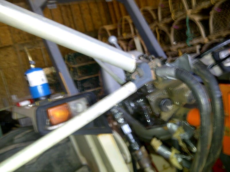

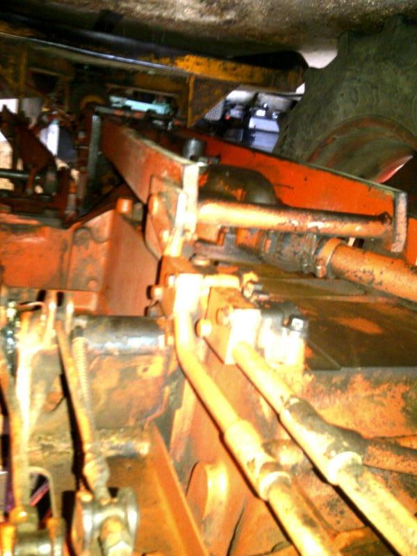

I did some looking at the hydraulics. Up front I have a hydraulic pump that is belt driven off the same belt as the alternator runs on.
Fluid supply comes from the center bottom of tractor and enters pump on the right hand side.
Fluid exits on pump's left and heads to rear of tractor. Splits about halfway back and goes under the axle on both sides of the tractor.

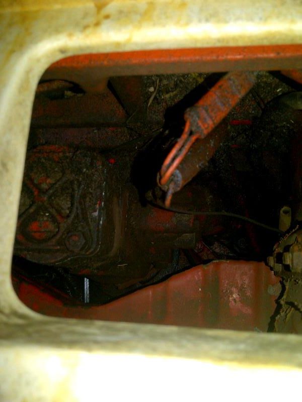

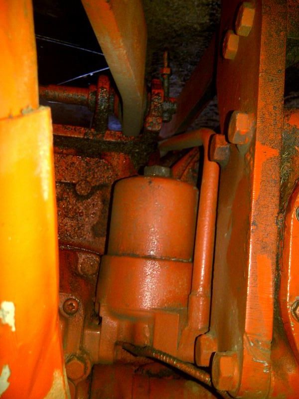

The left rear lines feed my rear hydraulics, which I have never used. The right rear lines go to the area that my loader supply hoses come from, but I can't see much because it is all covered by a casing. They also feed this big canister, which I guess is my hydraulic filter. Can anyone confirm this is the hyd filter? Is servicing it just a matter of undoing the screw at the bottom and then change a paper filter?

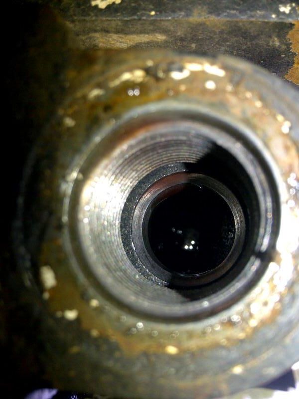

I also spent some time with the loader valve. Couldn't do much with the hoses connected because they were in the way so I started with removing the 4 hoses that go to the FEL cylinders. Holy Hannah, they were tight! Could not move them until I used a pair of 3 foot cheaters to get some extra leverage. I felt like the janitor on the last day of school with those giant bolt cutters removing all of the locks left on the lockers.

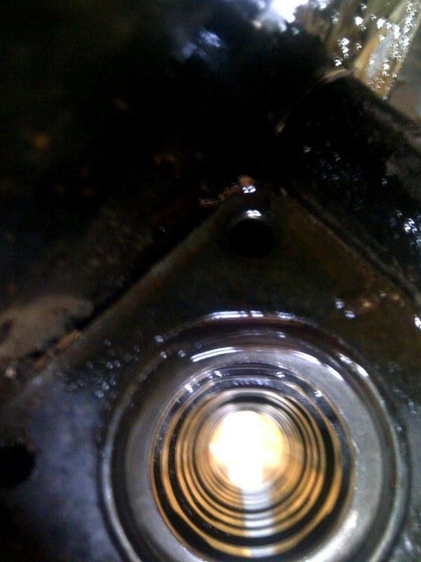

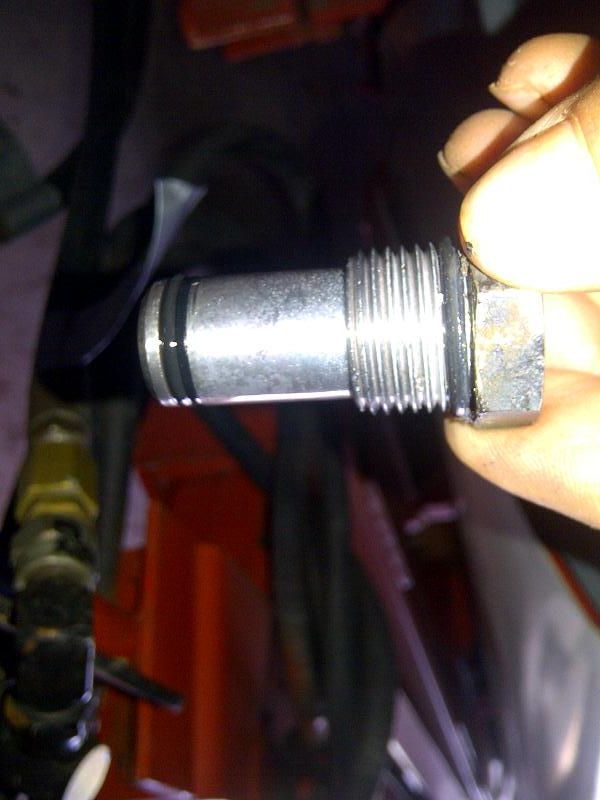

The first thing I tried was the relief. It came out easy. The o-rings looked fine, but other than that I had no idea what I should be looking for. It is just a post the goes into a hole. Nothing noteable about it or the hole. Is there something that I should be looking for there?

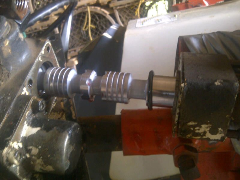

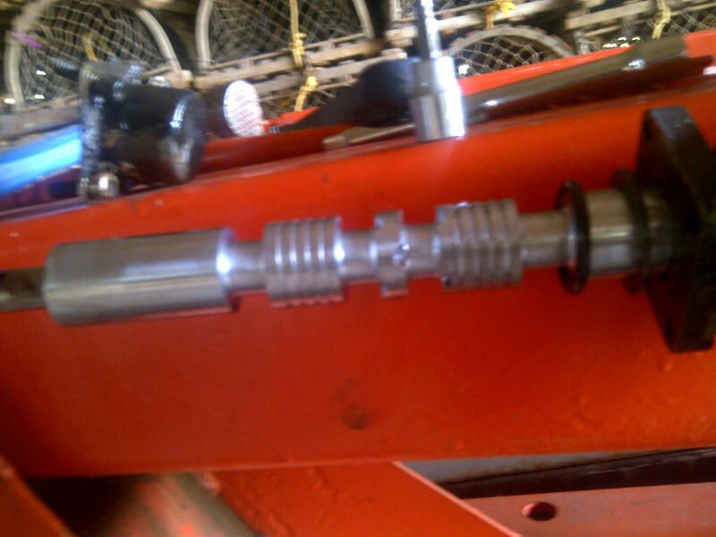

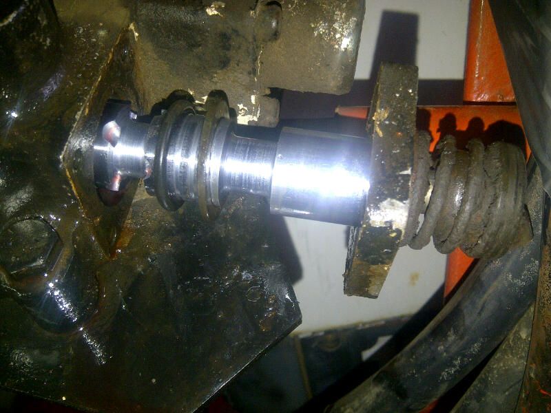

Next was the spring assembly and valve body. The spring assemblies were both loaded with crud, but that was separate from the internal workings of the valve and the action of the levers were both fine even with the crud in the spring. I don't have a clean workspace in my equipment shed, so I left it as it is and will probably take the whole valve to the city and clean those up where I have a suitable work area.
The valve internals seemed clean and the o-rings were fine. I pulled both shafts out, and inspected them and their housing and saw nothing that looked bad. I don't know what I should be looking for though, so it is entirely possible that there was something that I missed. Anything in particular that I should look for when I pull this apart the next time?

That relief valve plug is just a stem block, there is another relief somewhere between pump and the control valve. Only inspection of the plug/stem is to see if the slightly tapered end is fitting tight to the seat in the valve and the smaller O-ring is not torn or pitted.
It's not real clear in the pictures; I see 2 steel lines coming off 1 side of the pump, is there another line on the opposite side of the pump. If so the 2 lines on the same side would be 2 outlets, meaning it is a tandem (2 section) pump. Quite possibly 1 section for 3 pt. the other for loader and/or rear remote since you mentioned a "switch" or lever close to where the loader valve lines come out of the tractor.
I am quite sure the two steel lines are outlets, and that the inlet is the thicker line on the other side. I will look tomorrow and get a better confirmation though. With a two section pump, is it possible that one section has failed and the other section still works? Just guessing, but if it is the pump and I have to replace it I would bet that a two section pump will be more expensive than a single section one.

I suspect the front belt driven pump is for your power steering.
Yes that appears to be the filter housing. Unscrewing the bowl will provide access to the filter element.
Rear two section pump: pretty rare for one section to totally fail and the other still work fine especially when from your piping description the front pump feeds the FEL & the rear feeds the 3PH.

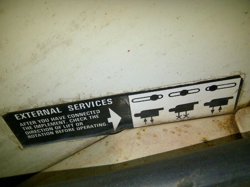

Problem solved, and I am embarassed to say what it was but you guys were great about helping me and so I owe it to you to spill the beans. Besides, it might help someone else someday with the same issue. The problem was a lever with this sticker beside it that I had never paid any attention to before this issue appeared. Picture below.
When the issue appeared I moved the lever to the front and to the back and tested, but I guess I must have neglected to test it with the lever in the middle. I don't understand why the middle position would be required to make the FEL work, since the middle position seems to indicate that the external hydraulics are off (judging by the two X's). I still haven't gotten my tractor manual back from my friend, but when I do I will be reading more about this switch and what it is for. :eek:
