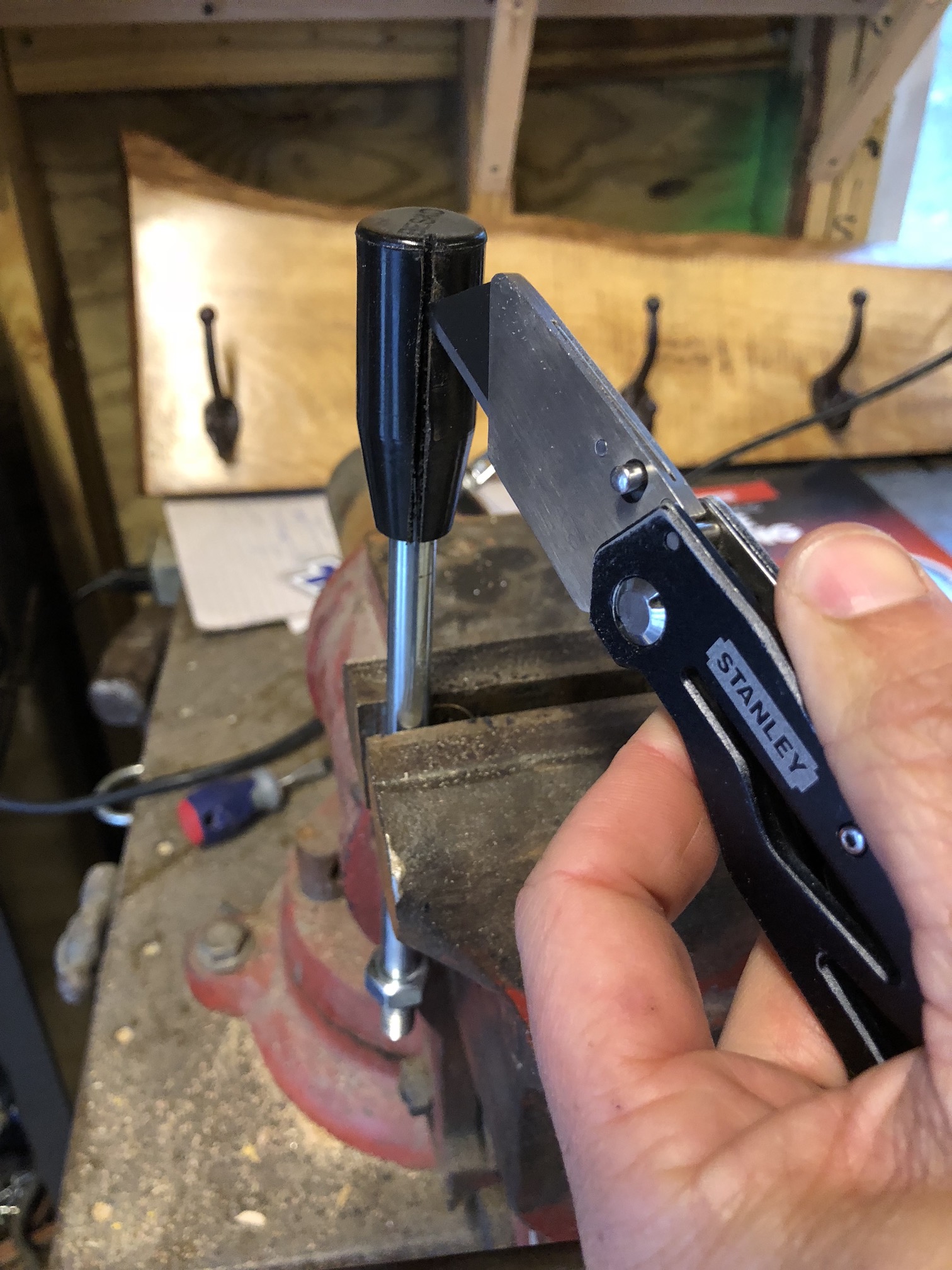

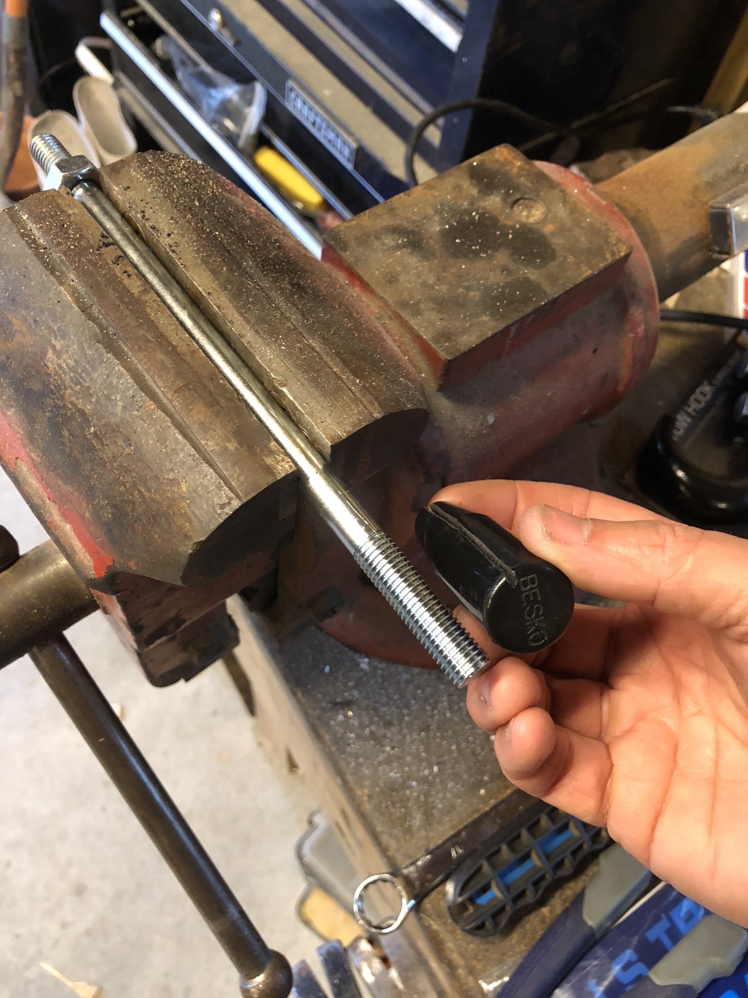

Hope this helps anyone that finds this thread. Apparently you are supposed to remove the old knob in order to put the new handle on supplied with the WR Long kit.
To do this I removed the joystick shaft and put it in a vise. You can then use a utility knife (razor blade) to make several passes down the length of the old knob. Once you are down to the metal the knob will be loose enough to screw off. Takes less than 10 min from removing the joystick shaft to having the new handle on. See pictures.
