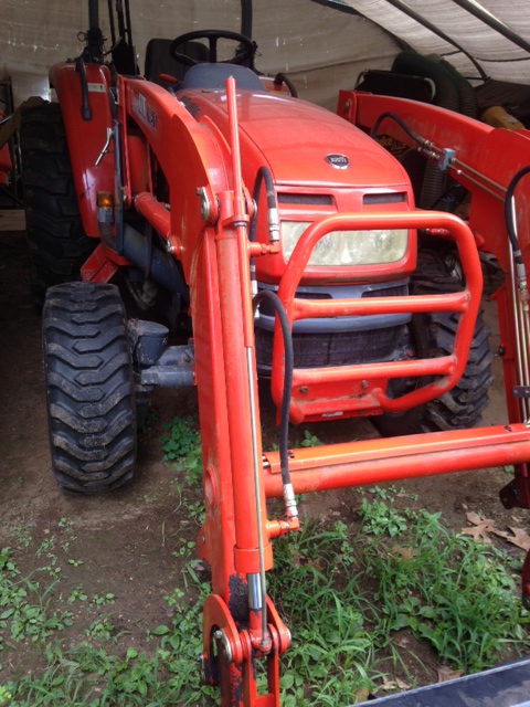

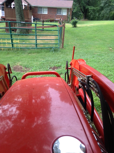

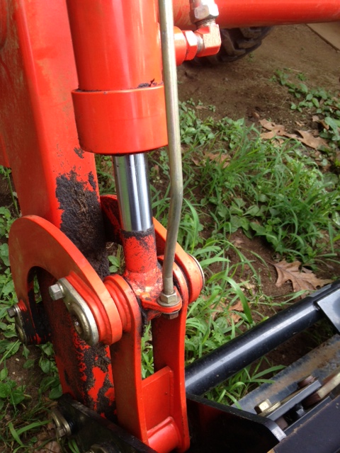

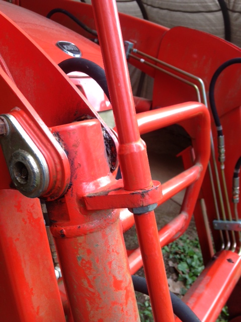

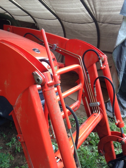

Here you go. This is on my DK 40. In my opinion bucket level indicator is very useful. I use it all the time. When rod is even with the top of the tube then the bucket is level. I'm sure that you could find or fabricate clamps to hold the rod and tube brackets to the hydraulic cylinder if you didn't want to weld like the factory indicator is done.

That is slick. Very simple but effective. Gives me some ideas and I'd much rather have it than always be rubber necking to get a better look at he bucket, like I do now. I've used tractors with the rod in the past and when you are moving a bunch of material it just makes it go better. Thanks

SF, I get that its good to have a project, but why not just go down to the dealer and buy one. They cant be expensive and would just bolt right on.

Here are a couple pics of the setup on my Deere.
Where it mounts @ the top:
And at the bottom:
Looks like a setup like this is more out of the way than a stock level indicator for yours, being inside the loader arm, if you're inclined to try to build something. As was said before however, a stock setup would bolt right up and look like it came that way
