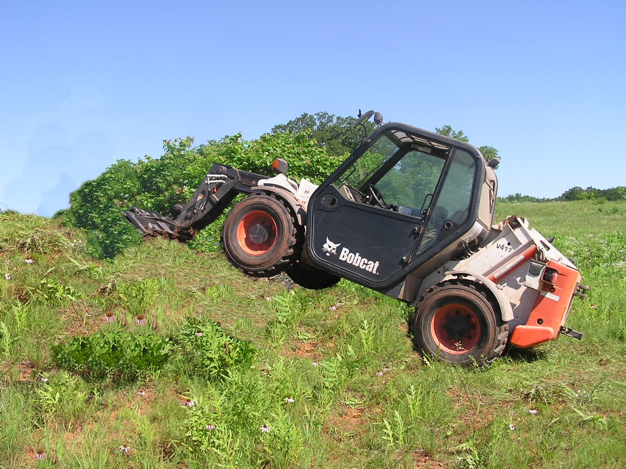

I think I get it now. It's all about how the weight is balanced between front and rear.
keep adding weight to the rear and eventually the front end lifts off the ground, removing ALL of the weight off the front. A wheelie. :)
The rear orange counterweight is 2200 pounds. With nothing on the SSQA, I can do a wheelie. :D

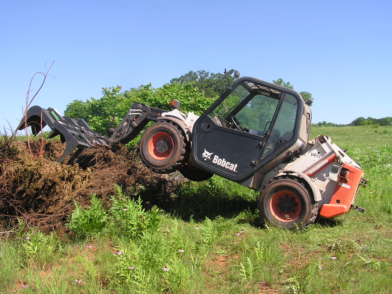

Well no one looked close enough at the picture to see that it is Fake News! :eek:
Here is the Real News picture with the grapple compressing the brush:
   / FEL Lift capacity #88
Man I believed you because my buddies gehl skid steer really did that.
