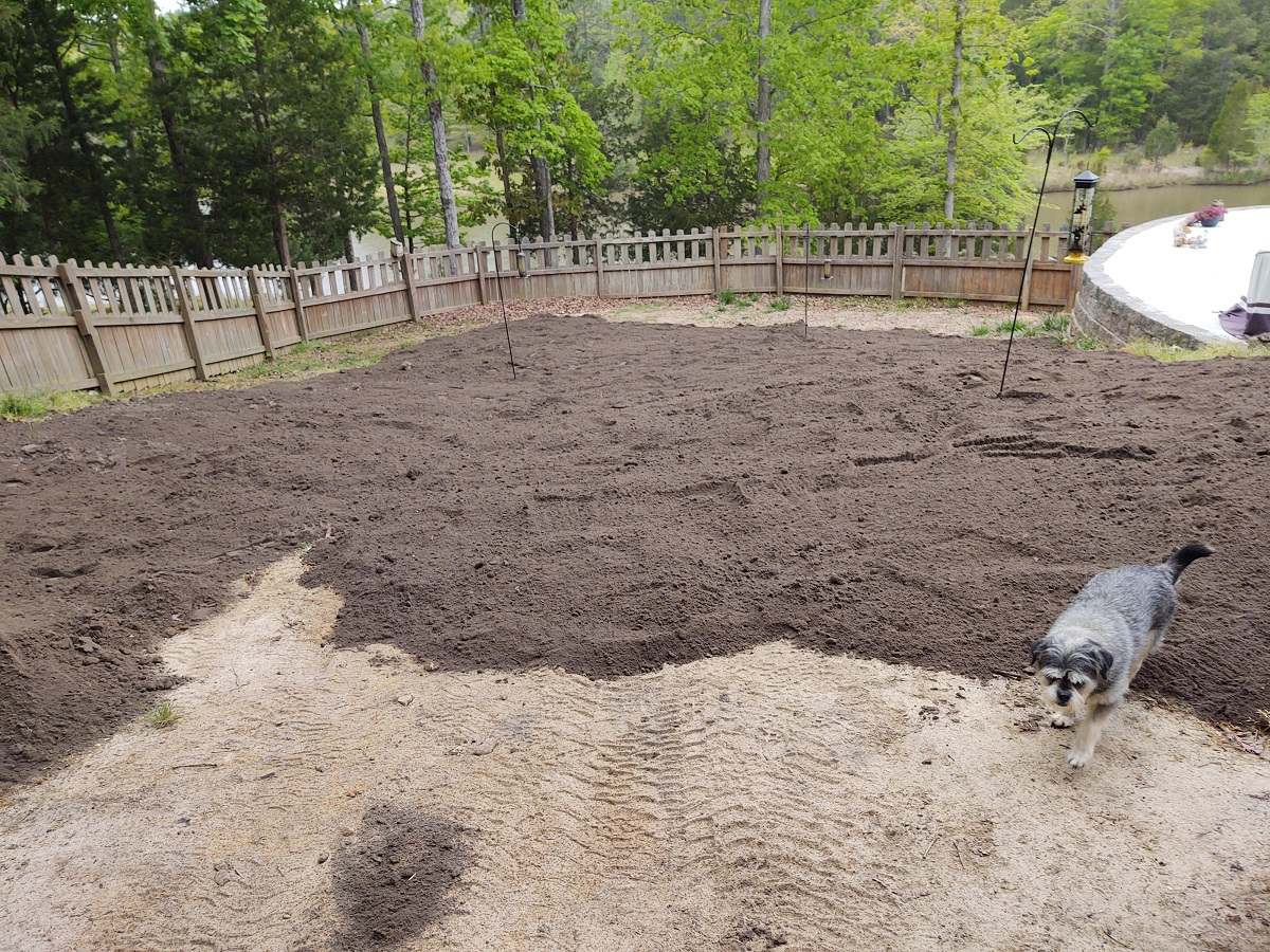

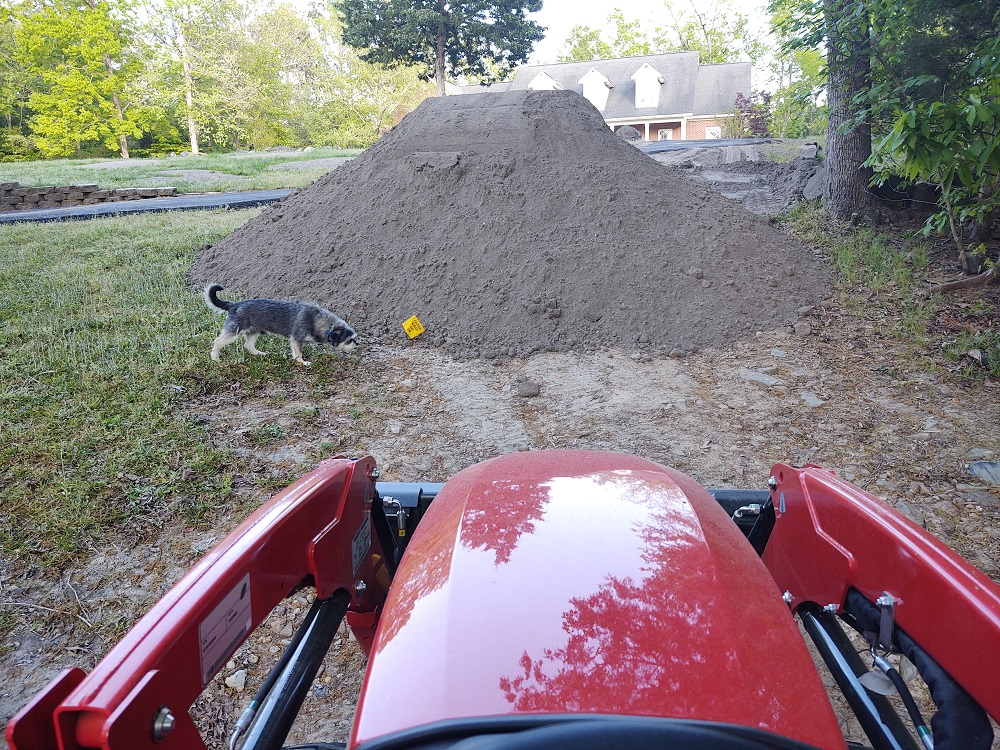

This is sparking my interest too. My land is very hilly, and working a lot of dirt on the hill, I am using 4WD all the time, probably 80% of the time the tractor is moving. My average slope is 10%, and it goes up to over 25--I stay off that part unless going absolutely straight up or back. Last night was this 22 ton load of dirt down to the backyard. So is using 4WD on dirt going to cause me problems ?
