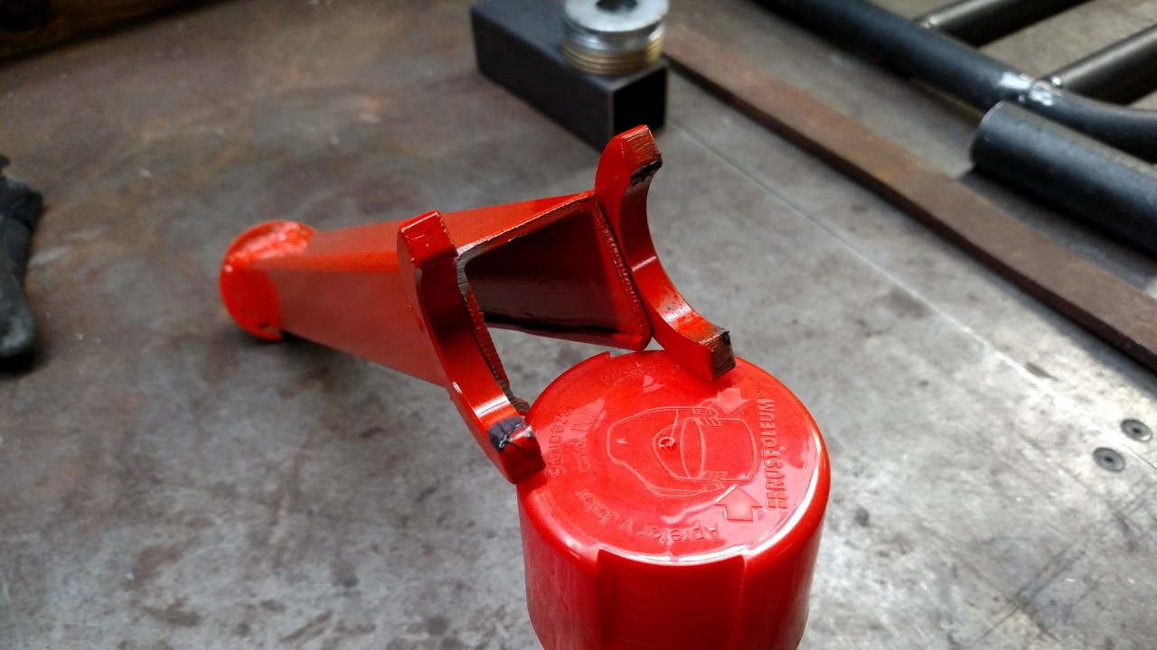

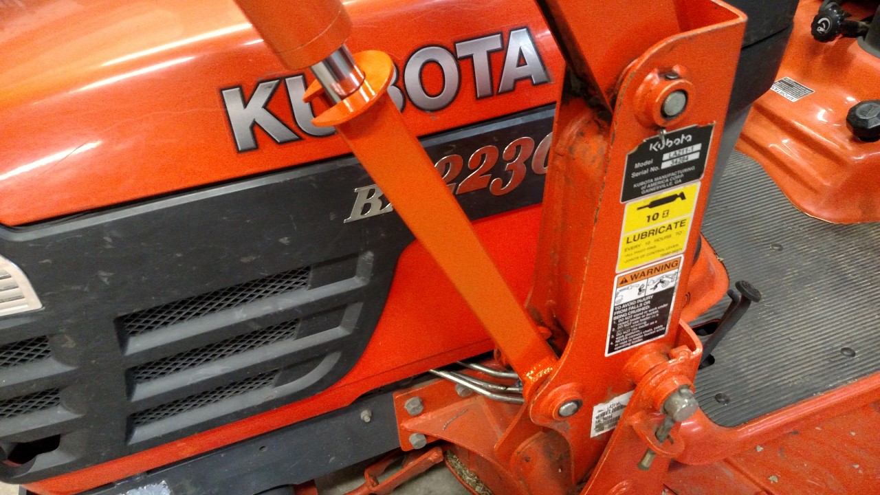

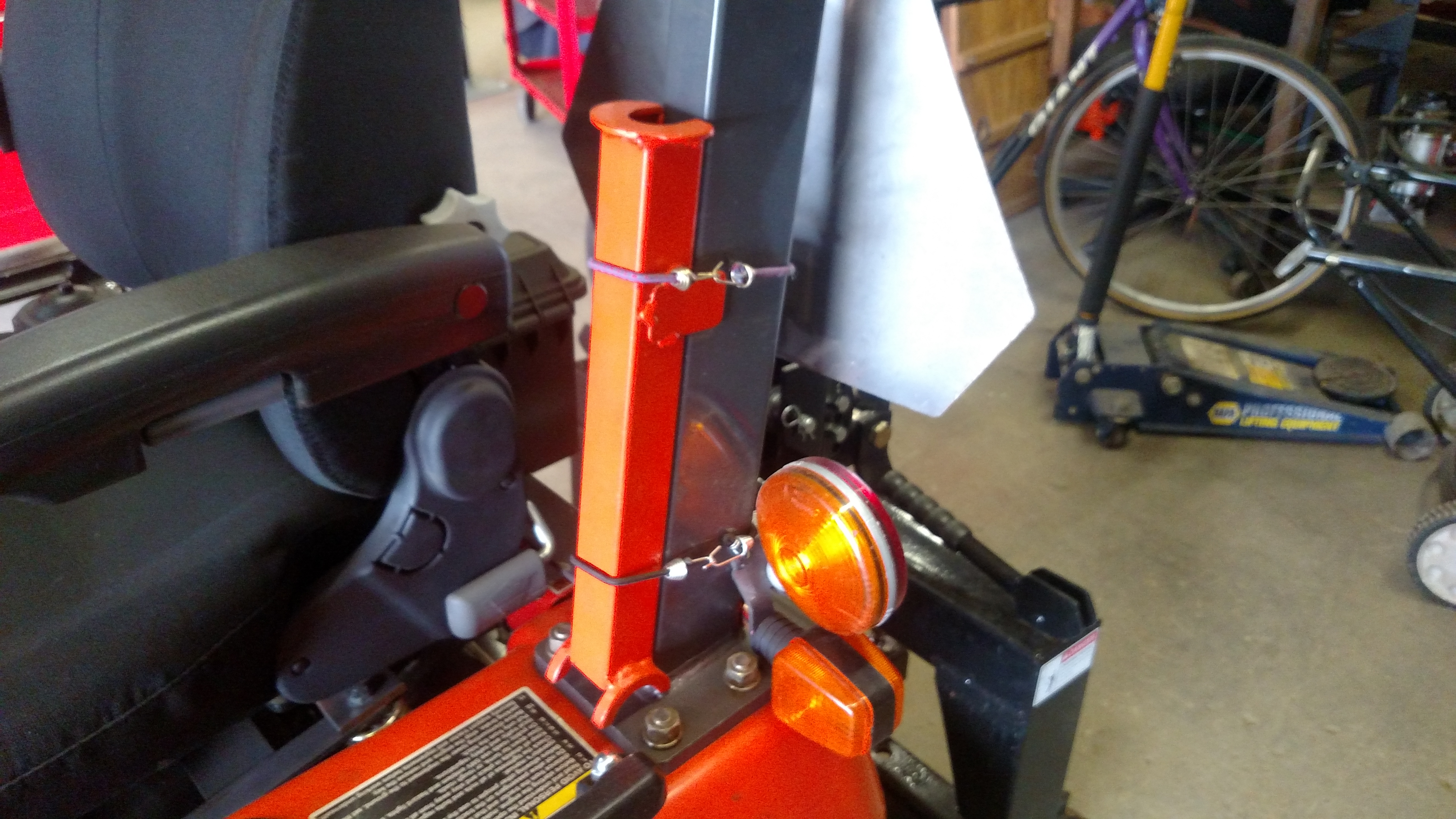

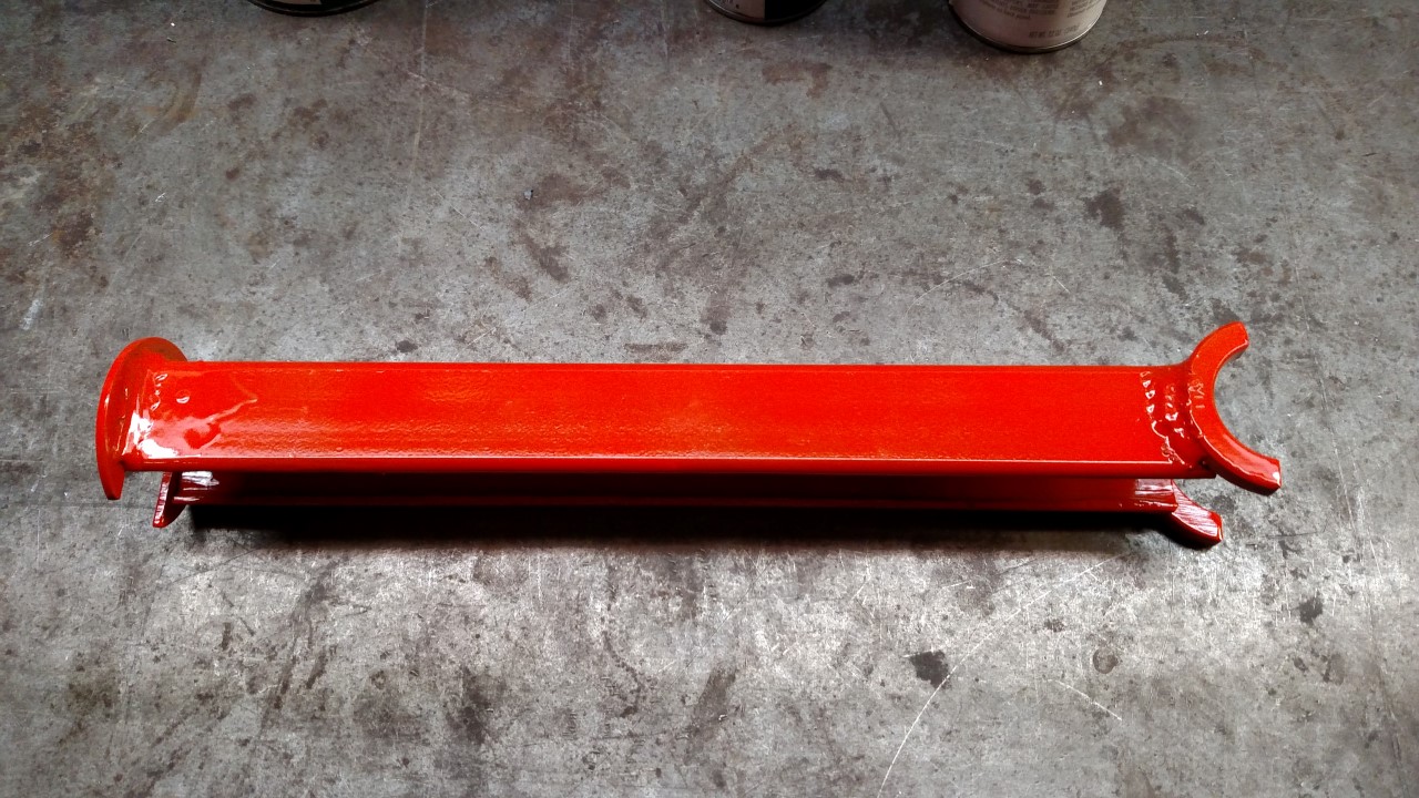

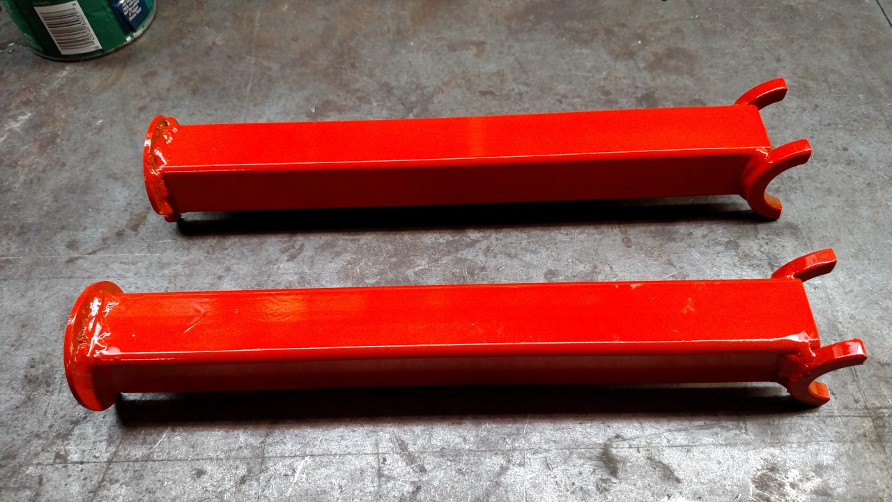

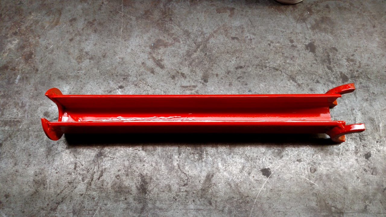

Here is what I made for my BX. The curved pieces on the end that pivots are a 1 1/2" shaft collar sliced in two, then those cut in half. I used 1 1/2" square tube with one side cut out with a plasma cutter. I used a 1" flat washer on the other end, cut to slip over the cylinder ram.
They are only for holding up the empty FEL, not any kind of load.
Edit: I forgot to post a picture of how I added a couple of tabs to stow it strapped to the ROPS.
