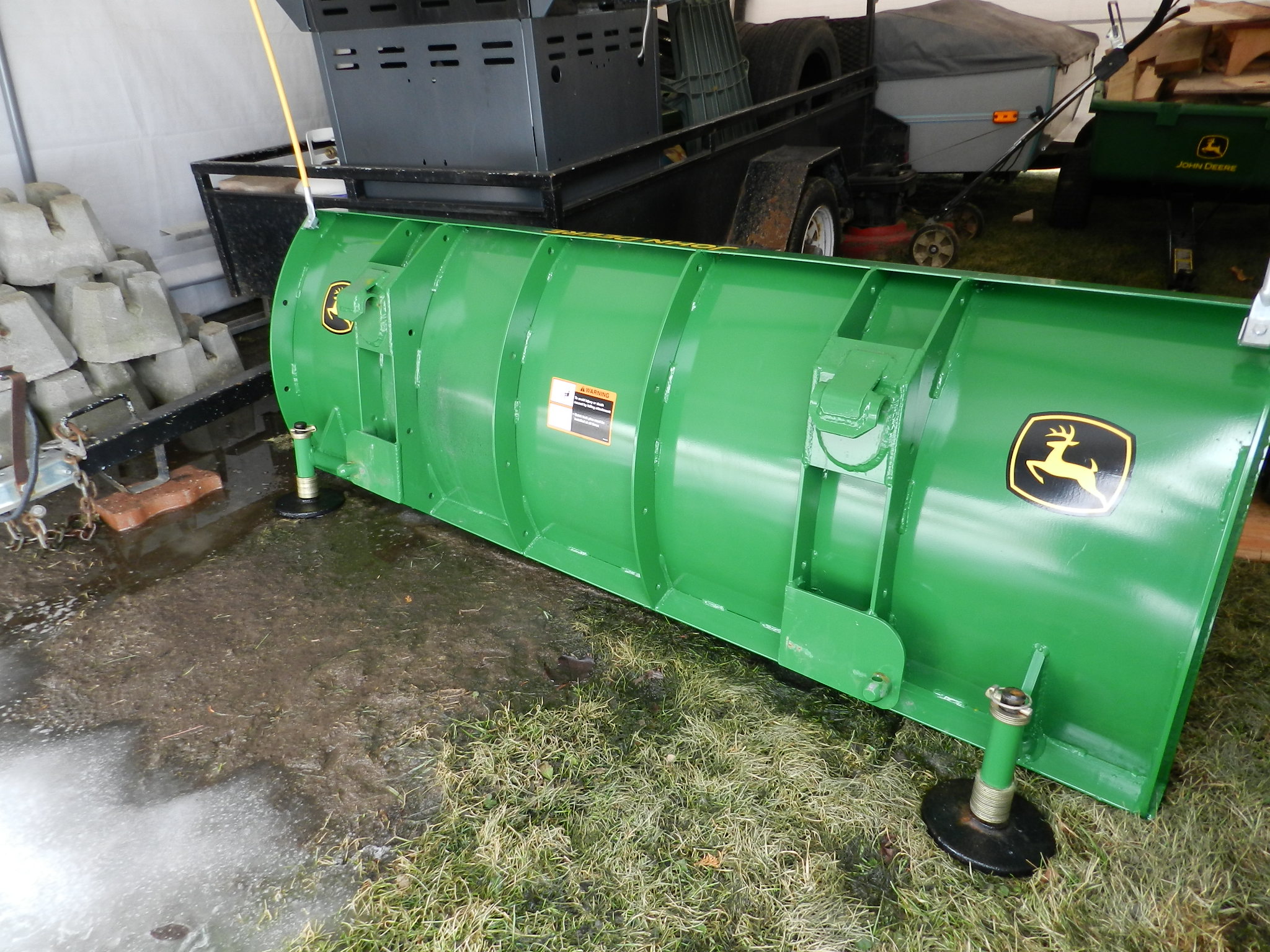

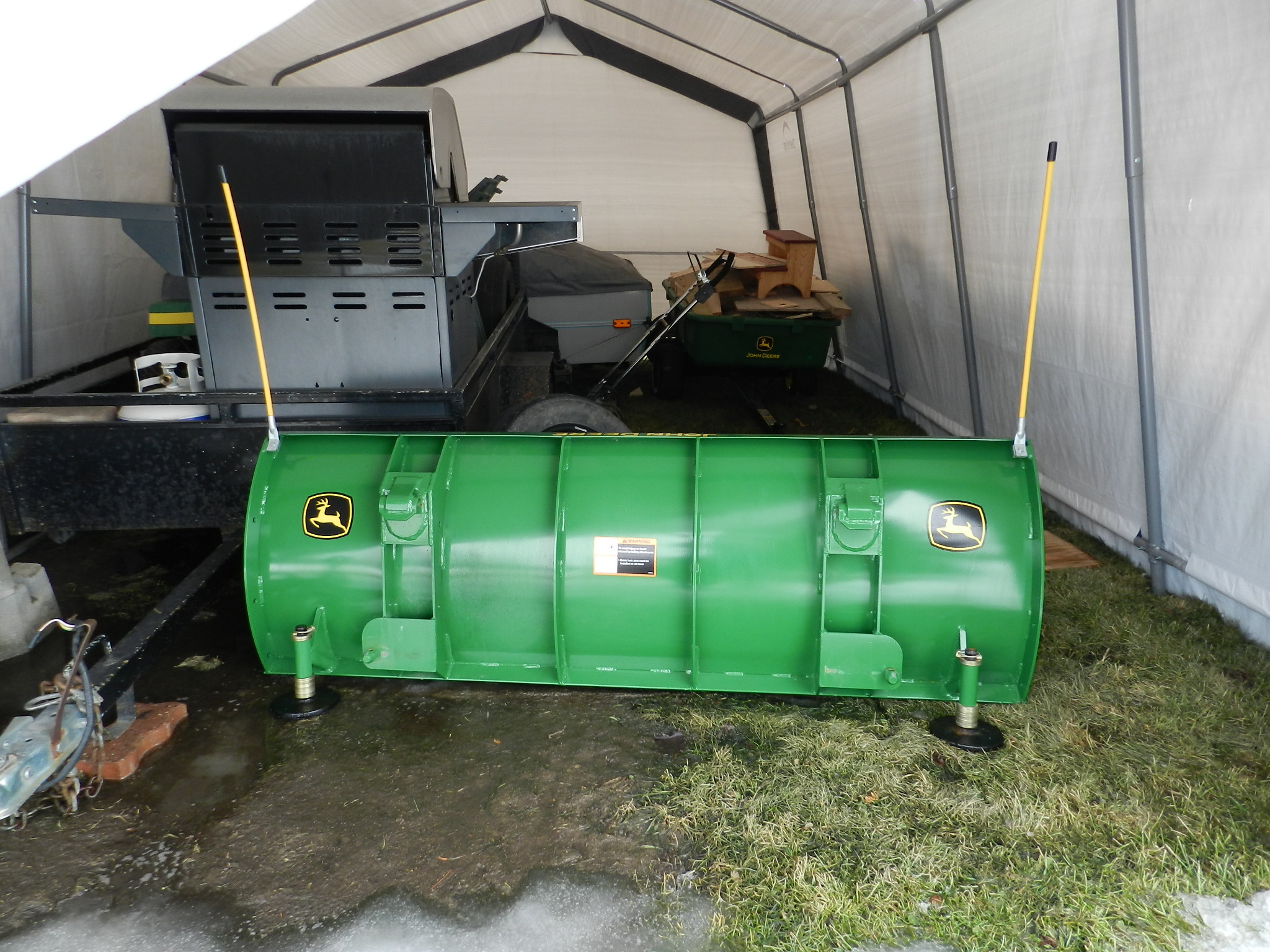

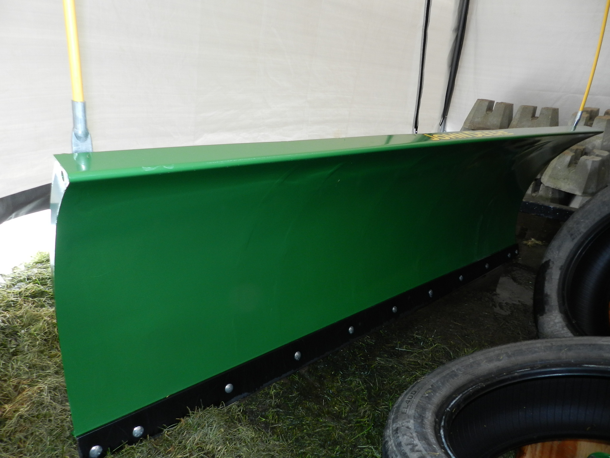

I have a JD2320 (24hp 4x4) and made the blade in the pics for my loader. The blade is 6 feet wide and 24" tall. I decided not to make it angle to avoid destroying my loader as on these smaller tractors they are not the strongest. I also didn't make it with trip springs to keep the build simple. I figured as long as I'm somewhat careful I shouldn't brake or bend nothing.

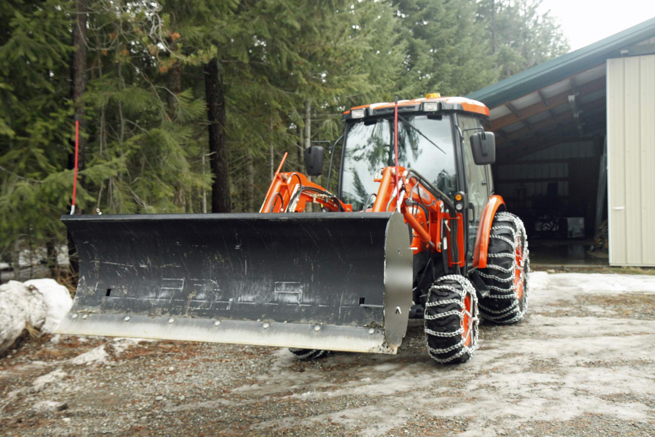

I use my TC30 to plow with. Works fine. I consider it my economy model! Options would be heated cab, bigger tractor, bigger plow, angling plow, etc.! But it does just fine for me. A snowblower on the front would work as well! Here is a pic I posted before. Trip springs are nice if you have frozen uneven ground to plow. I have two springs on the plow (plow hinges) at the top that work against the chain hook on my FEL.

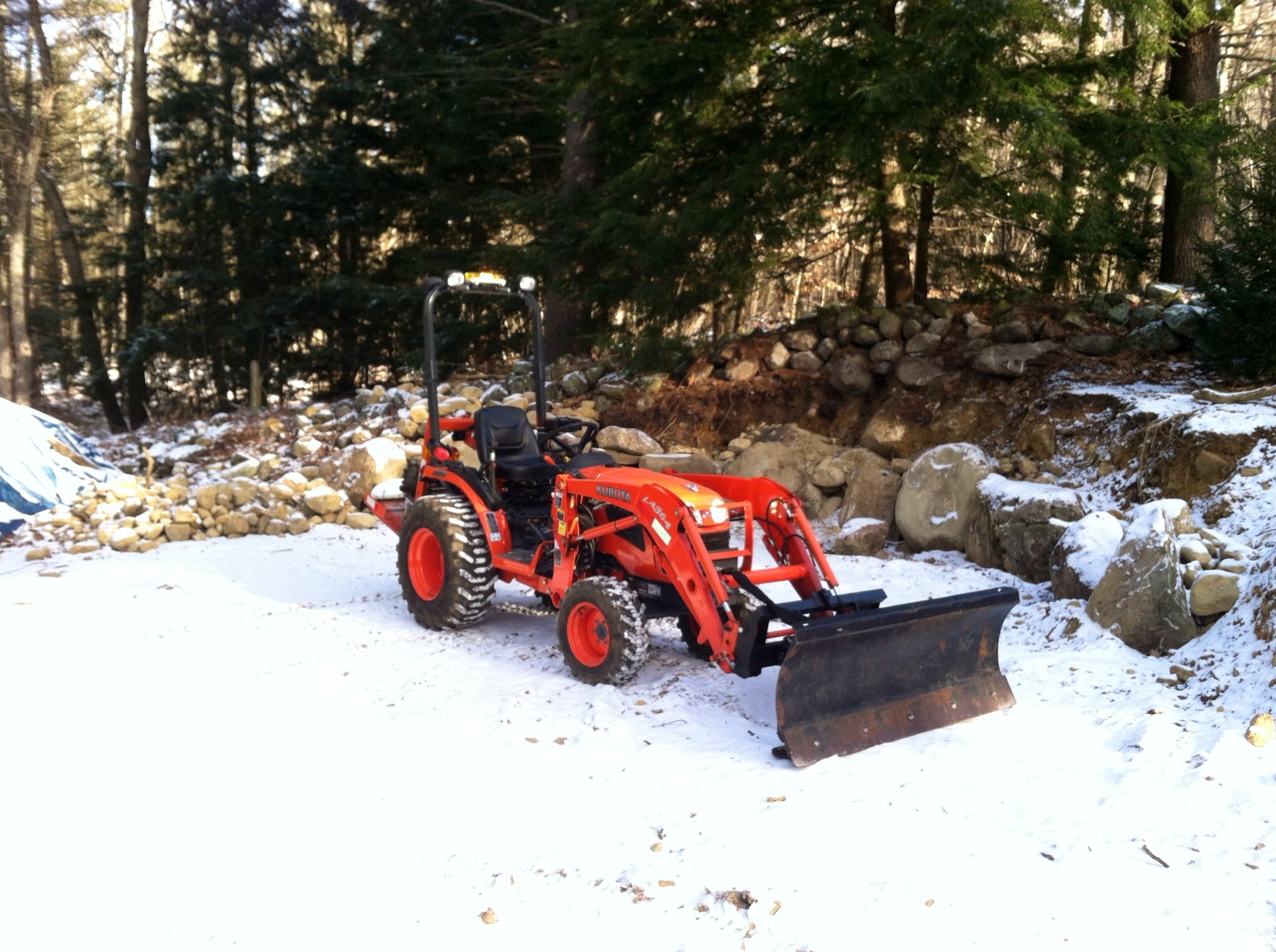

I put a 60" W.R.Long front blade on my b2620 TLB and it works great. Here is a pic of it on the tractor cal2620.
