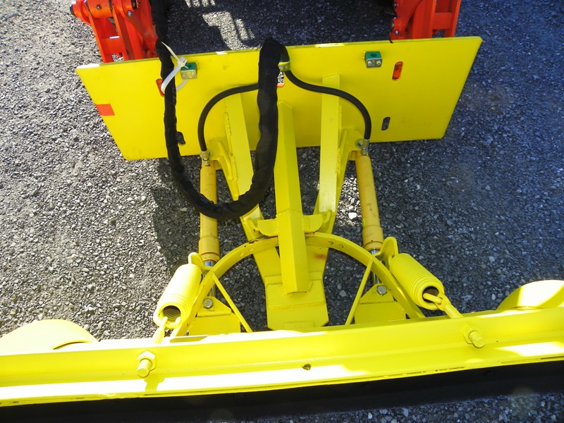

I have a B2320 w/bucket and a 1/4 mile steep and windy driveway. i currently plow with my jeep but it really beats it up. the plow frame is very low to the ground and takes away all ground clearance when not plowing. So I'm looking for an alternative. The Bxpanded plow looks like a very good one. does anybody have experience with it and do you think 23 hp is enough for a 72" blade . I think the 60" might be too small.

Don't have a B,but have plowed with a four ft.on an ATV,a six ft. on a L3130 and a eight ft. on a L4240.Mounted way out on the bucket.....I think a 60" would be all you want.Just keep your banks pushed back.

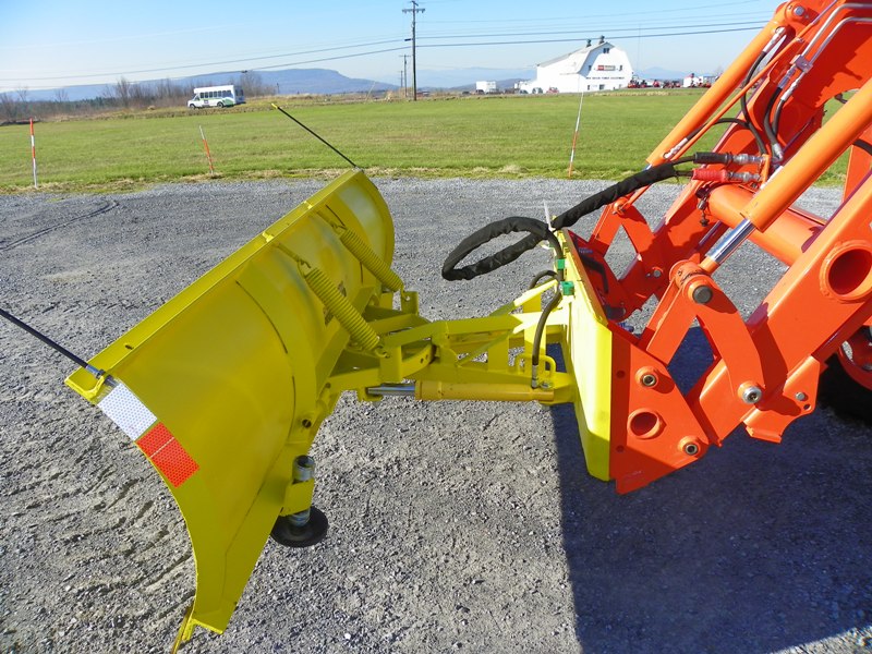

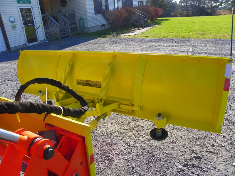

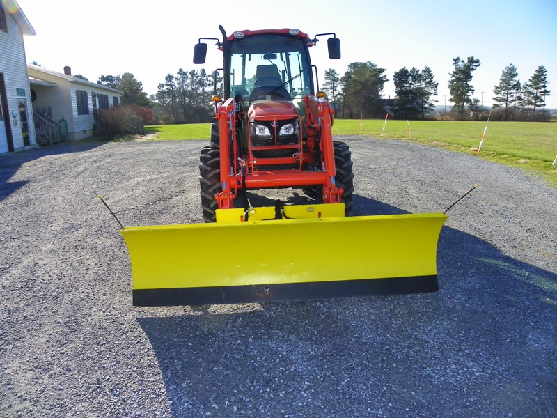

Just put my snow plow on the Kubota M7040. It will be coming.

6' does sound like a but much for that small (light) of a machine. But I dont have much experience with that sized tractor.
As far as 23HP being enough. Absolutely it is. HP is not the issue. Traction IS. Ad the heavier you are, the better. (as well as snow chains). And you can always add more weight if you need.
That said, I wouldnt be afraid of running the 6' on that machine. Cause you can always take a smaller bite with a larger than needed blade. But you can never take a bigger bite with a smaller blade. And even so, with where you live, I am sure you will see snowfalls that would even give a 4' blade on your machine fits. You just have to learn how to operate things. But the 6' would sure be nice for those lite dustings of powder.:thumbsup:

I used a 6 foot plow with a Kubota B2410 (24 hp). It was a Kubota plow mounted close in on a subframe. Pushing downhill or flat should be no problem even with wet snow. LD1 is correct - traction will be the limiting factor especially going uphill. I had tire chains, loaded R4 rear tires and 500+ lbs rear ballast and i would run out of traction trying to push up hill in a wet snow.

I think a 60" plow would be all you would want. You want a plow that will clear your tire tracks. If you go to wide the plow will handle the tractor instead of the tractor handling the plow. I don't know if you would benefit from a wider plow doing a driveway unless your driveway is wide.

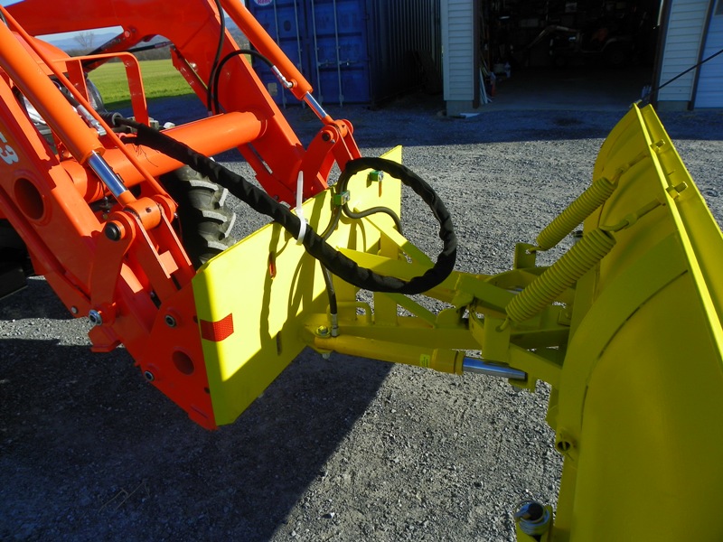

I like the pics!! I'm connecting a western plow to my front auxiliary hydraulics. Besides adapting the lines did u need a diverted or solenoid to run the power angle... Because I see you have them connect to the front ports like I want to do. Thanks!
/ FEL mounted snow blade #11
bravo5:
I did nothing. It works fine. One line to each cylinder.

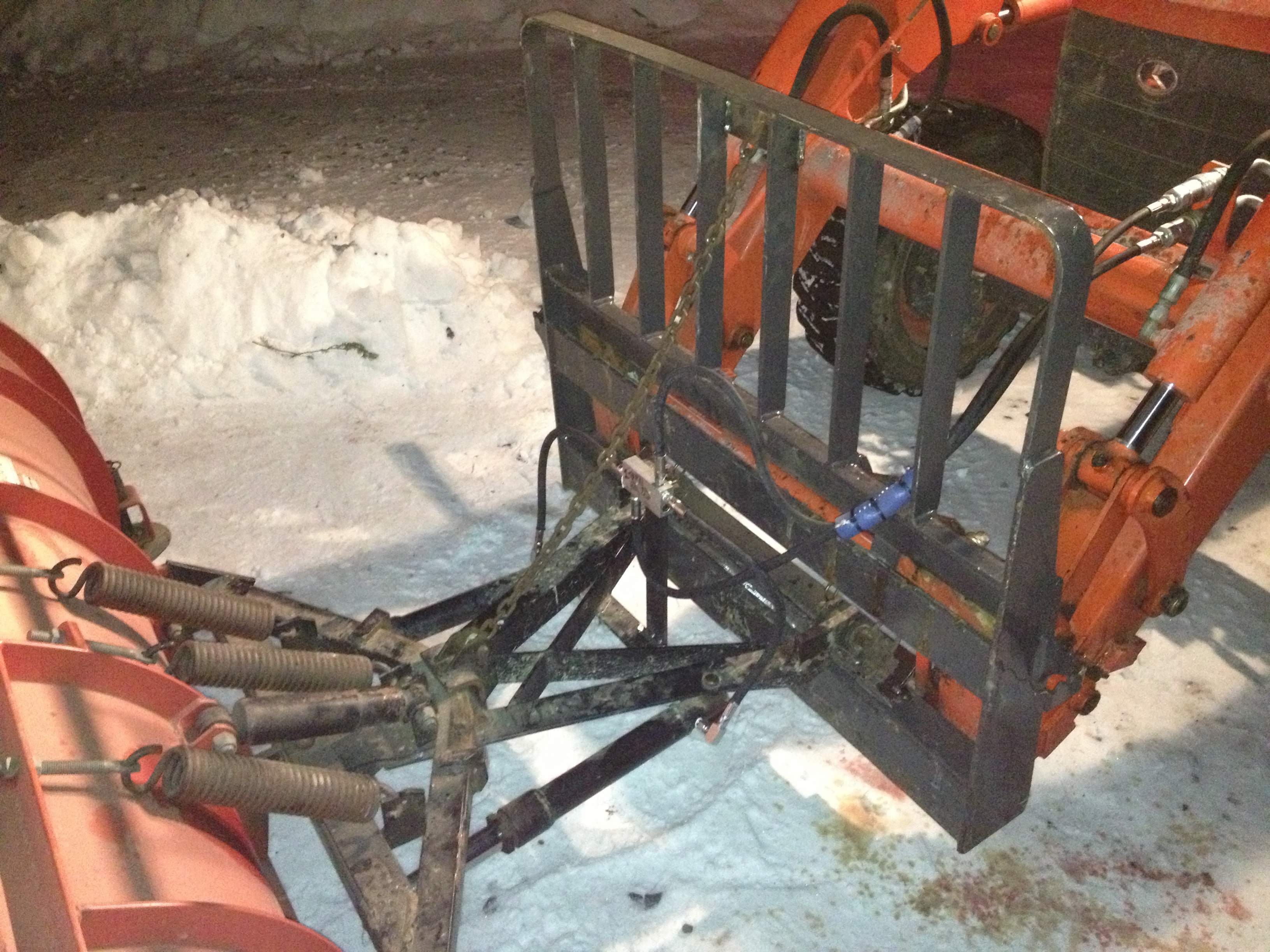

Ok thanks! Ill keep ya posted n the status. Merry Xmas
/ FEL mounted snow blade #13
Everything went well. I converted my forks to also accept the plow set up. One less attachment I have to store. image.jpg
