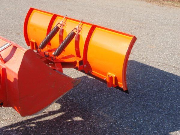

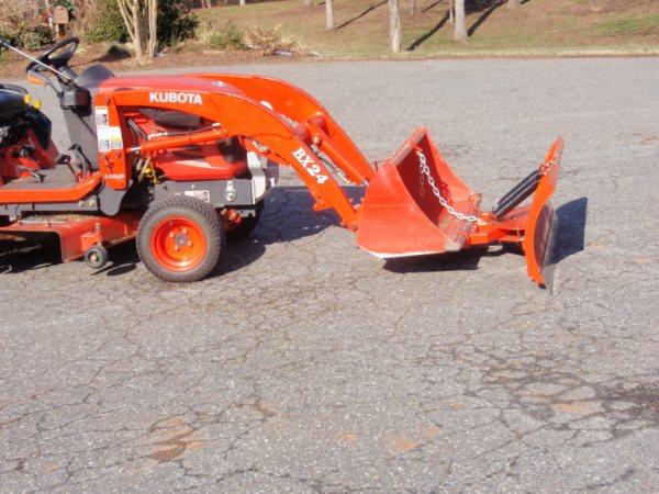

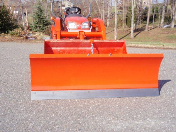

Maybe this could help... Available really soon. No pricing yet.
Details: Works with any FEL. Blade is 60 inches wide, approximately 20 inches high. Blade is 11 gage steel (same as the FEL bucket) Goes on the bucket in about 30 seconds with no tools. Angles 0, 15 and 30 degrees each side. Can be easily offset approx 12 inches to either side to move the pile farther off the road. Blade floats independently or the bucket can apply down pressure for icy conditions. Trip springs. Replaceable edge. Skid shoes optional. Works with our Bucket Xpander installed. Will probably offer a 66 and/or 72 inch version also. Will ship UPS.
We will offer different replaceable edges: Mild steel for light use or unpaved surfaces, Hi Abrasion Resistance Steel for pavement and concrete, and UHMWPE plastic for nice surfaces such as finished concrete, smooth asphalt, brick or pavers. We'll probably offer a round edge for gravel surfaces. We will likely offer to paint to match the tractor brand.
Just email contact@bxpanded.com and let us know what features would work well for you.

Darnit Harry, you did it again!!:) You made something I'm going to have to buy. Looks great and hope you do well with selling the blade. Tod
