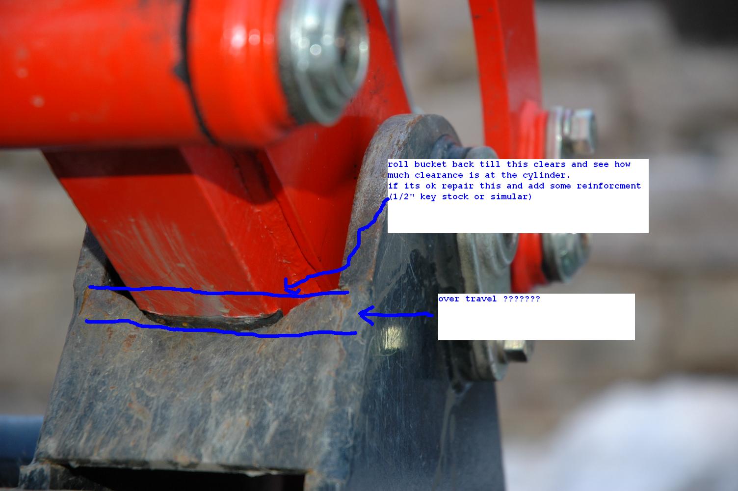

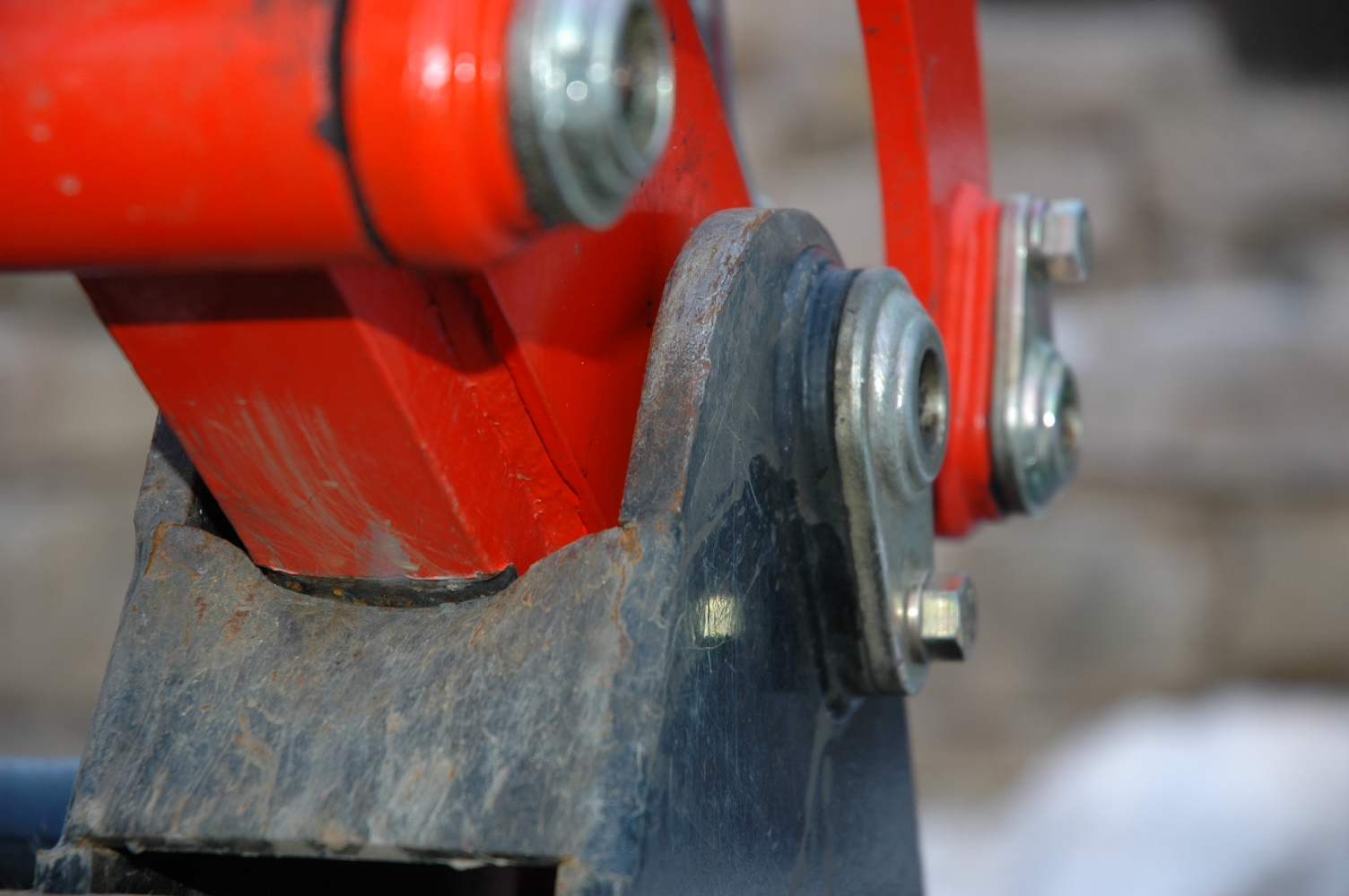

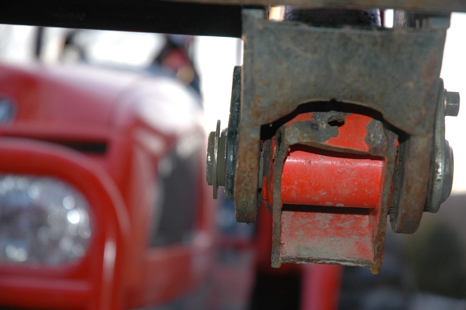

At long last here are the pics and an explanation of what they are about:
First pic is the left fel arm in the raised and curled position, viewed from in front of the tractor.
Second pic is the other side, same position and view.
Note in both pics the black item/plate is the QA plate pushed in on both pics at the bottom of the plate, and the end of the fel arm (orange rectangular tubing) just below it; with the end of the fel tubing all mangled up on both sides.
Third pic is with the bucket overhead shooting the 1/2moon brackets from underneath, against the sky as background. This shows the twisting of the 1/2 moon plates on the left side of the fel arm.
Last pics is under right side fel arm in the full 'dump' position. This shows how the Q A plate is bent, and where it hits on the stop that is supposed to stop and damage like this from occurring.
I've got many more pics, but I think this represents what is going on, and the damage done.
Comments, ideas, suggestions.....

   / FEL pistons housing hits FEL arm(s) #20
here is a marked up picture
tom
