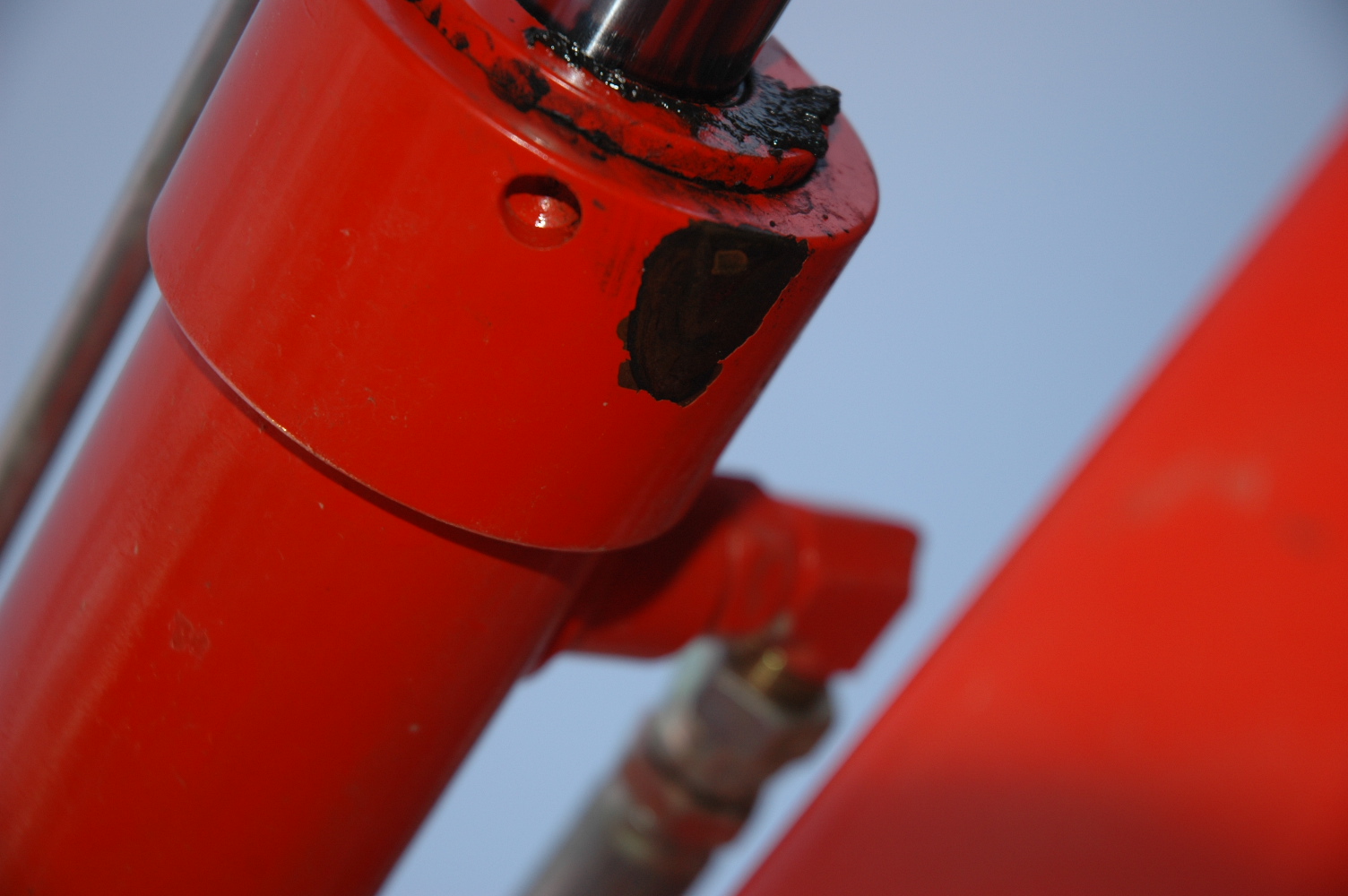

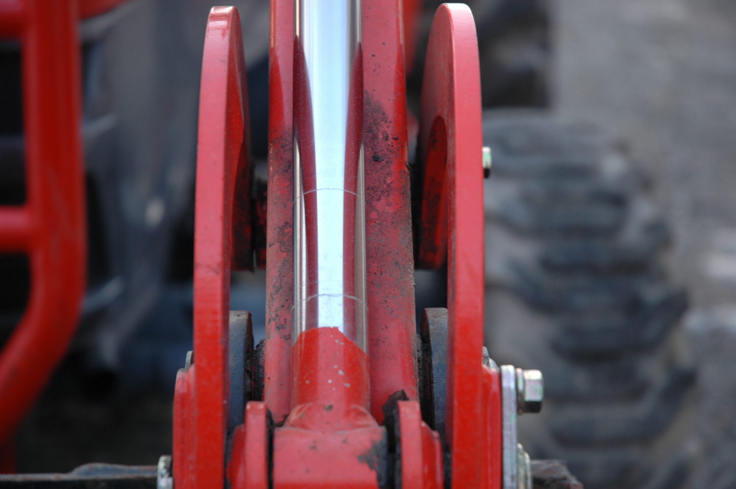

Here are some further pics- I seem to be getting the hang of getting them into the post:eek:
1st shows fel damage to end of fel tubing closest to bucket end of fel.
2nd shows unmistakable piston contact with fel arm's top surface, which damages both piston housing as seen from underside of piston in last pic of this group.
3rd shows damage to the curved metal 1/2 moon 'bars' on either side of each piston. Misalignment allows the bars to get scraped, as can be see if viewed closely.
Last pic is damage to piston housing, (on the underside) when it hits the fel arm below the normal range of the piston housing's travel.

I see from the second pic, your arm-to-rod curved link is buckling from compressive forces, which will not happen when back-dragging. From the geometry, it looks like you have to be putting forces on the bucket to place the cylinder in tension to cause this. Excessive breakout forces, dozing forward with the cutting edge vertical and this kind of activity seems to put the loads into this configuration. Are you lifting too much with the forks ends? If not, this is just a plain out and out design deficiency, IMHO. The effective length of the link is shorter putting the cylinder closer to the loader arm. The shorter length is also giving more rotation in the full dump position allowing the mount plate to strike the arm.
If the dealer refuses to warranty the links, replace them or repair them. I'd add some flange material to the inner and outer edge to strengthen them against future buckling. Think making an I-beam cross section out of them, taking care to not cause interference with anything.
