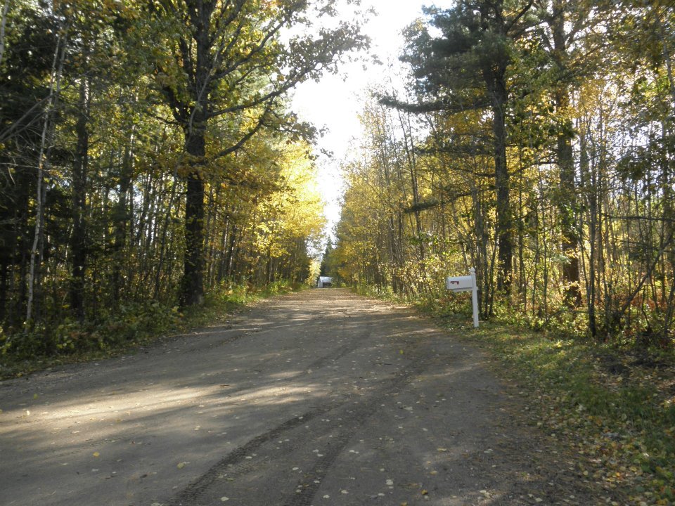

Here is a picture of my drive. This was taken before the recent snow we had.
I have a cub 7305 rated 30 hp and I believe 24 hp at the PTO, I have a five foot rear mount blower, I do have hydrostatic and I do not have a problem blowing snow. If it starts to bog down, I just slow down. I would look for a used blower on craigslist. There seams to be a lot of them posted, if your patient you should find one that fits your needs and I would think for a lot less than 3K/

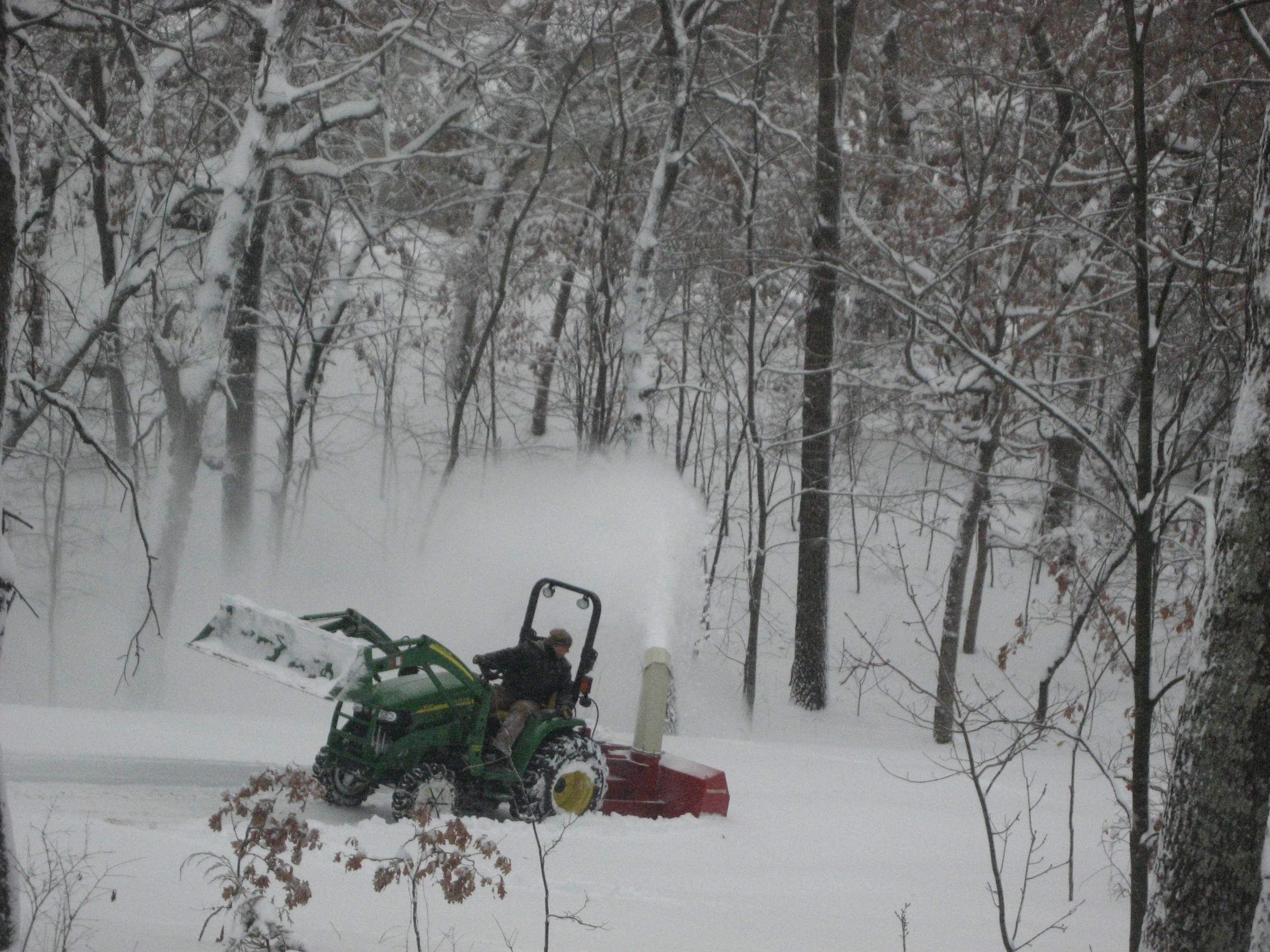

I have your exact situation or I did three years ago. I have a long steep gravel driveway. I used the bucket the first year and it sucked. You have little control to turn while pushing the load and you end up grabing alot of gravel. Also since the you are on a hill you pretty much have to push it all the way down. If try to push it to the side you may end up stuck on the side?
the second year I got a used pto blower- It is the answer. You don't have windrows and everything looks so much better. Plus it only takes one pass up and down. The only problem is that you cant set it down to the ground or you will blow gravel through your blower and all over the country. So you will have a small amount of snow to scrape of with the bucket/plow.
This year I finally made my Plow for the FEL because the bucket edge does not articulate to follow the ground and is at an angle that is very agressive if you hit something or are just working on softer ground. I also wanted the ability to push the snow to one side of the drive way on those days you only get an inch or two so that I could make one pass with the blower.
Next year I am hoping to afford the blacktop for the driveway and will put a poly cutting edge on the blower so that I can work right down to the blacktop with the blower then use the plow to do as mentioned above and squeegee the driveway clean after the blower.
So to anwer your question- both, but if you can just afford one this year, go with the blower.
   / FEL Plow blade or rear snow blower? #6
here is a pic of the snow removal with the blower. I only run chains on the front. I go slow and don't ram rod my equipment. the front chains provide stability and turning control side to side for the plow and push when going up hill in reverse with the blower.
BTW- you get use to looking backward, I even thought about a mirror on the FEL arm. One other note. if you can spring for a hydraulic chute rotator you won't regret getting it. It is awsome to be able to turn your chute as you are manuvering.................you can avoid snow in the face alot of times if you get caught of guard with the wind.
