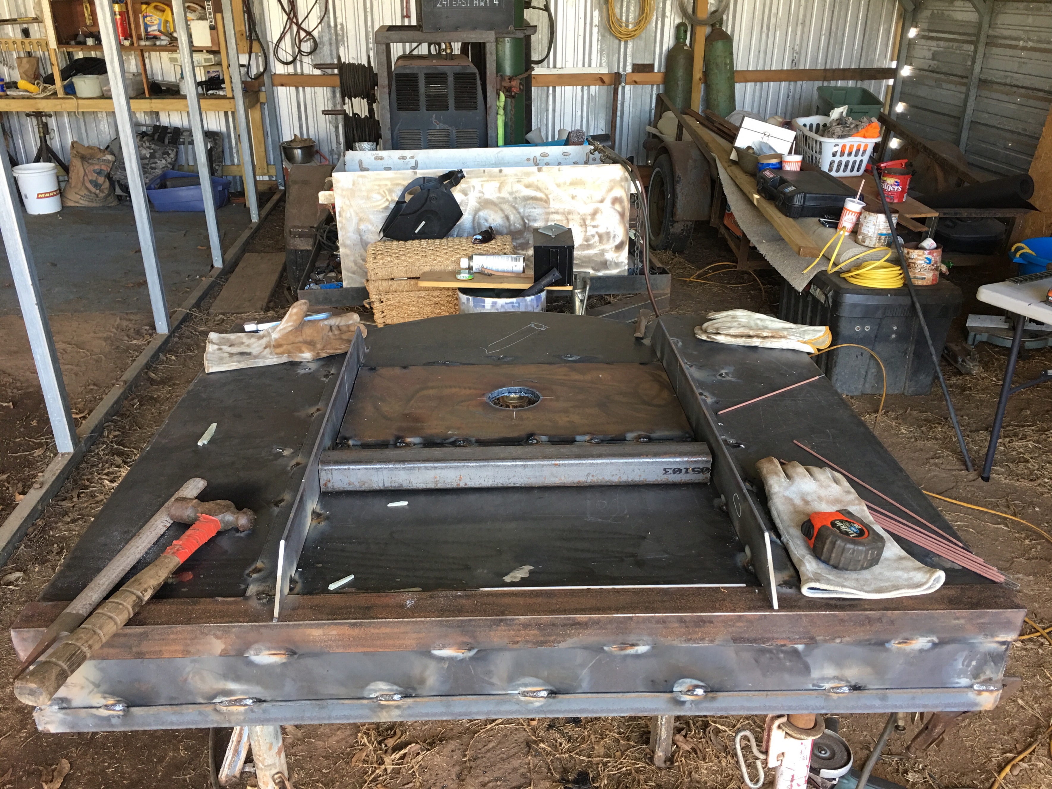

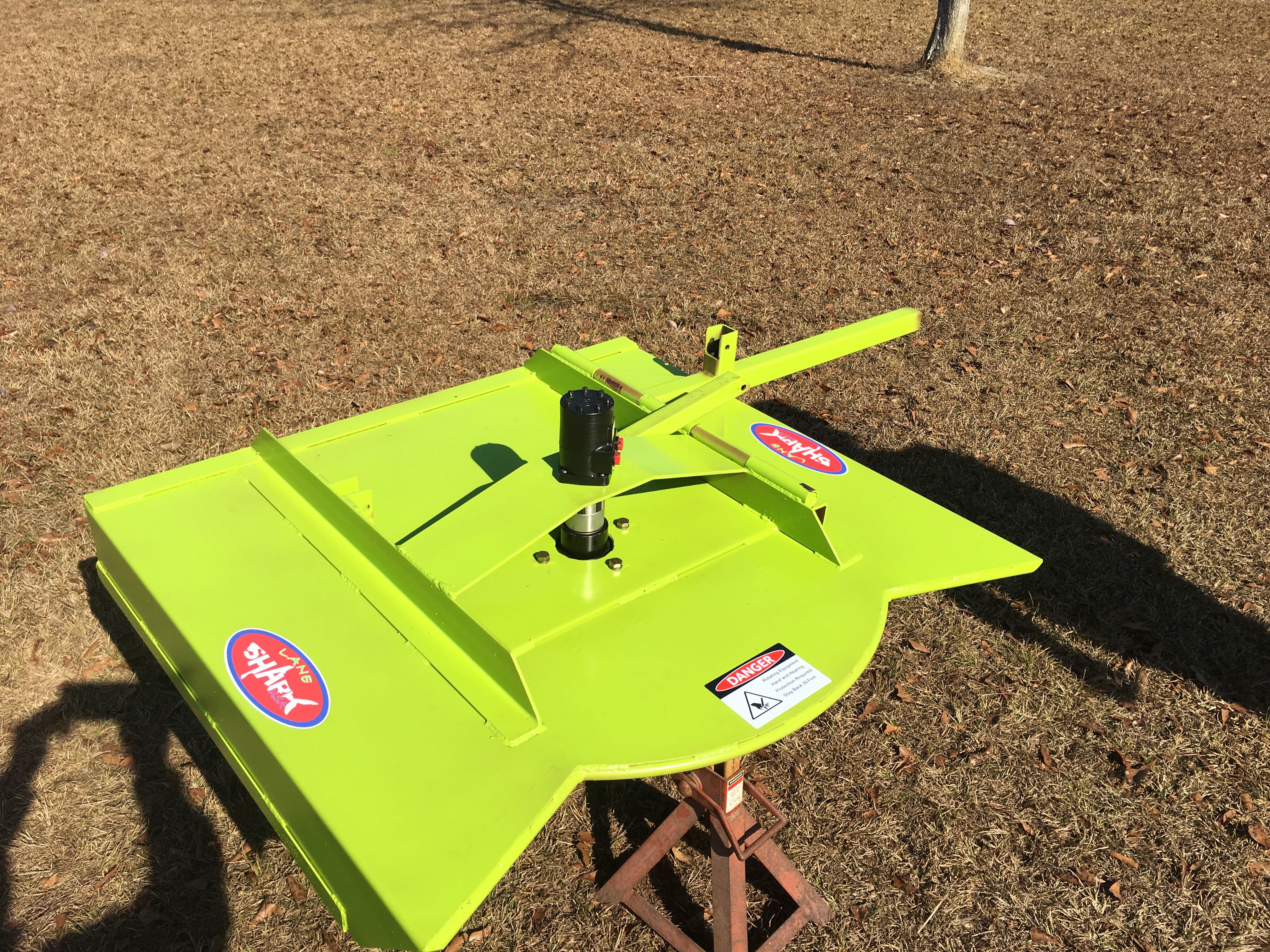

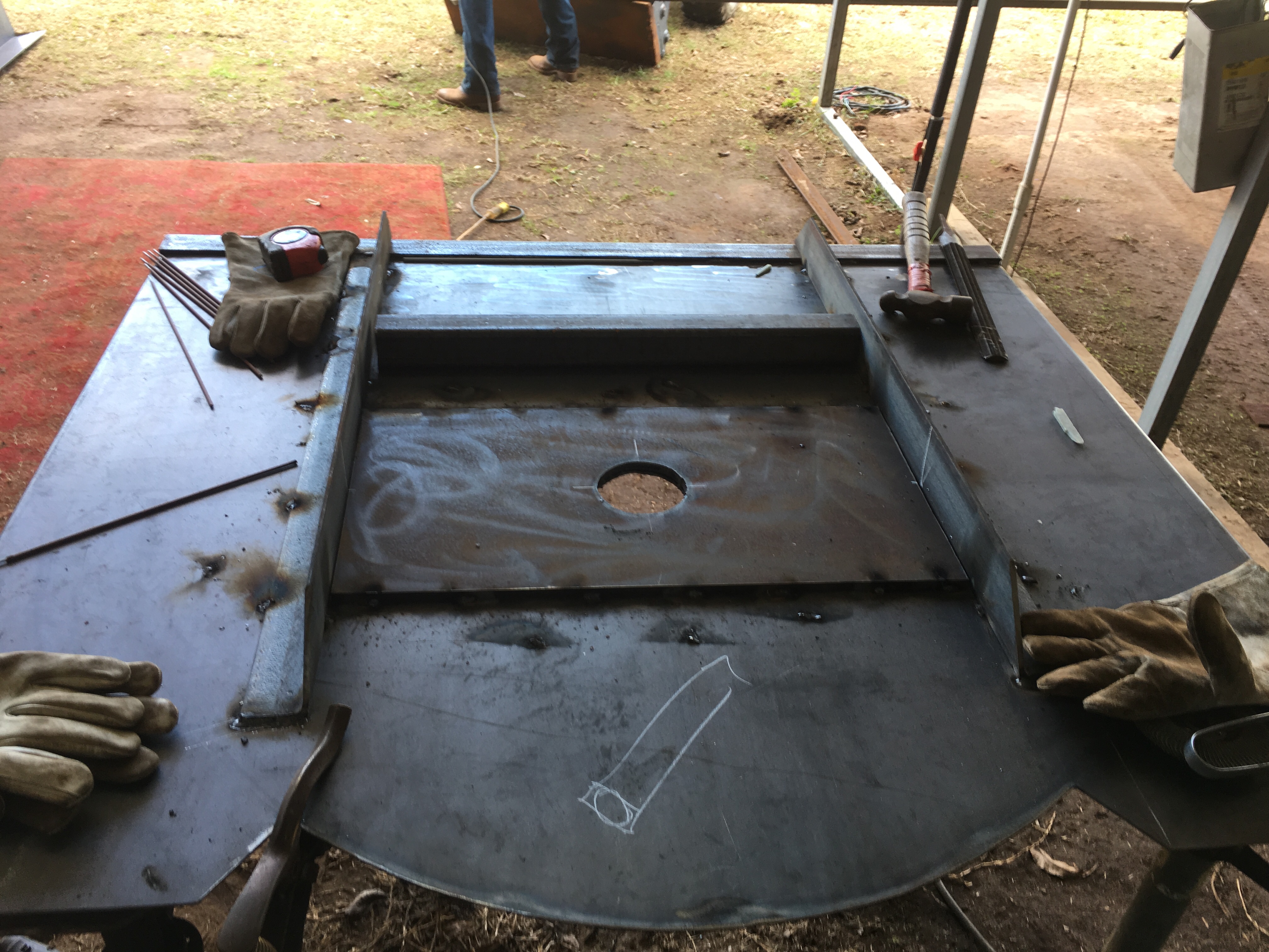

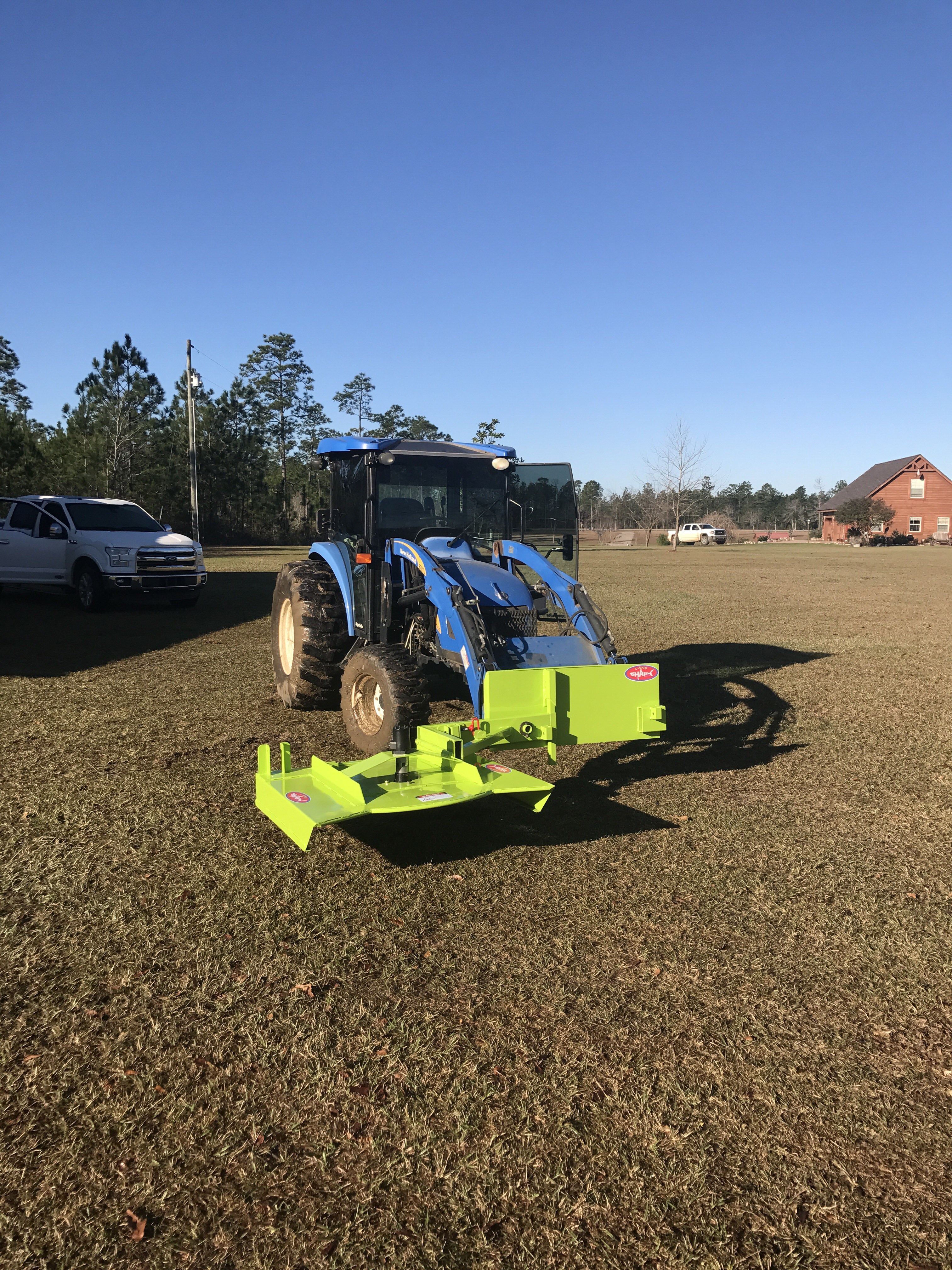

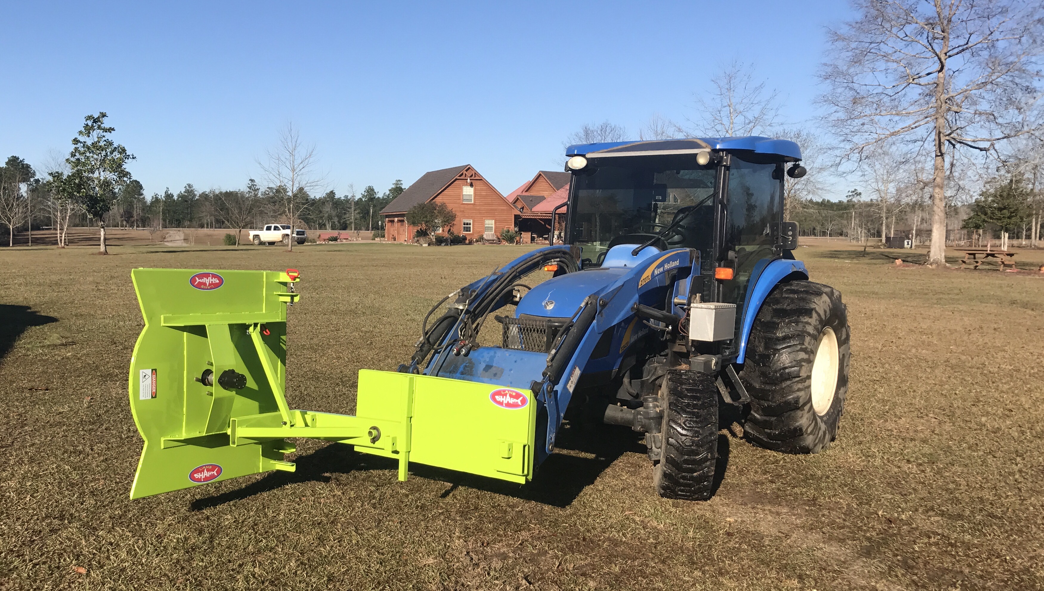

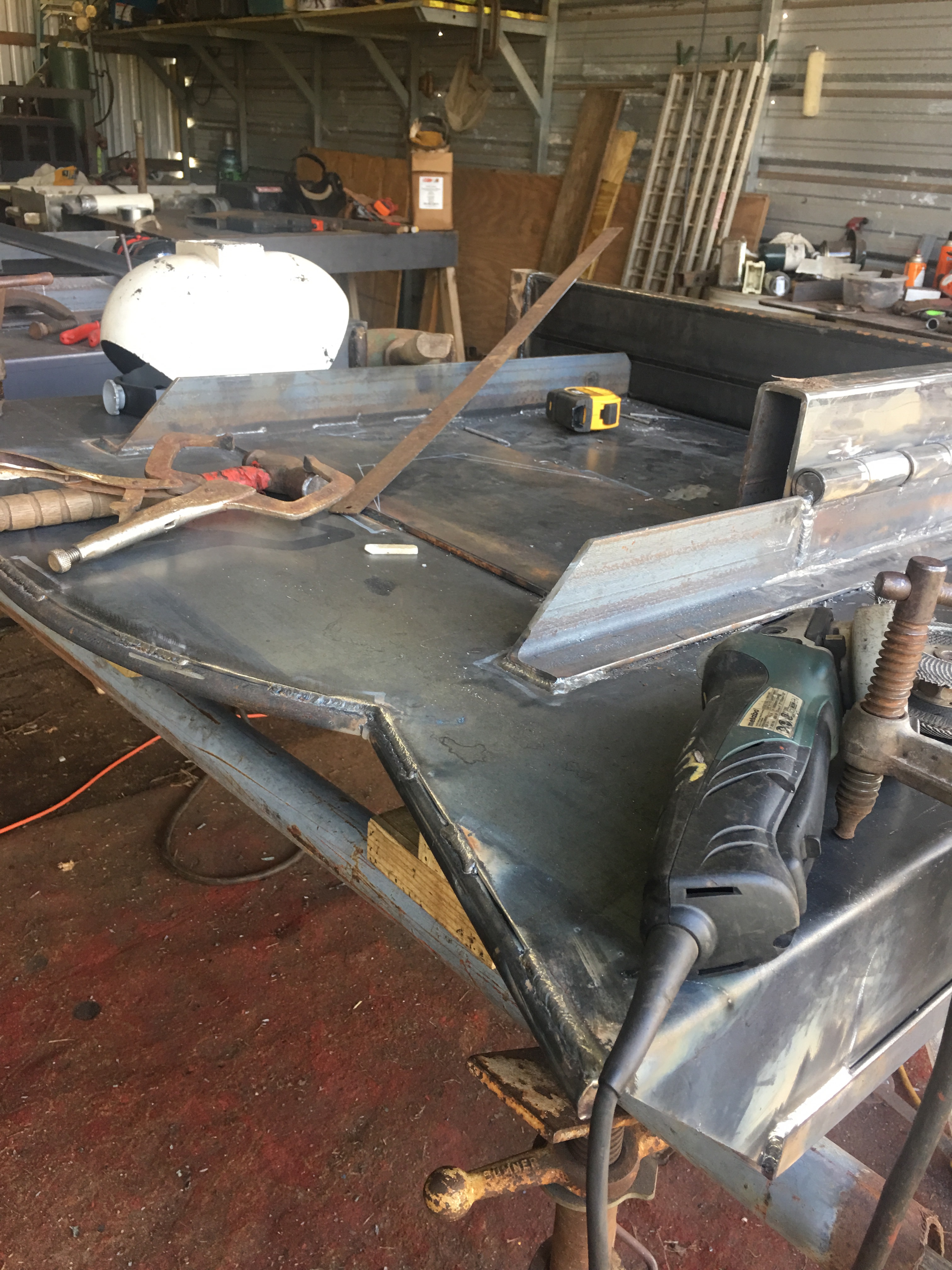

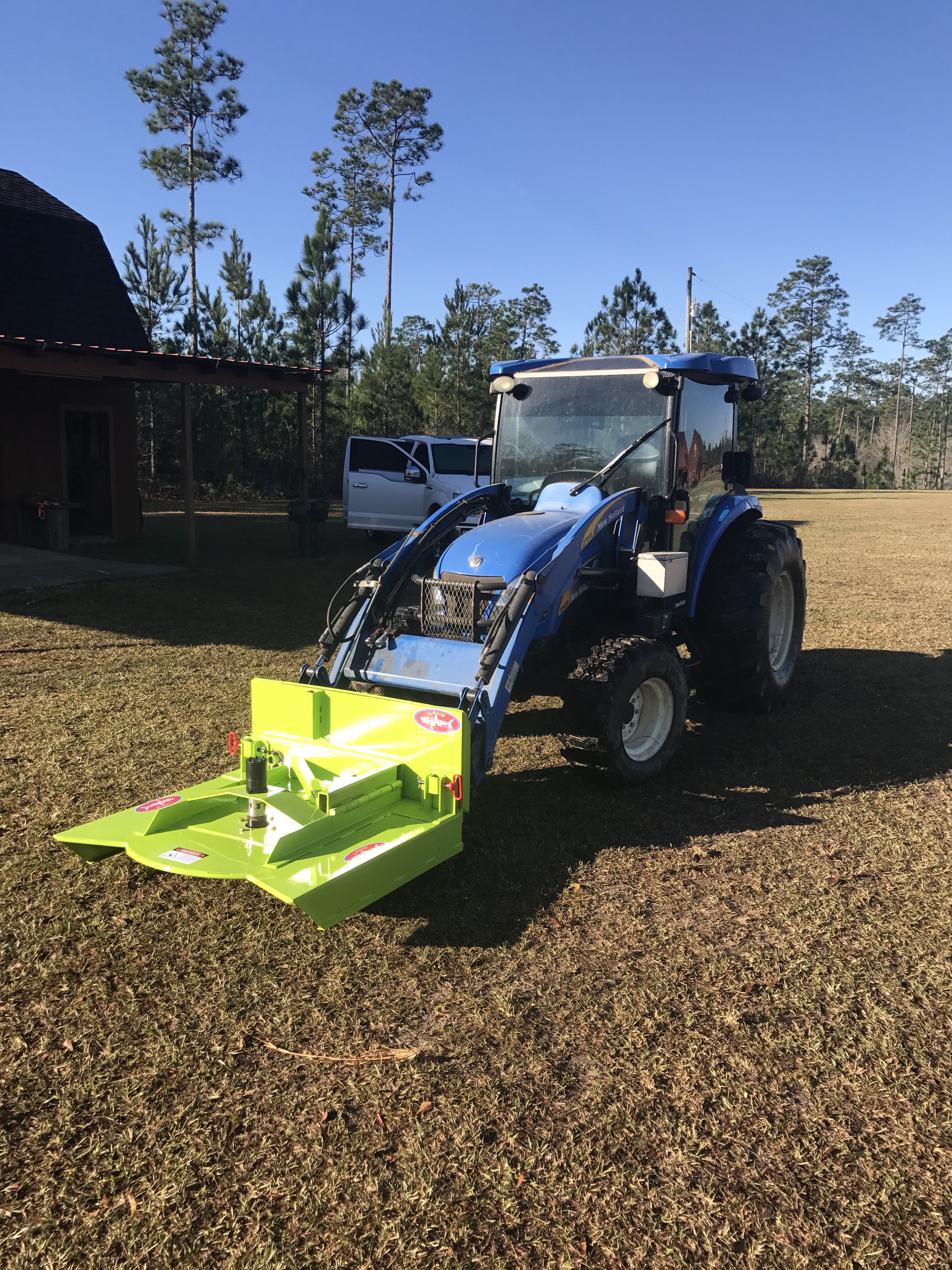

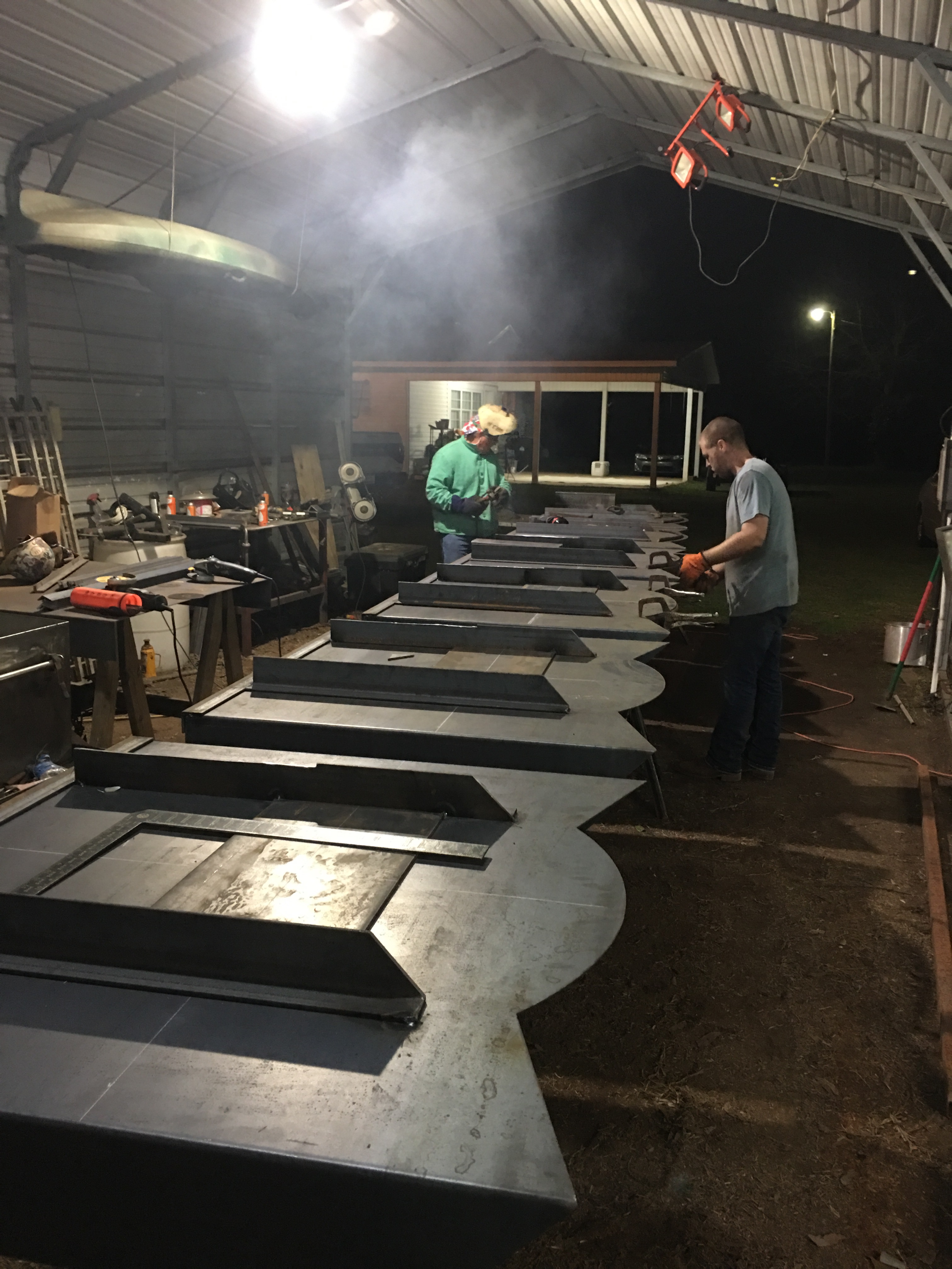

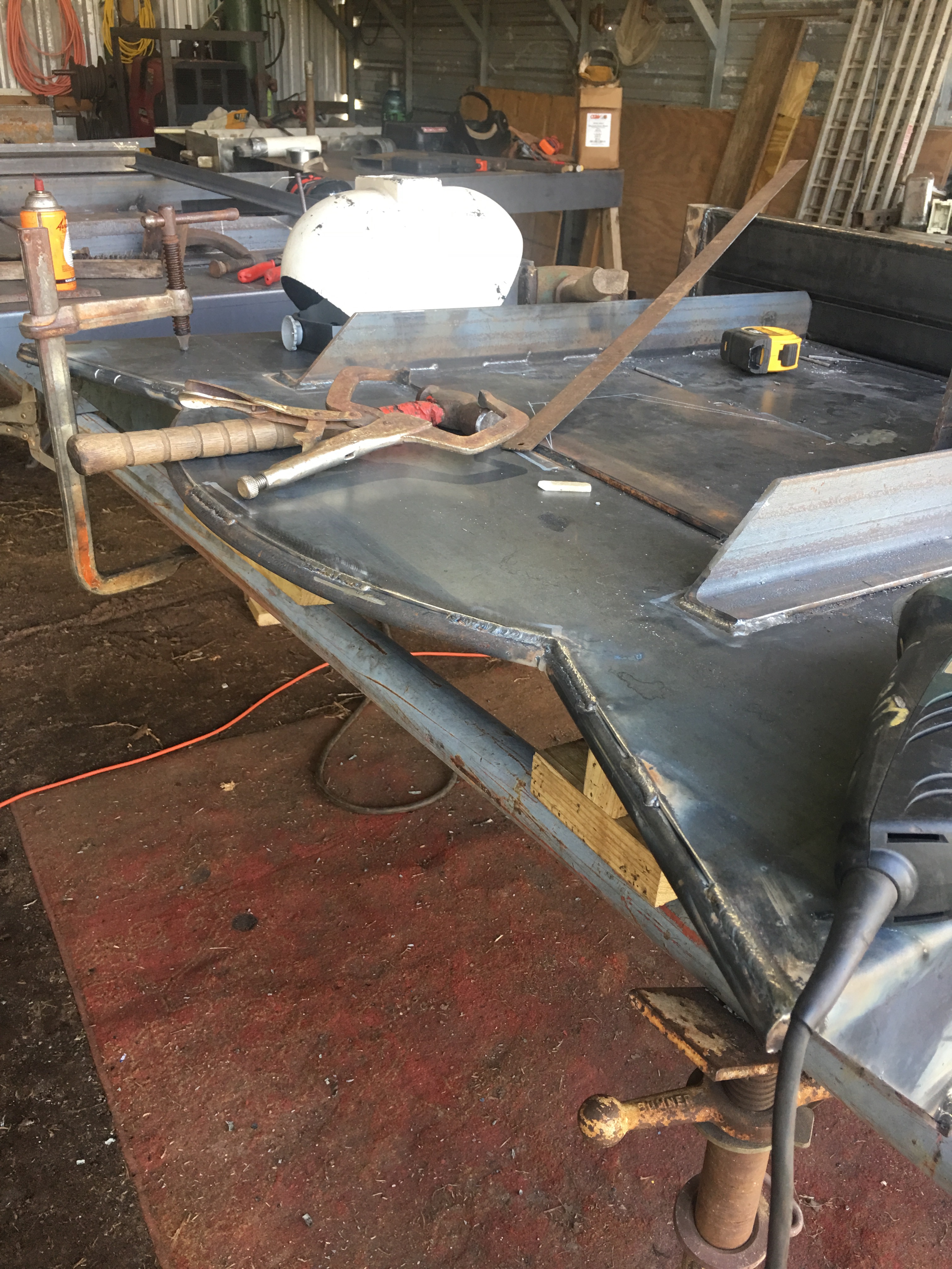

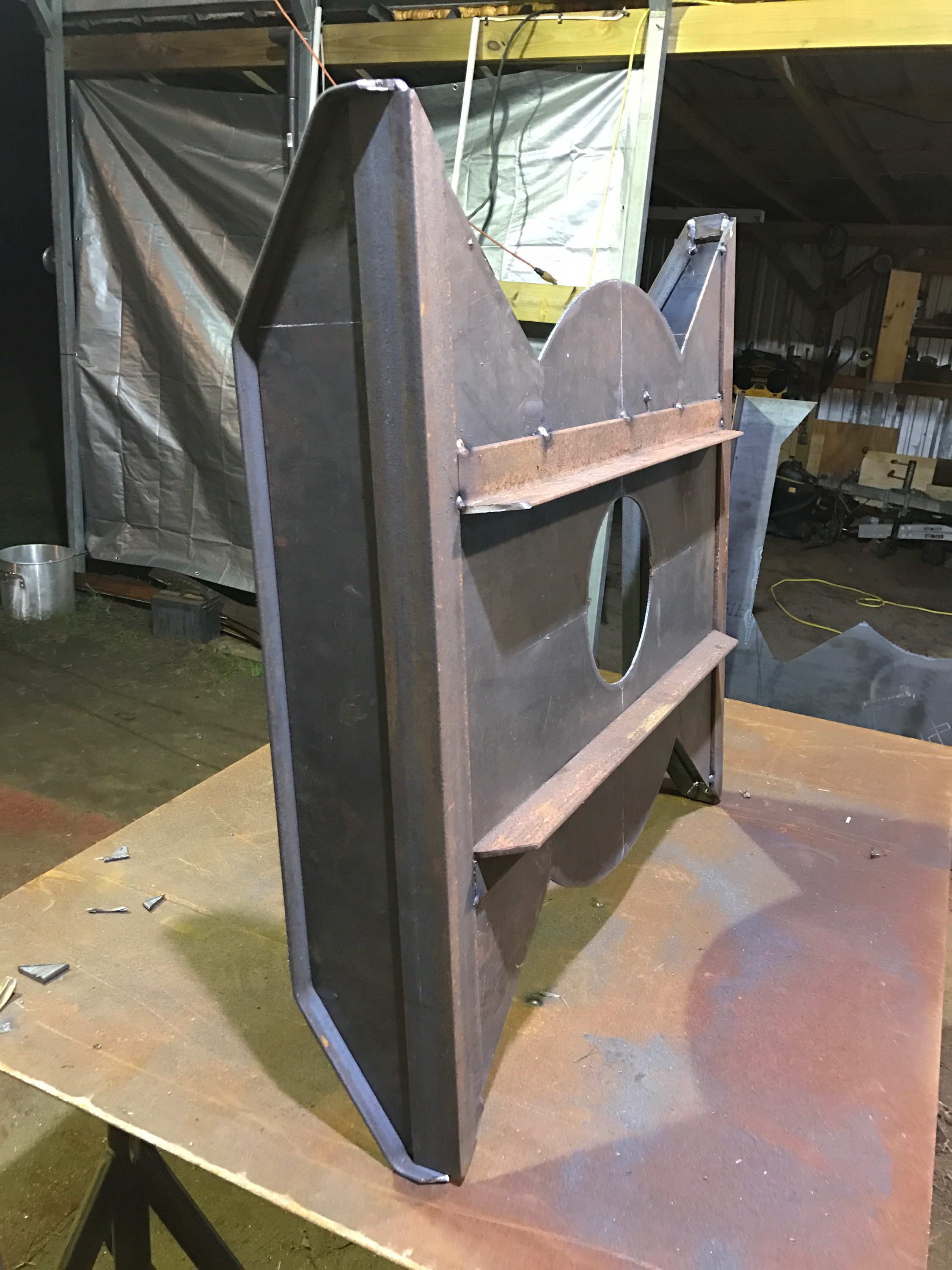

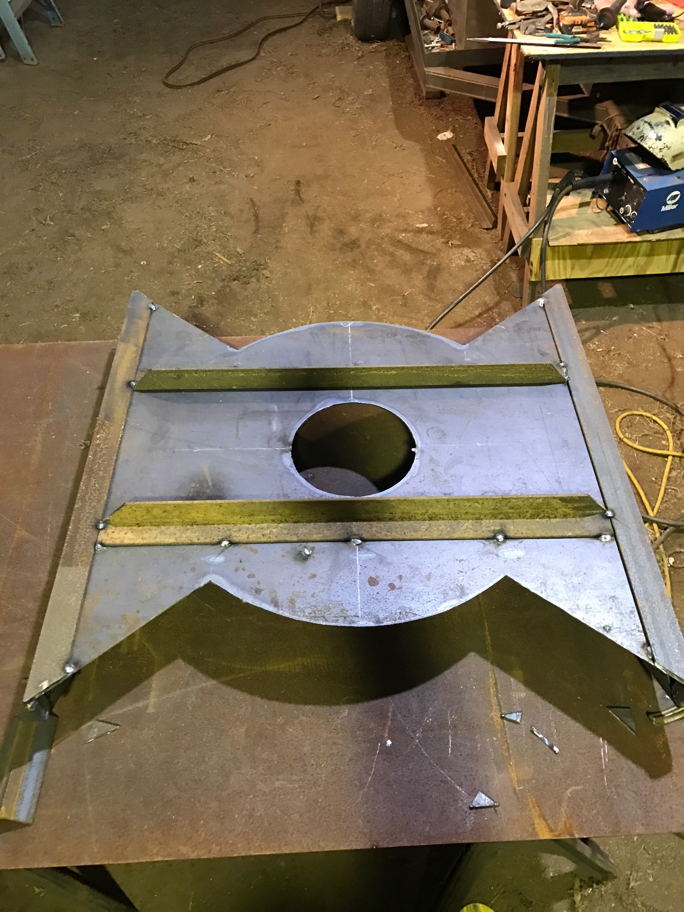

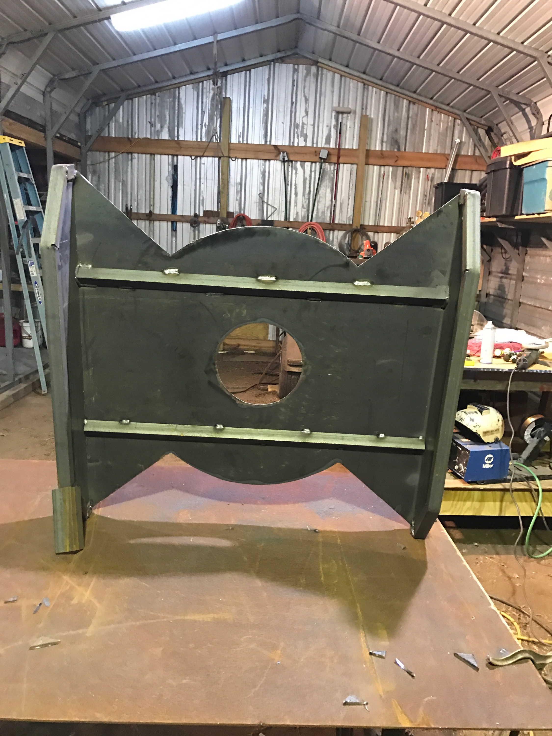

Thanks! Here is a sneak peak for you, feedback both positive or negative welcomed.
   / FEL Road Maintenance Cutter #55

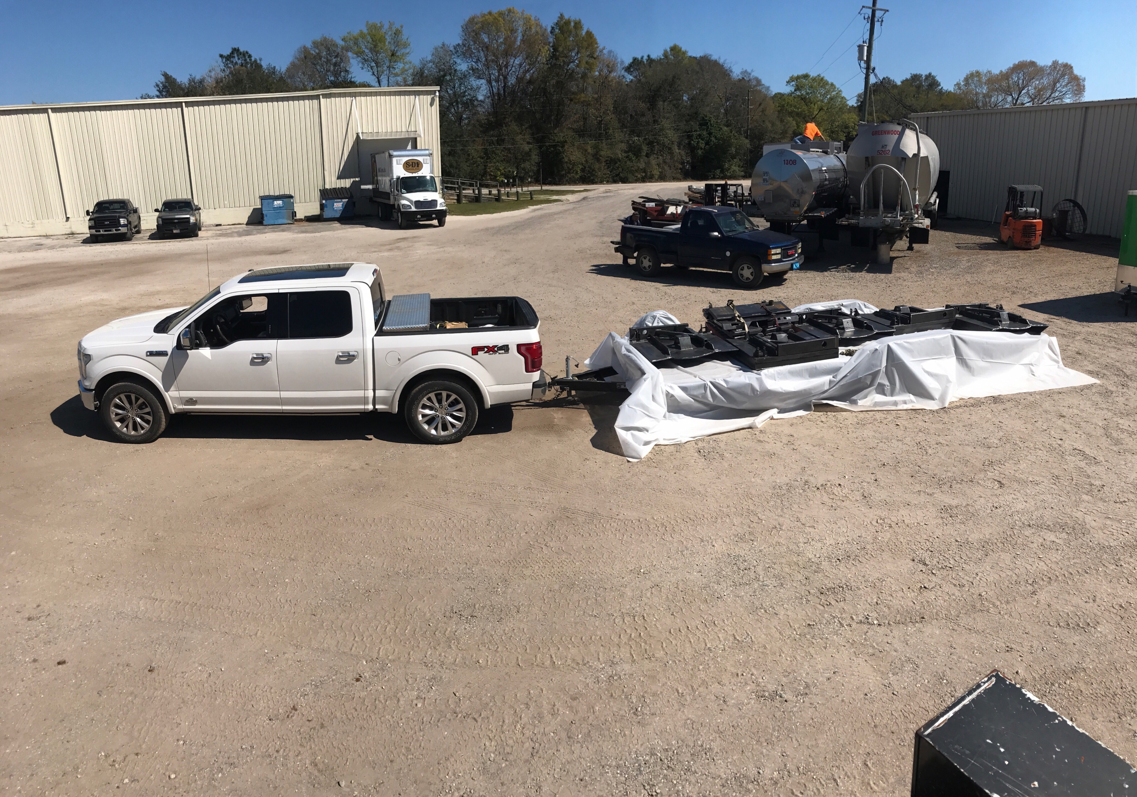

Also I should have included we made some minor changes with some great curb appeal to our LS2 model with the SSQA, unfortunately this did increase the manufacturing cost therefore increased our prices a few hundred dollars.
The last picture are of the six we built this week.
   / FEL Road Maintenance Cutter #56
Good design and looks like a great start! Do you have any guess on the weight yet? What is the rough size?
