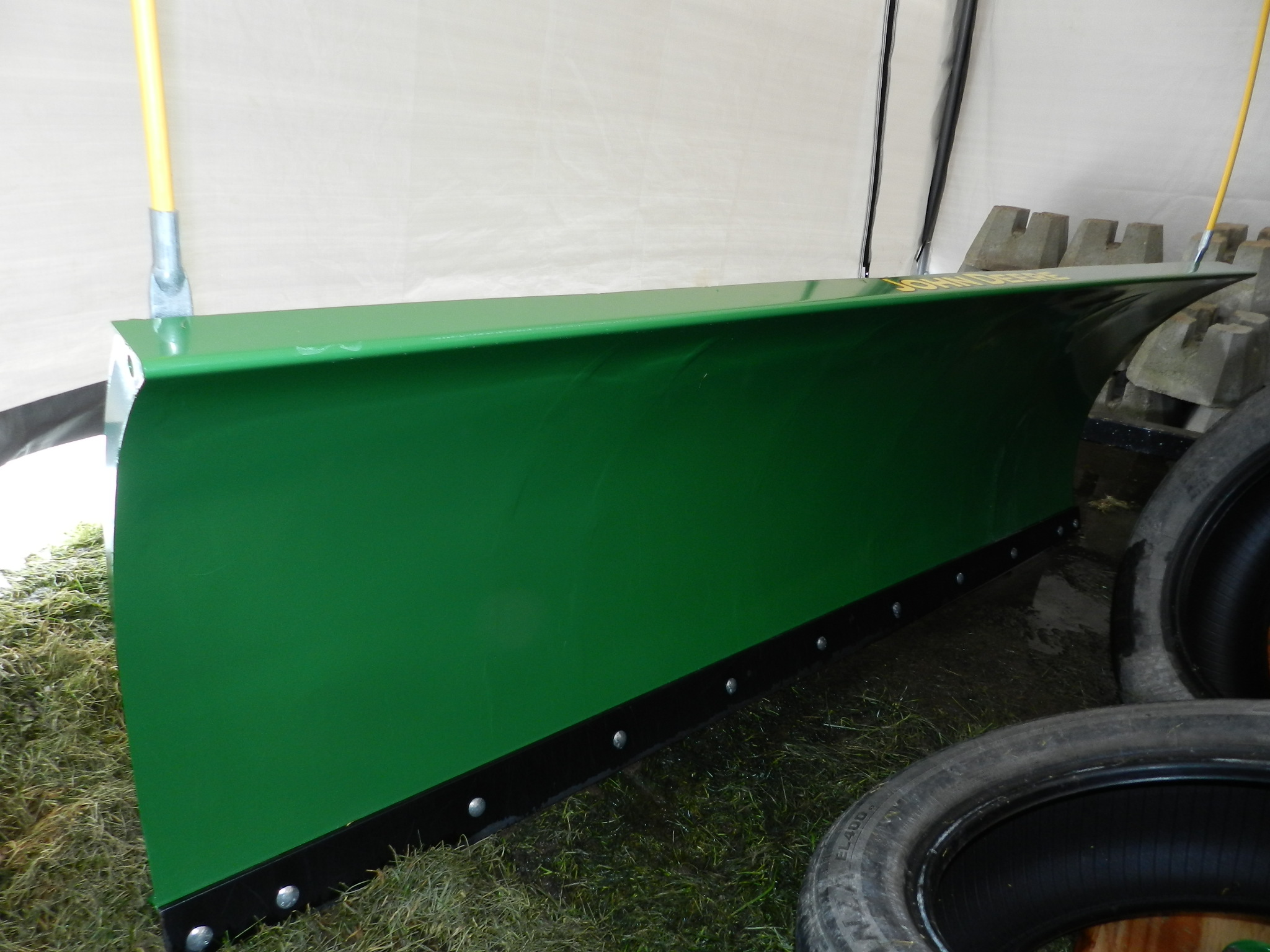

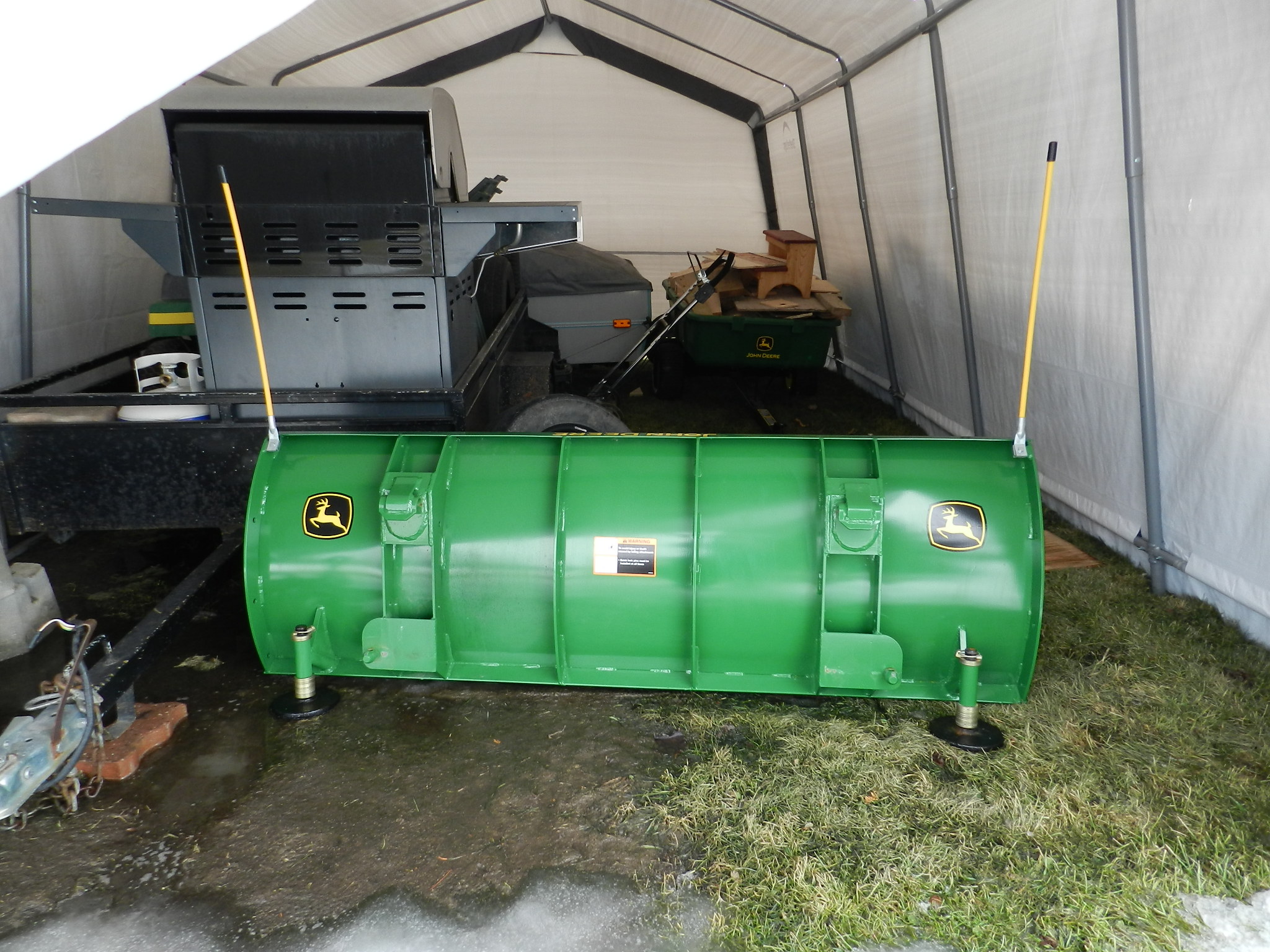

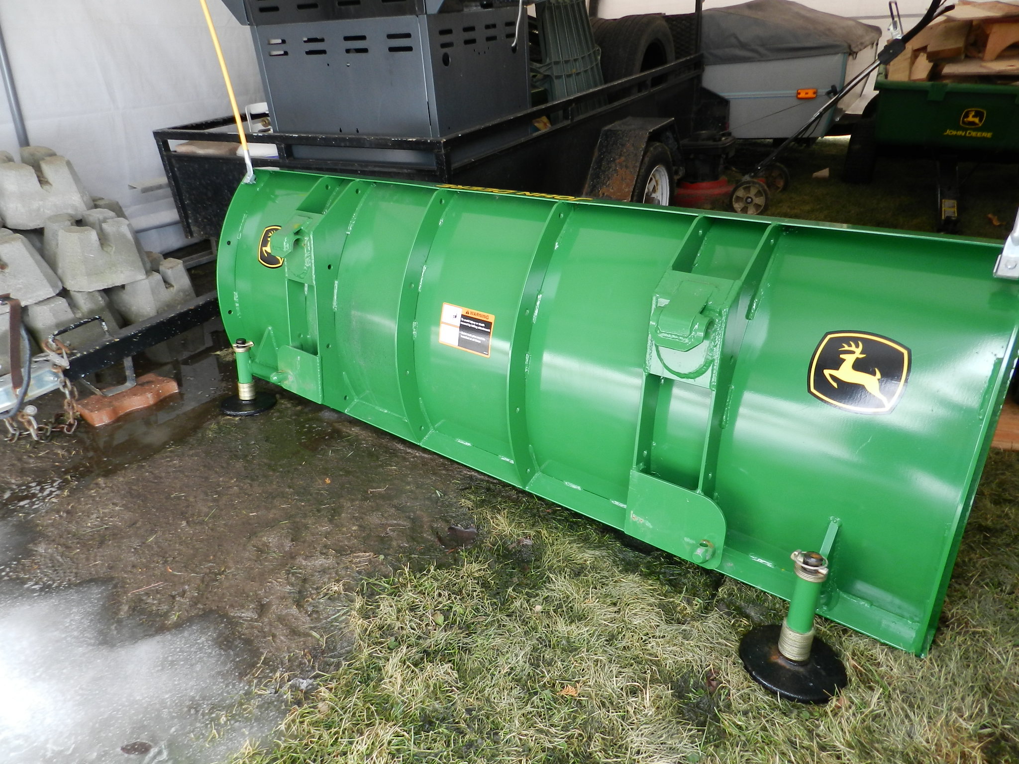

Sorry I haven't posted anything sooner. Here are a couple pics of the finnished blade. I will try to get more posted while mounted on the loader when my yard dries up a little. I pretty much got a soaker walking to the cover-all to take the pics.
   / FEL Snow Blade Build #45
Wow, that is a excellent looking blade. Well done. Have you had an opertunity to try it out.
#46
I've actually have been using it for the last two years. Works awesome... I was thinking of putting small sides on it to help it float a little better. It tends to want to dig into my laneway. I was also going to weld a pipe on the cutting edge which should solve the problem. Thanks for the complements.
   / FEL Snow Blade Build #47
Did you have someone roll the steel for the blade
   / FEL Snow Blade Build #49
Wow, that is really slick! Did you end up having any problems moving snow without angles and all that?
Also, is it really much different from just using the bucket?
   / FEL Snow Blade Build #50
I built a plow for mine that angles. I found that I hardly ever had a need to angle it. I am seriously thinking about doing something similar Nyen0004's setup but adding wings to the end.
