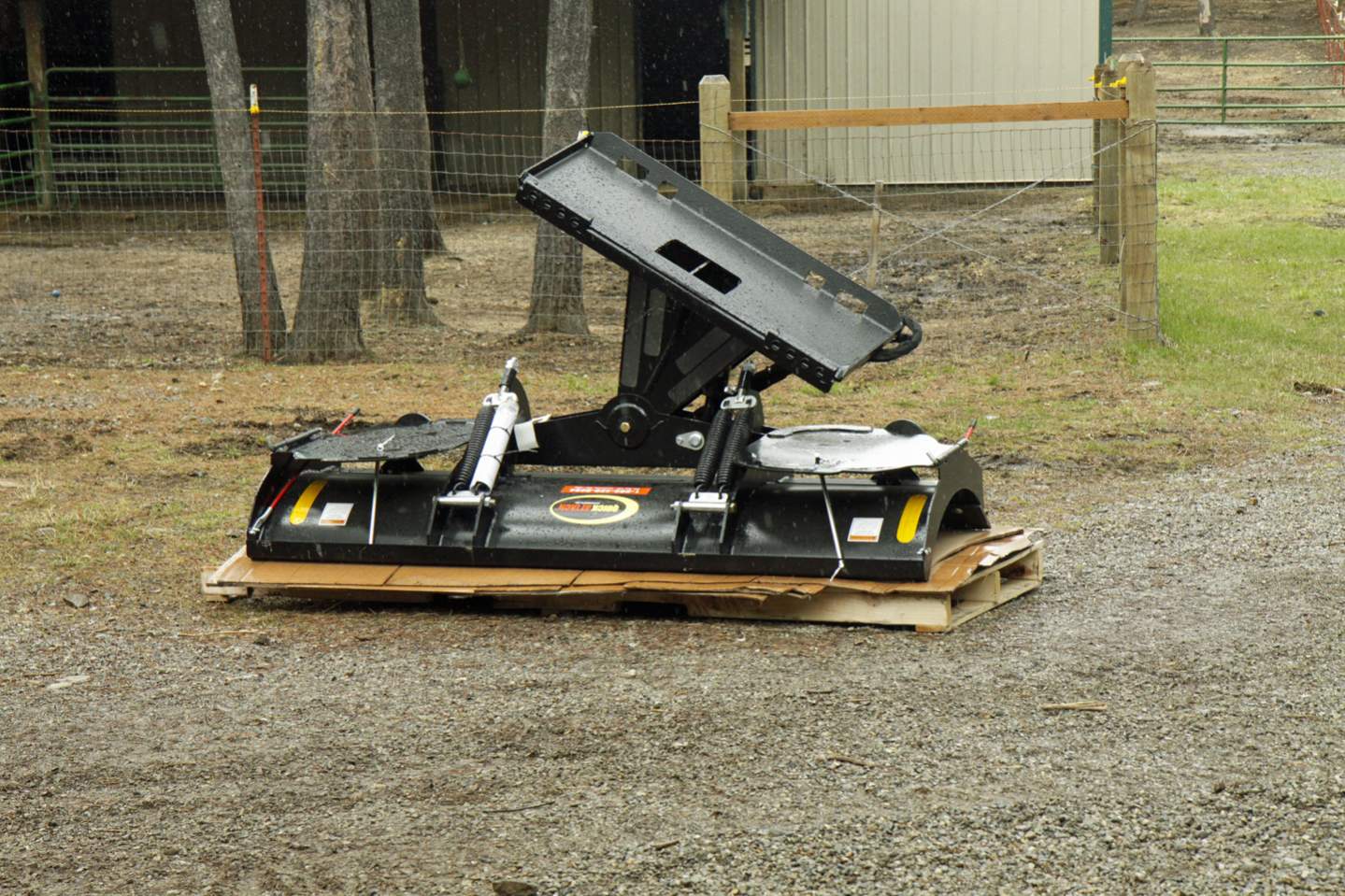

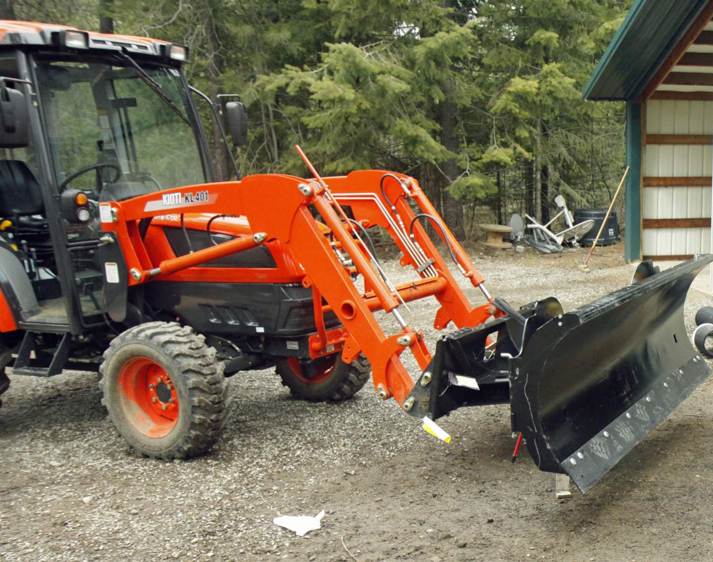

it has the hydraulic angle adjust and a right and a left snow gate. Hardened shoes. Im all ready for the snow.... but really dont want to see it yet. too early
