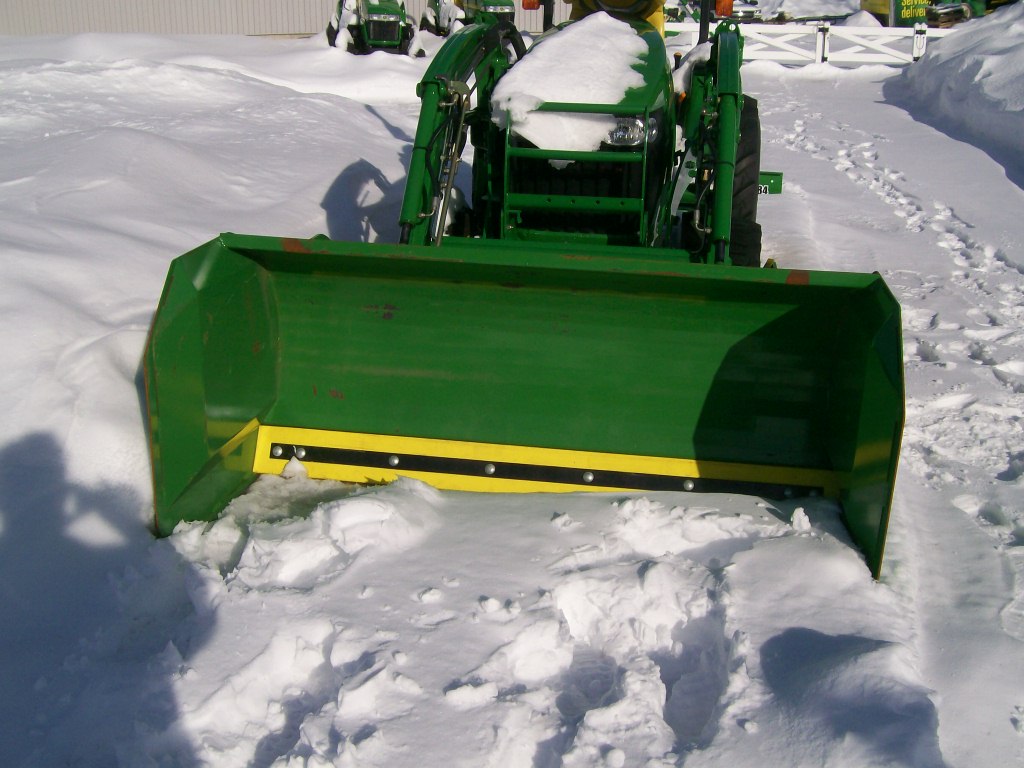

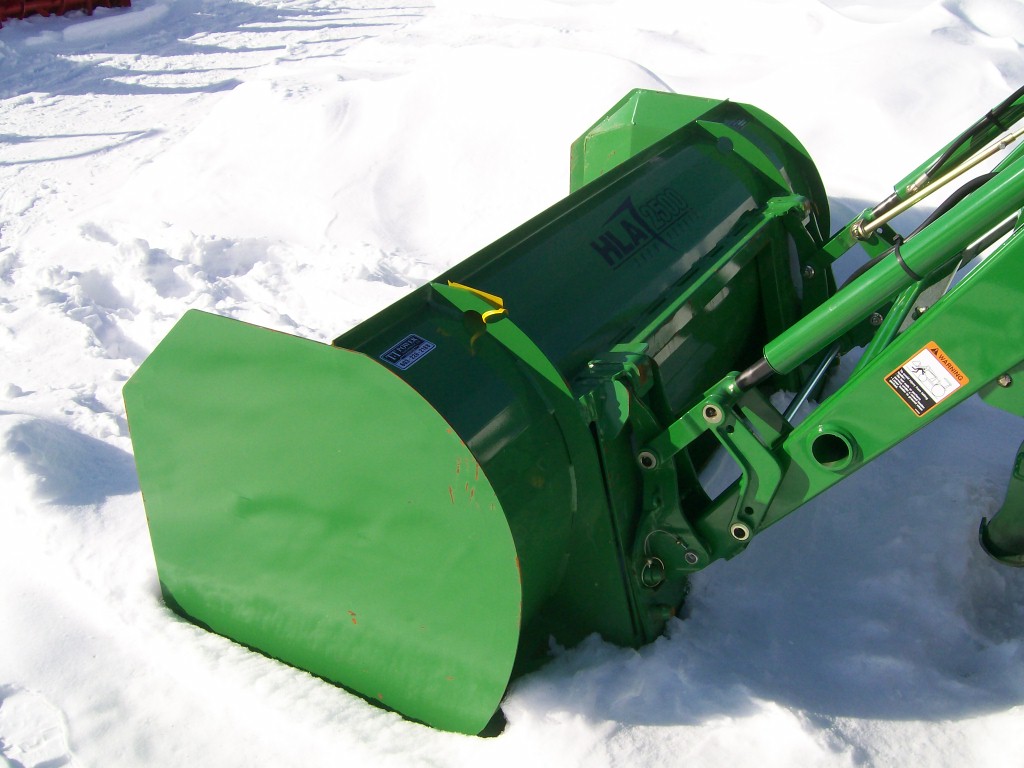

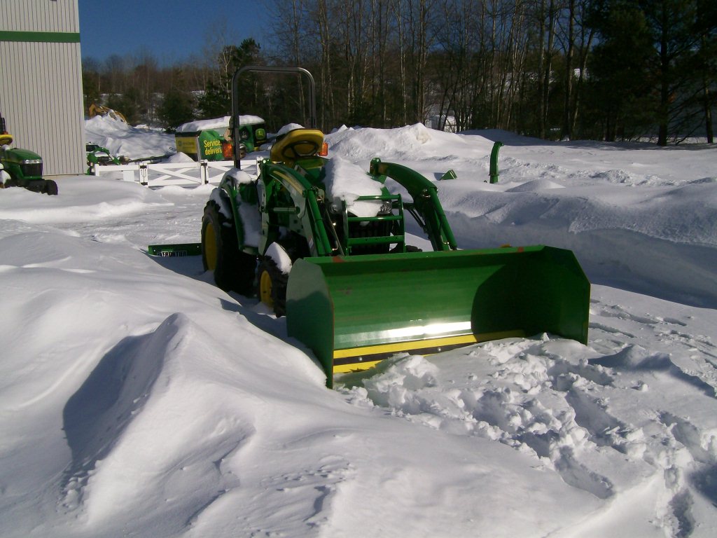

Here is another option that I saw mounted on a 3120 while riding around today...
