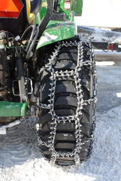

These chains turned my 3520 from a helpless cripple to unstoppable on our rather steep driveway. Without chains there were days I couldn't get up it with the tractor, but did it no problem with my ancient Ford Explorer. I have the larger version of the R4s, so clearance is really tight and I need to use a few zip ties to keep the loose ends close to the tires. NorthMainer...rim guard in my tires is a bit over 700 lbs each; yours can't be that much less with standard R4's??
