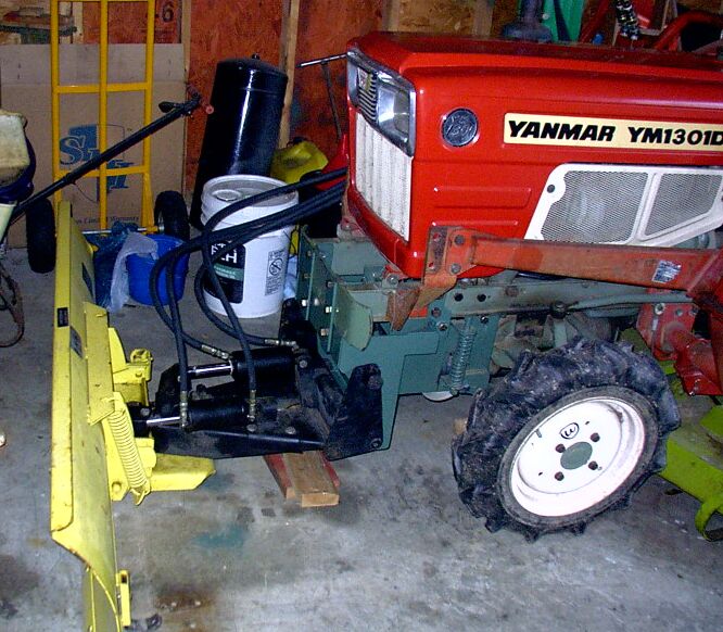

mhalla,
Take a look at this thread where I describe how I mounted a JD 54" hydraulic front blade to my Yanmar YM1301D tractor. I also have some information on my web page.
No snow yet this year - more like 55 deg F and raining today. Figures, I guess its because I now have insurance - see attached photo.

   / FEL Snowplow #54
gbirky
Had a look at your detailed pics. Kinda like the plow 'quick attach' setup.
Noted that your geometry gives you a fairly 'straightline' push.
Do you find that you have adaquate steering control?
The answer interests me as my MT180D is about in the same size catagory as your Yanmar.
I have been thinking of adding mounting so as to be able to use my truck blade on the Mitsubishi in case I need to have a backup.(I have snapped the odd axle on the truck from time to time)
Mind you the truck blade is 8' wide and the Mitshubishi only 4' wide. Might be a bit of overkill for the MT.
I might attempt a jurry rigging for a fast test just to see if all I do is spin the wheels.
Might work as I have chains and rear tires are filled as well as a 5ft blower mounted on the 3pt.
   / FEL Snowplow #55
The blade is from a JD317 which my Dad owns. I took a look at the 317 mounting height and just recreated it with the mounting bracket for my YM1301D. So it should perform as is did on the 317. I just did all this work in the fall, and we haven't had a flake of snow yet (49 deg F and raining today). The only thing I have done is to use it as a dozer blade in some loose dirt I had tilled up. It seemed to work quite well for that. I'll let you know how it works in snow once I have tried it out.
