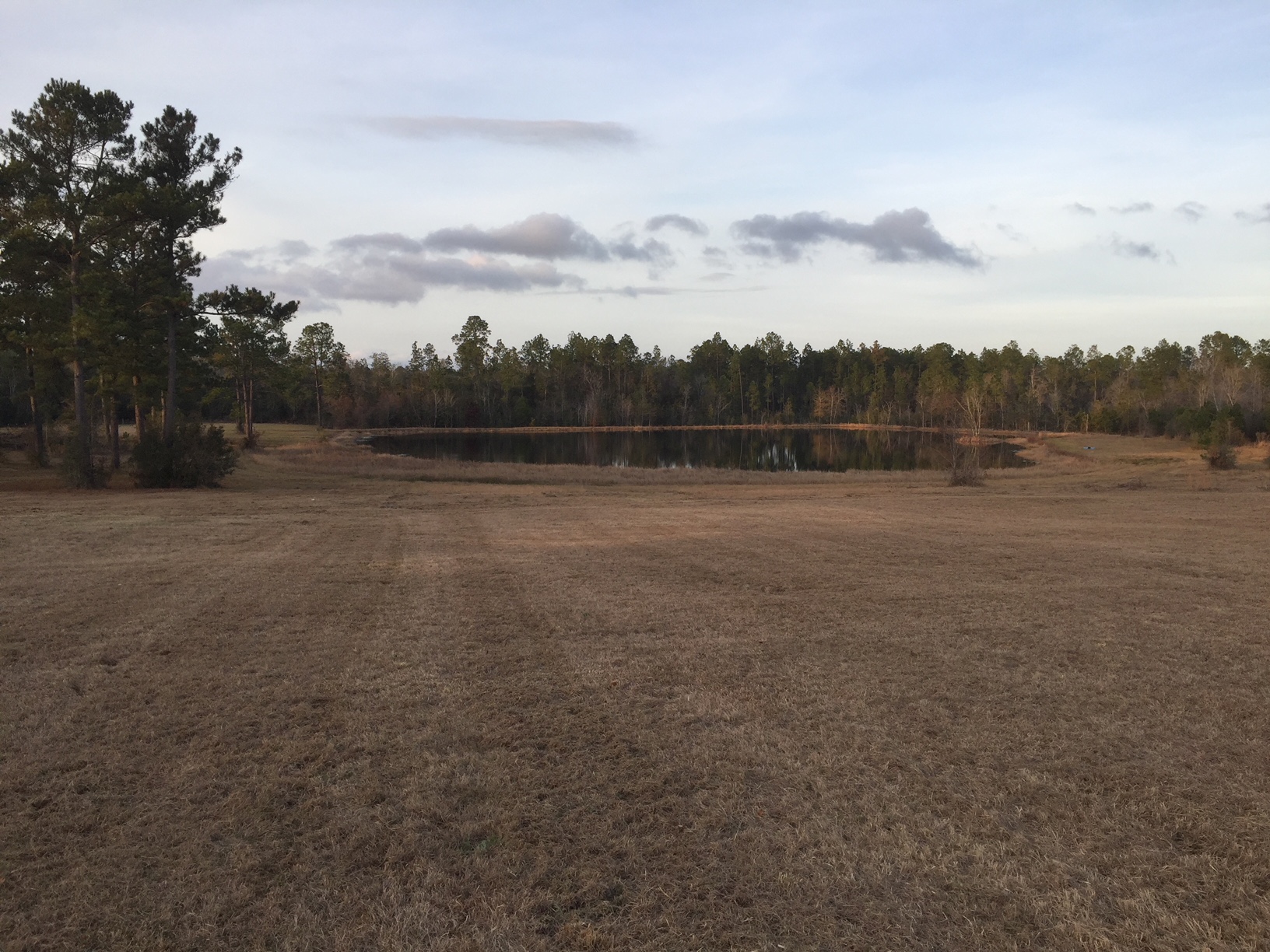

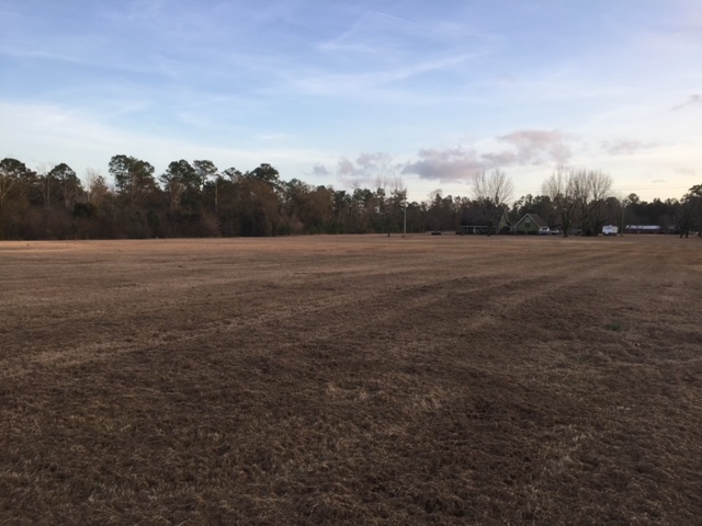

Looking at your land it would seem any would do.
Generally a "standard" tooth bar, such as Tractor Bucket Bolt on Tooth Bar will be great for rocky soil and grubbing out stuff.
A Pirahna is great for using when you have a lot of vegetation and few rocks. I had to clear about a 1/4 acre of grown over mess, a mixture of small saplings thorn bushes, brambles etc. using my M4700. When I got the Piranha bar put on it made it much easier. I could set the bucket so it cut just below the surface of the soil and push forward cutting stuff.
Then there are advocates of a ratchet rake.
But remember you have a FRONT END LOADER, not a front end dozer. If you have compacted soil or lots of rocks or heavy clay it's best to break it up with another implement before you try and move it. Many people have posted about bending their cylinders because they rammed into something they wanted to move.
