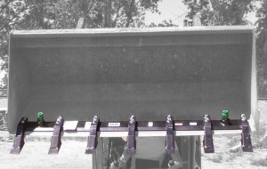

I purchased a removable tooth bar. It clamps onto the bucket and is easy to remove. It does a great job, far better than it does without the teeth. I purchased mine through Toothbar.net. They start around $239. Teeth are replaceable if broken. I have yet to break one.PIC_3369-300x190.jpg

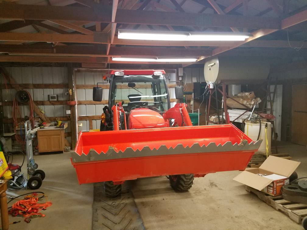

BXpanded Piranha toothbar. I bought one in 2014, put it on, and it's never been off.
Besides all the obviosu uses already mentioned here, I like using mine to cut through the bottom of my gravel road potholes just prior to my EA 8' grader blade smoothing the road over. With pot holes, it's not enough to just fill them in, they'll just reappear again as soon as someone rolls over it. You have to dig down tot he bottom of it and remove the compacted bottom. The BXpanded piranha tooth bar is excellent for this.
Good luck!

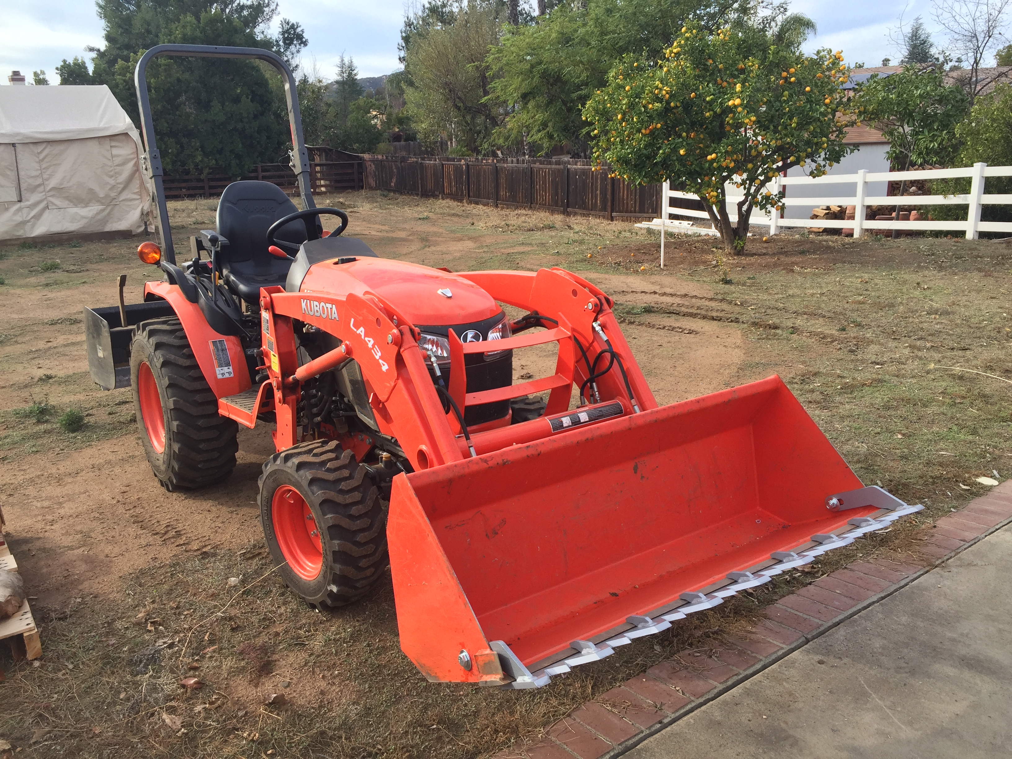

X 2 in the Piranha Toothbar. It is a really big help when digging into piles of dirt that have rocks in them. And yes, it is good for digging down as well. I remove mine every Fall so I can put on the bxpanded.com Bucket Expander, which allows me to carry twice as much snow in my FEL. But now that Spring is here, off comes the bucket expander and back on goes the toothbar! Very easy switch. Just a couple of bolts.
