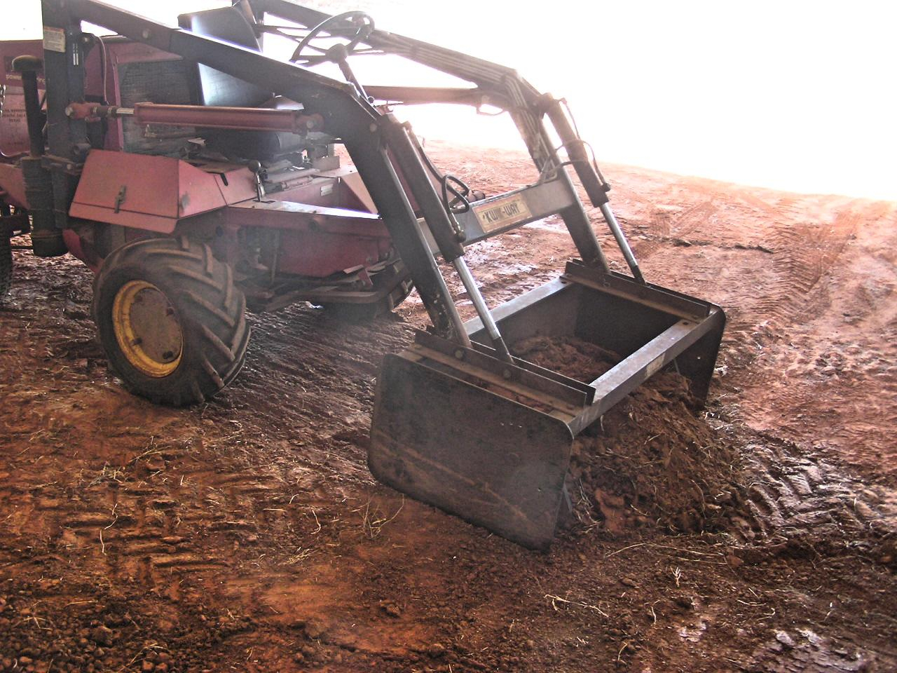

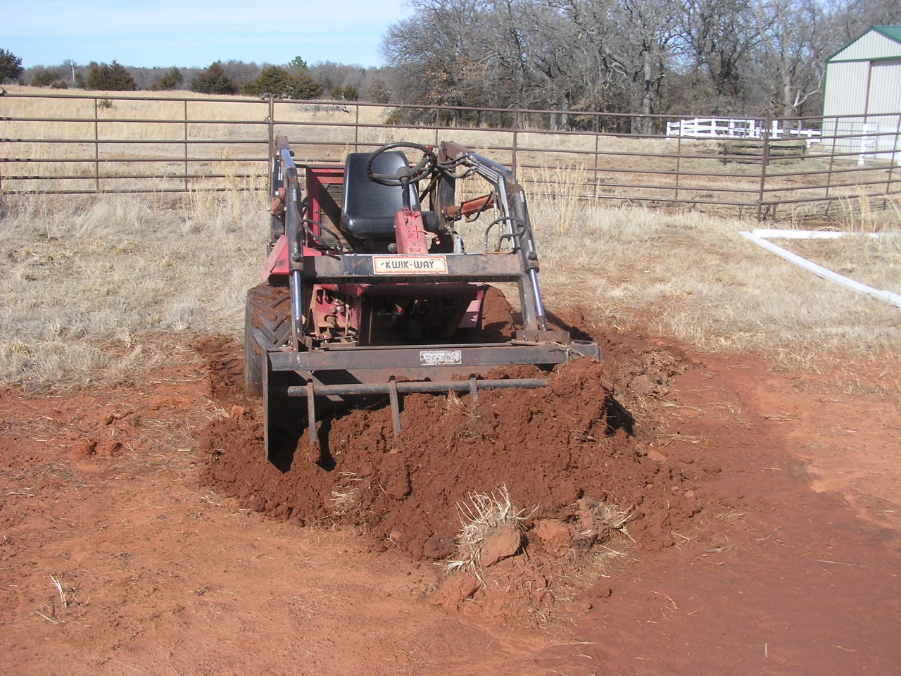

Some more pictures with the 4' box blade in the Push mode:
Leveling loose dirt dumped by the V417:
The view from the seat:

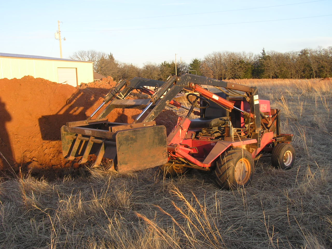

Got a request from MBTRAC to do a build thread on what is pictured in my Avatar. So here it is.

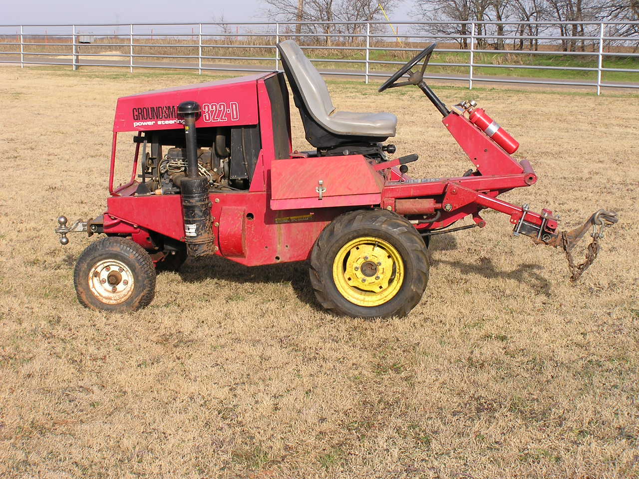

Started with this 1990 TORO Groundsmaster Traction Unit. It didn't have the rotary deck on it. Notice the seat is offset to the left, the decks are offset to the right to mow around trees like a zero turn.
View attachment 304875View attachment 304876View attachment 304877View attachment 304878
Got it in September, 2004, had just over 3,000 hours on the 3 cylinder, 22 horsepower Mitsubishi diesel engine.
It drives a hydrostatic transmission bolted to a Spicer automobile type axle rated at 1800 pounds.
Here is a better view of the axle (don't ask how I got it :D):
Changed the turf tires to ag type:

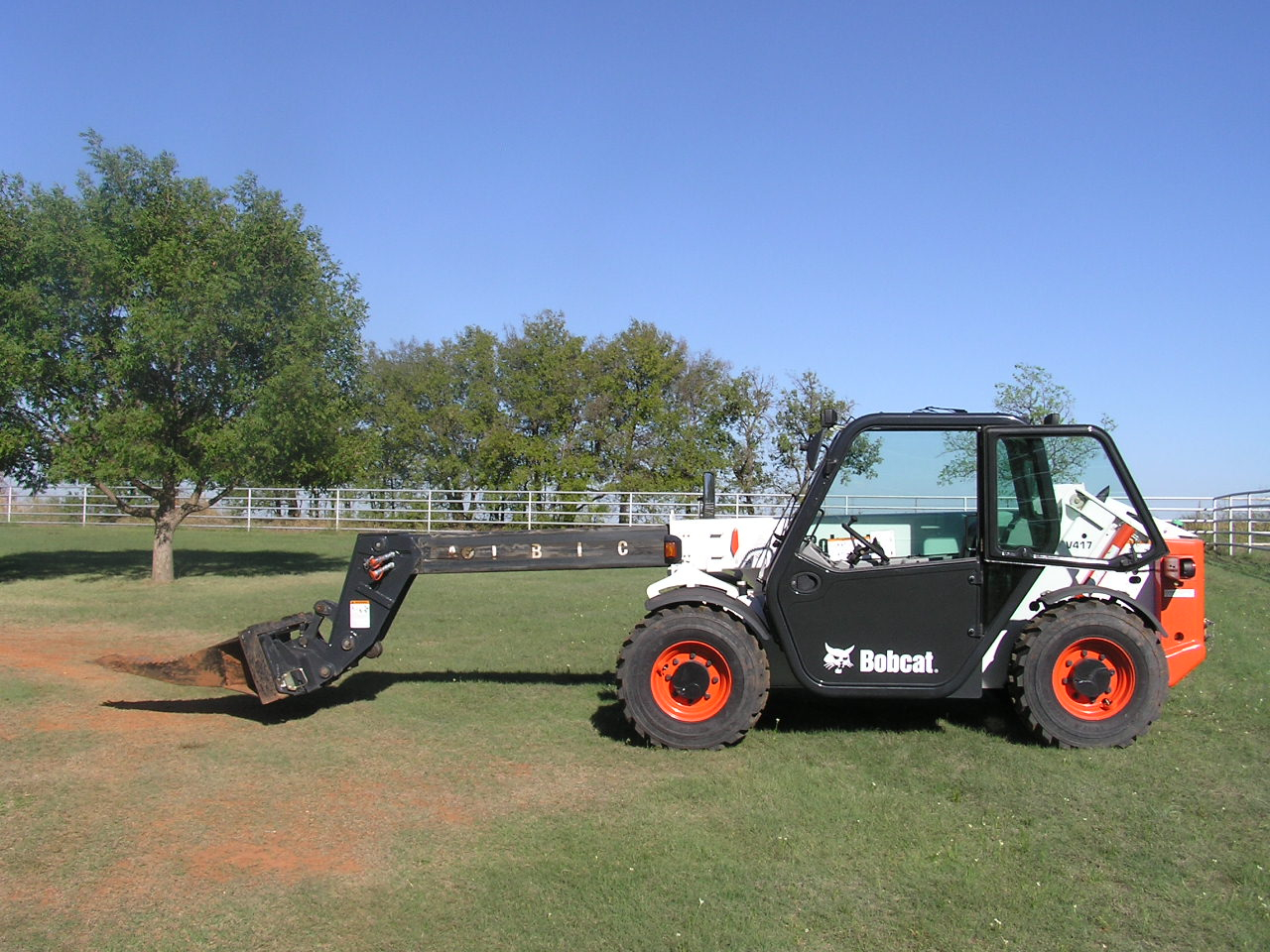

A mini sky trac would be like a mini version of my V417: Compact telehandler

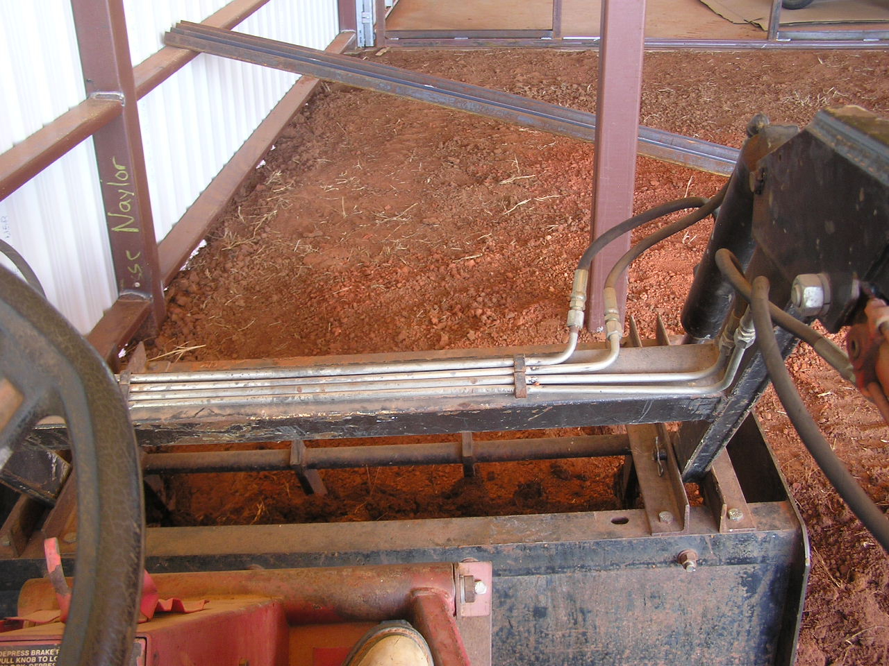

For those that haven't seen the springs they are visible in this picture:
Found a better view of the arms and springs:
