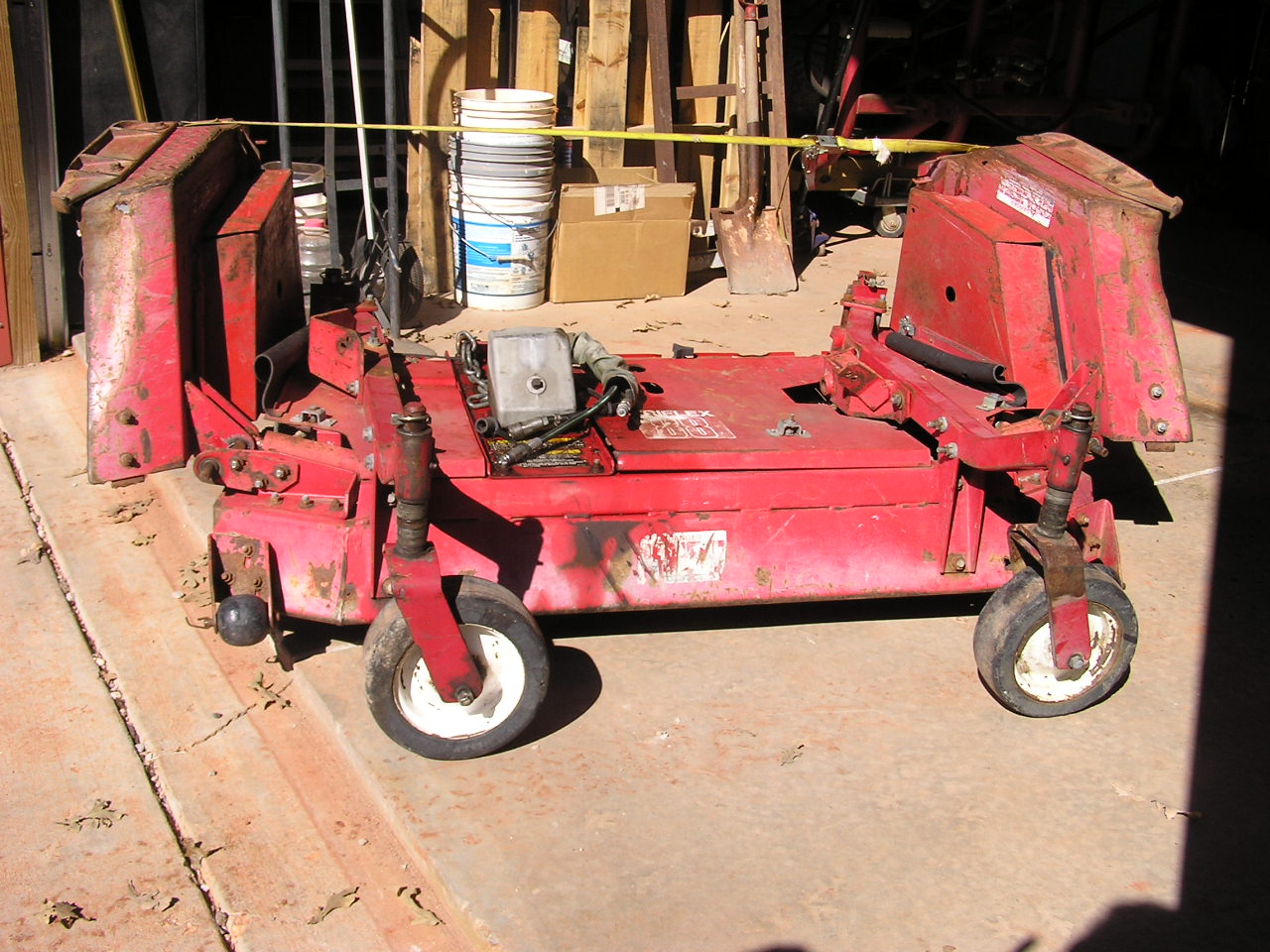

Your idea of lifting the deck with the loader looks good on paper, but you need to remove the deck, (read the manual first), drive the traction unit around, come back and put the deck back on. You might decide to make it strictly a loader.

I agree that the mower deck install/removal is a bit awkward. I've already done it a few times, just messing around. I've got it down to about a 10 minute task now. I live on 5+ acres of mostly hilly field grass. I mow about an acre of lawn around our home with my JD 318 on a weekly basis. I will be using the Toro with it's beast of a 72" deck to mow the field grass. It's picked clean of rocks, doesn't have brush, and only needs to be cut 2 or 3 x a season. The deck wheels adjust up to 6.5" cut, and the rear discharge should should have a pretty good flow of cuttings. It should work very well for that, and I don't mind doing the deck install a few times a year.

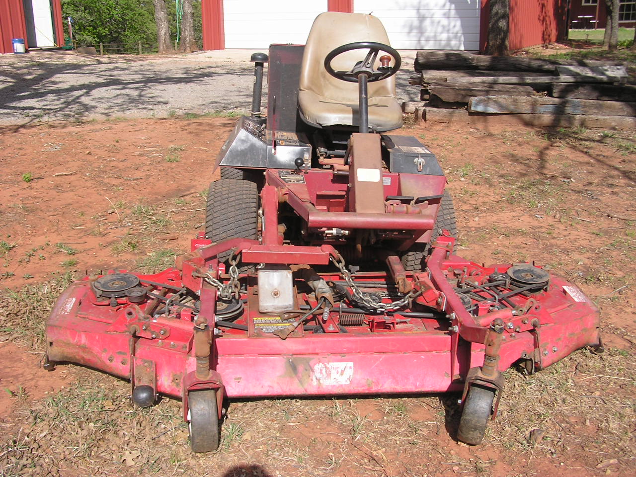

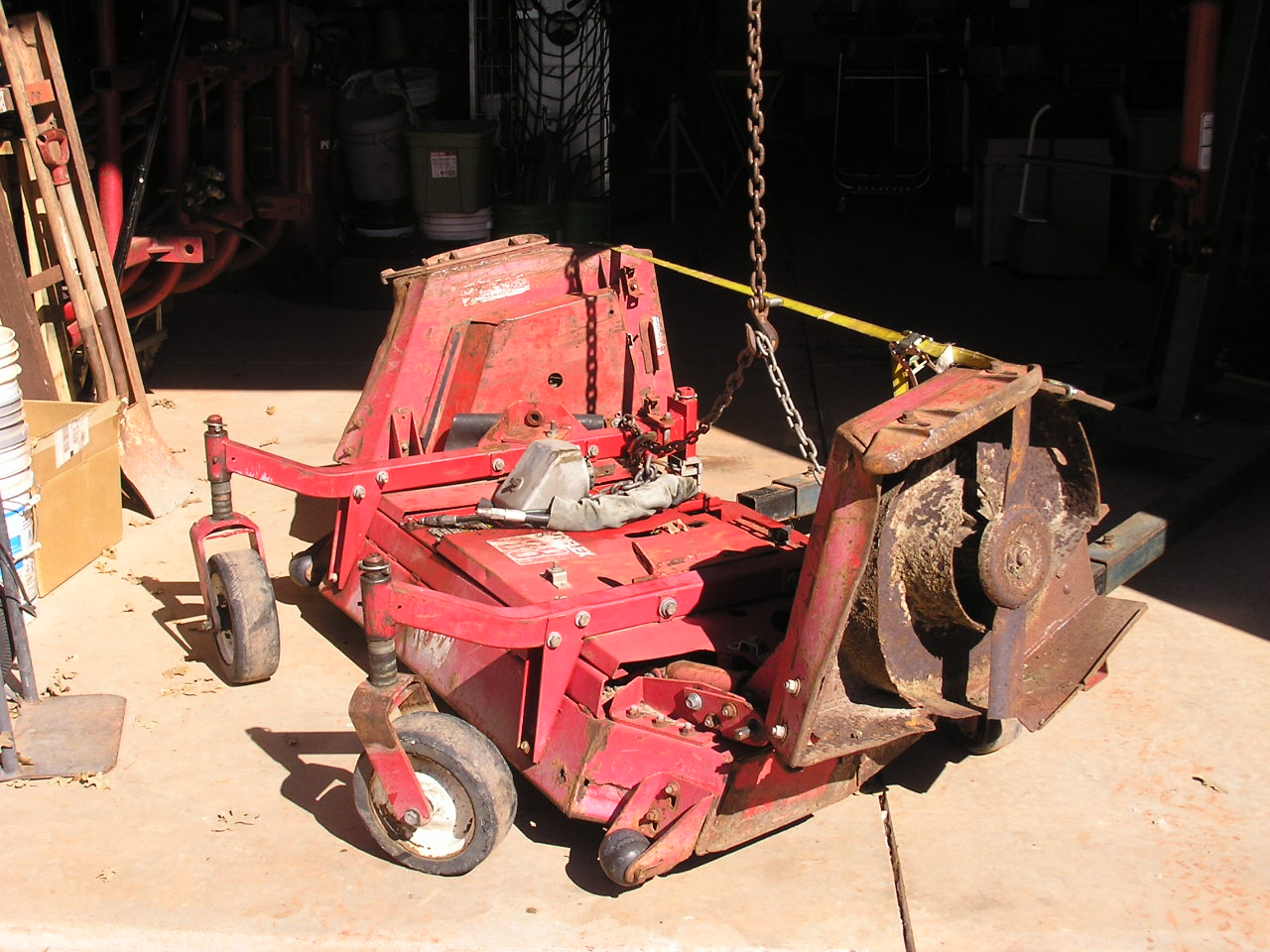

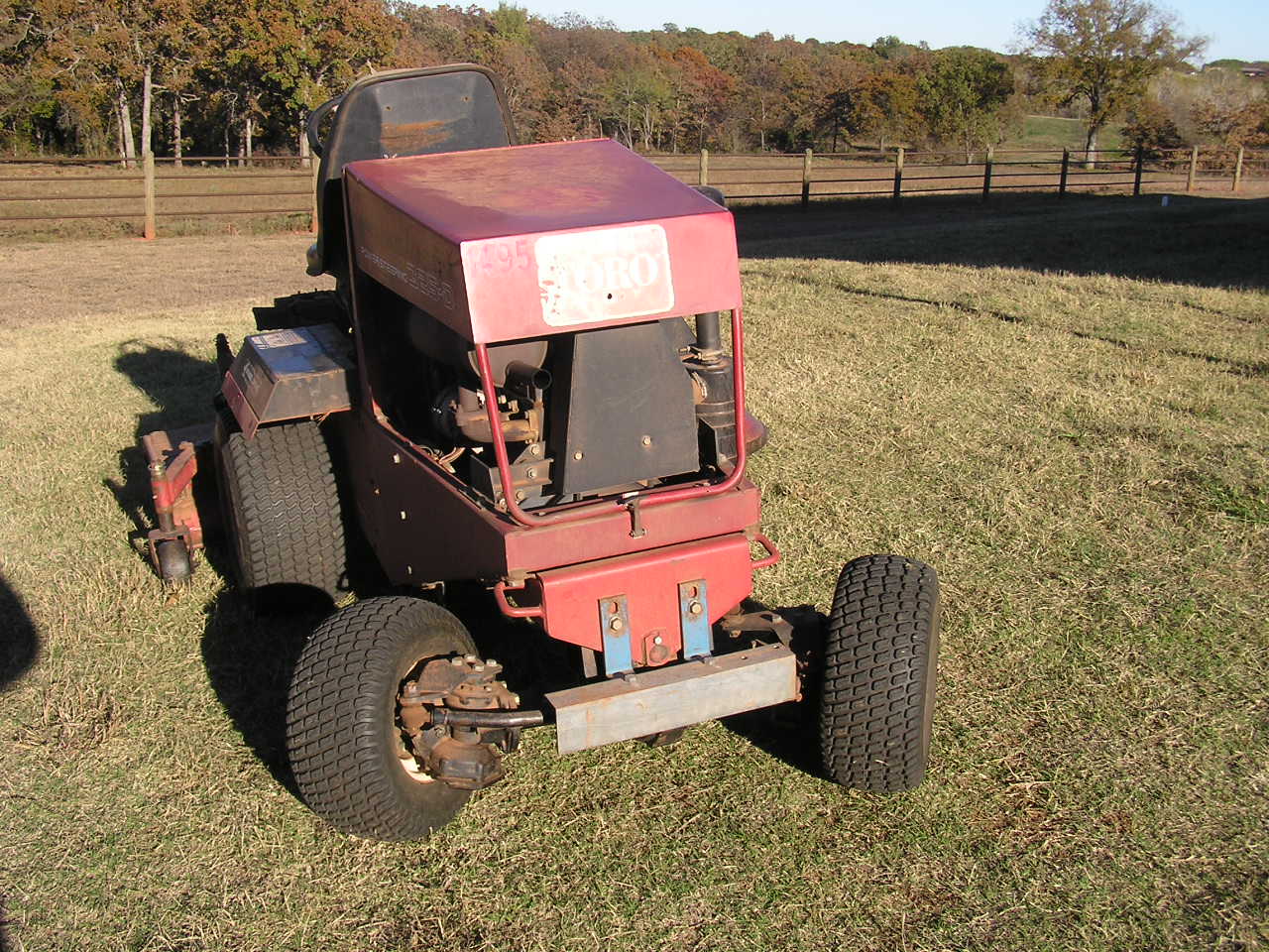

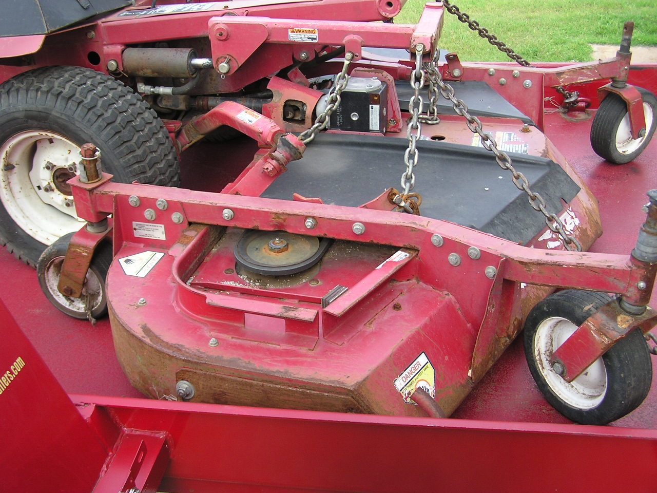

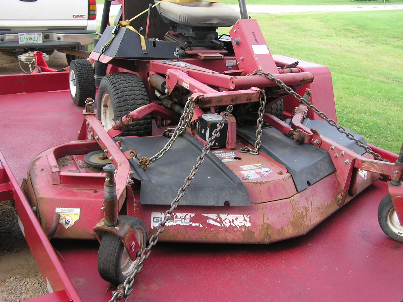

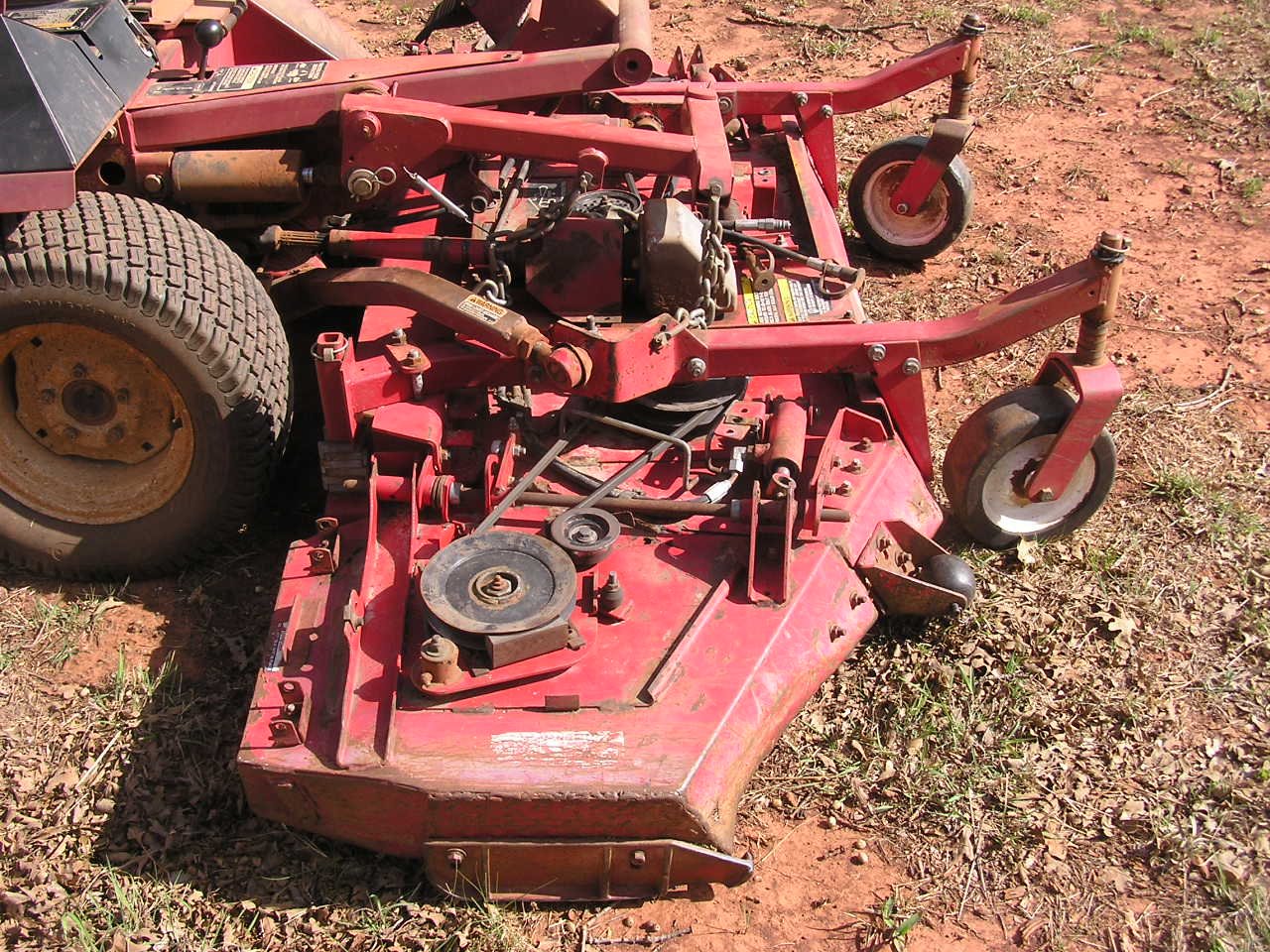

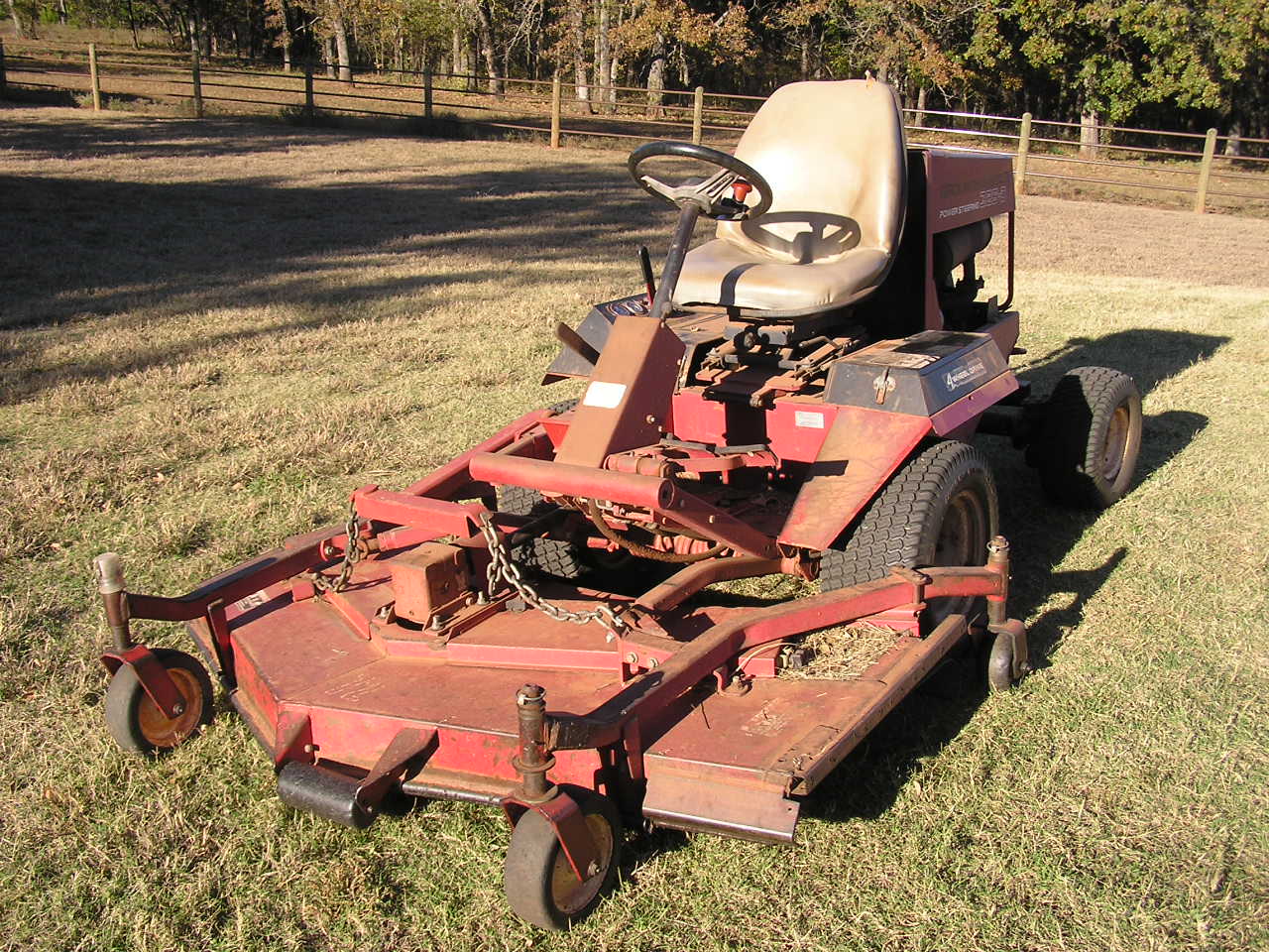

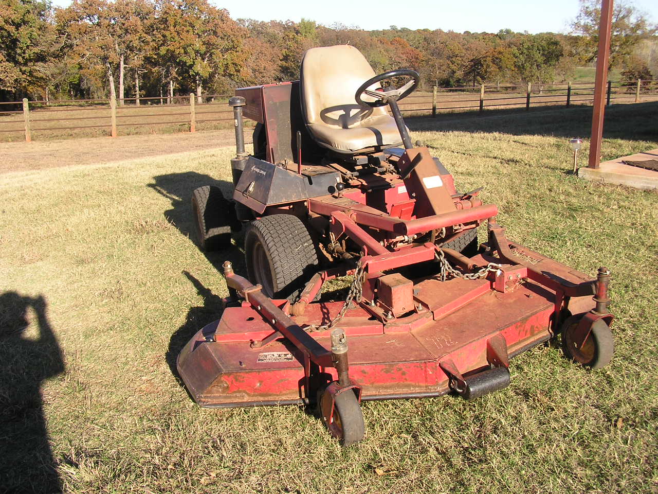

I got this 72" side discharge deck and a two wheel drive 325D back in May of 2005. Still using it on the 4WD now.

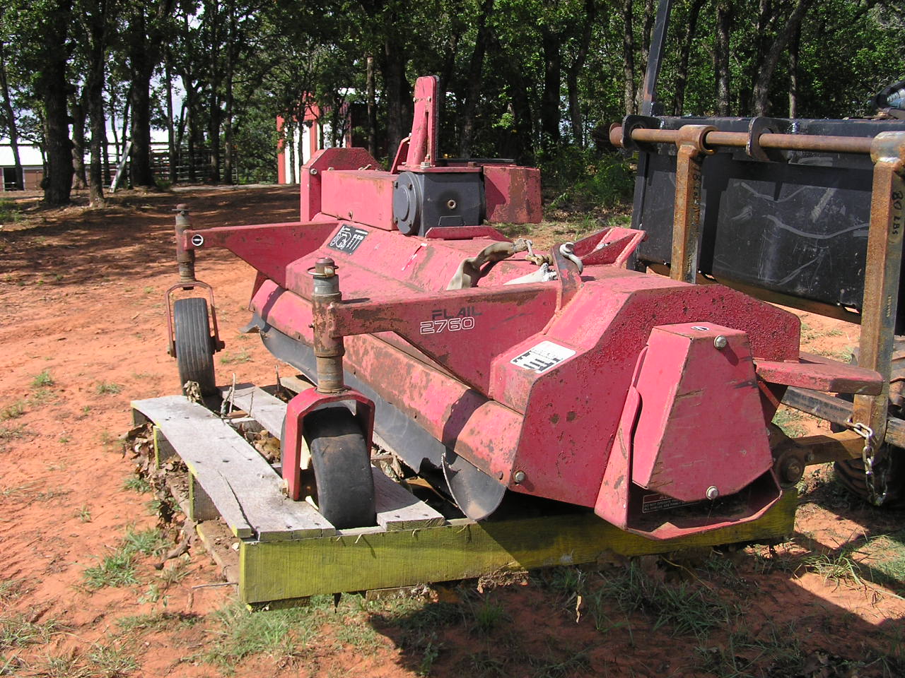

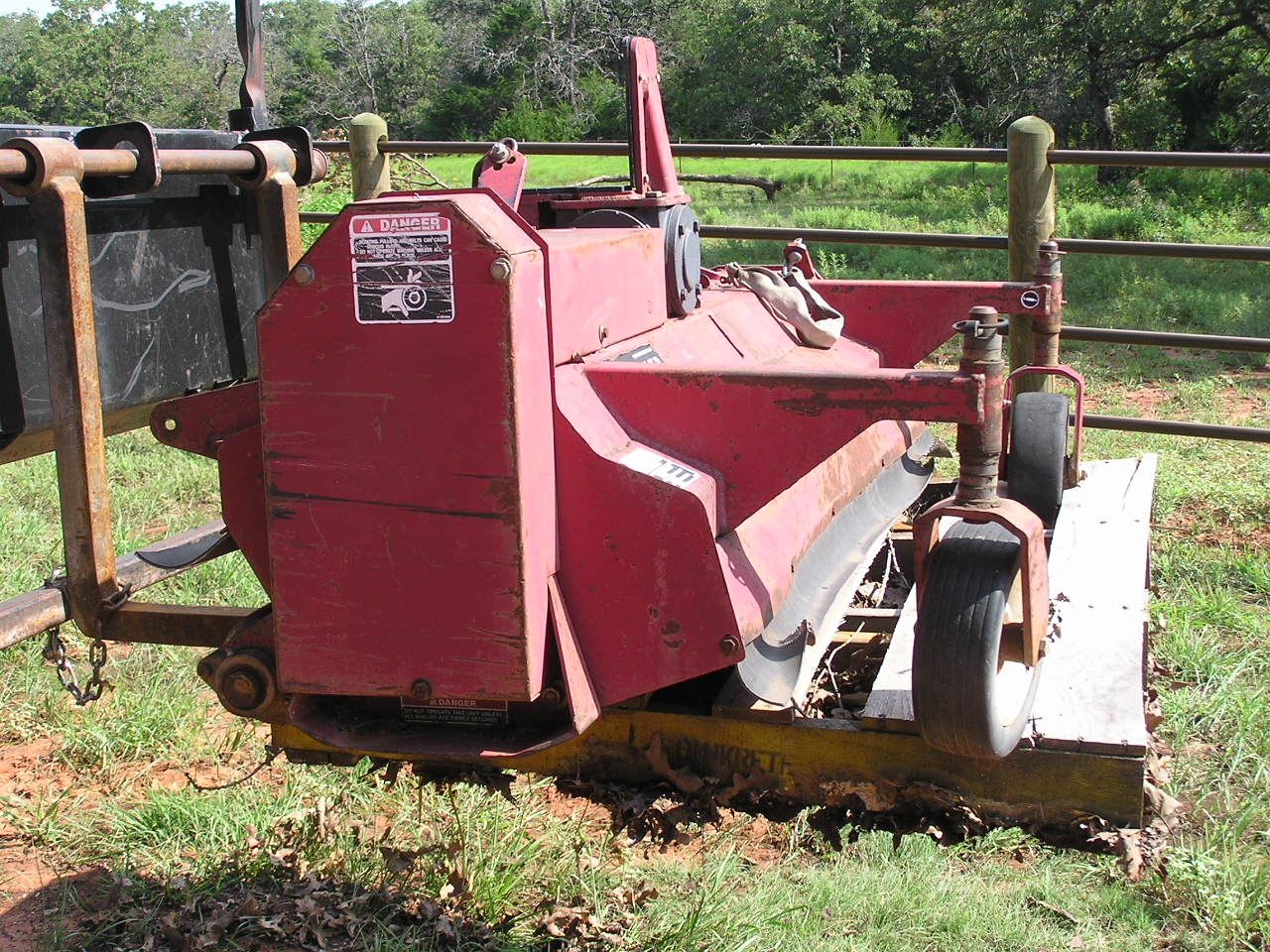

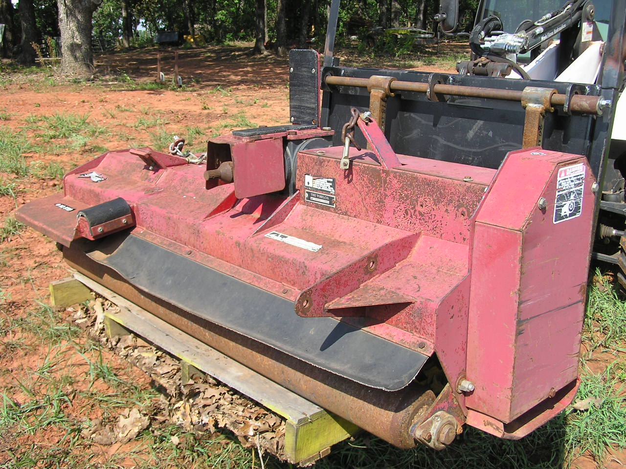

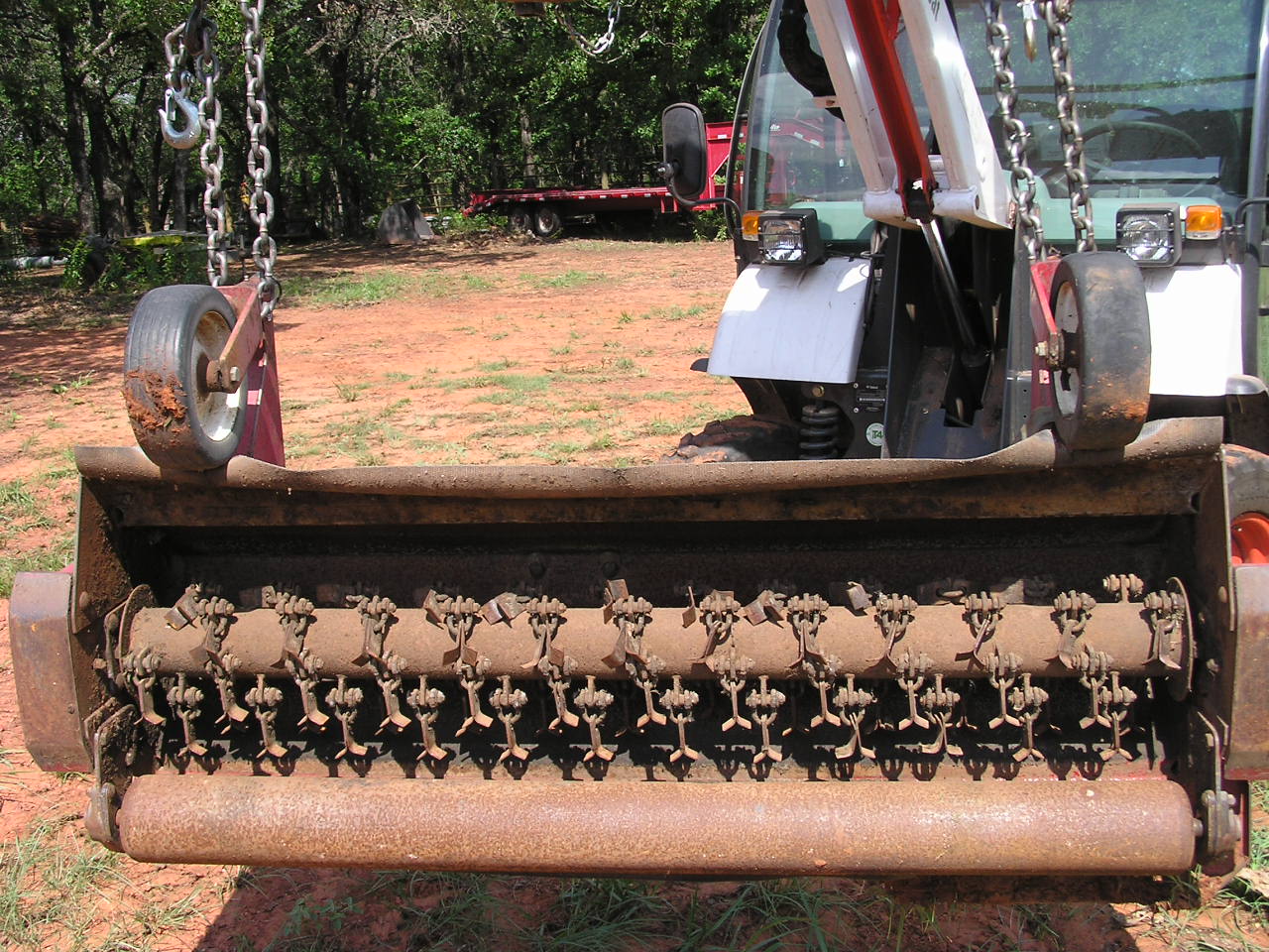

Got this 60" flail deck a few years later.

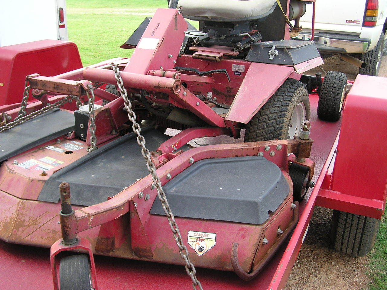

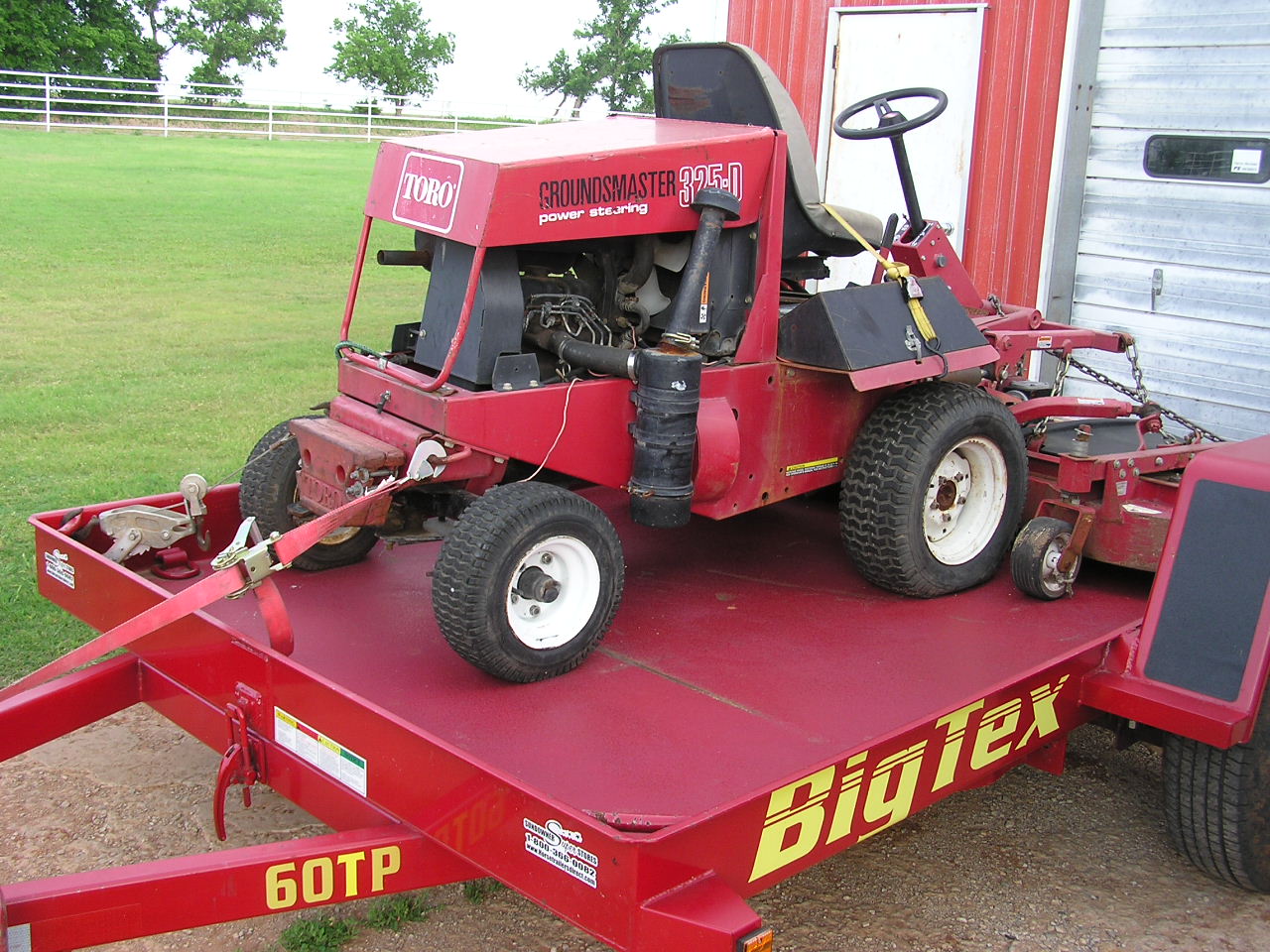

Picked up a parts 325D and a good 72" recycler deck in May of 2008.

Still using all three rotaries, so I have some experience changing decks.

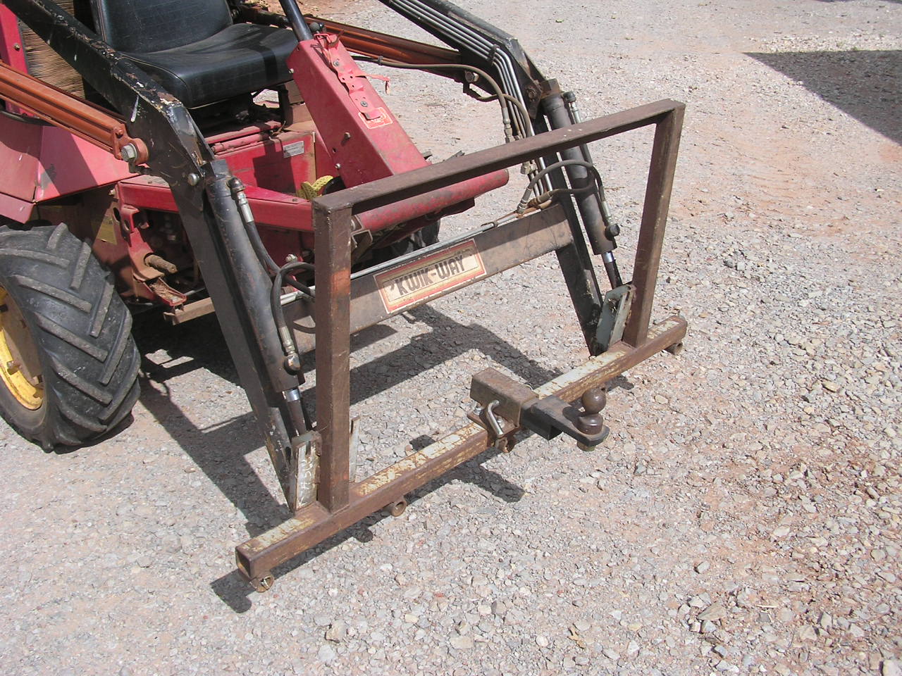

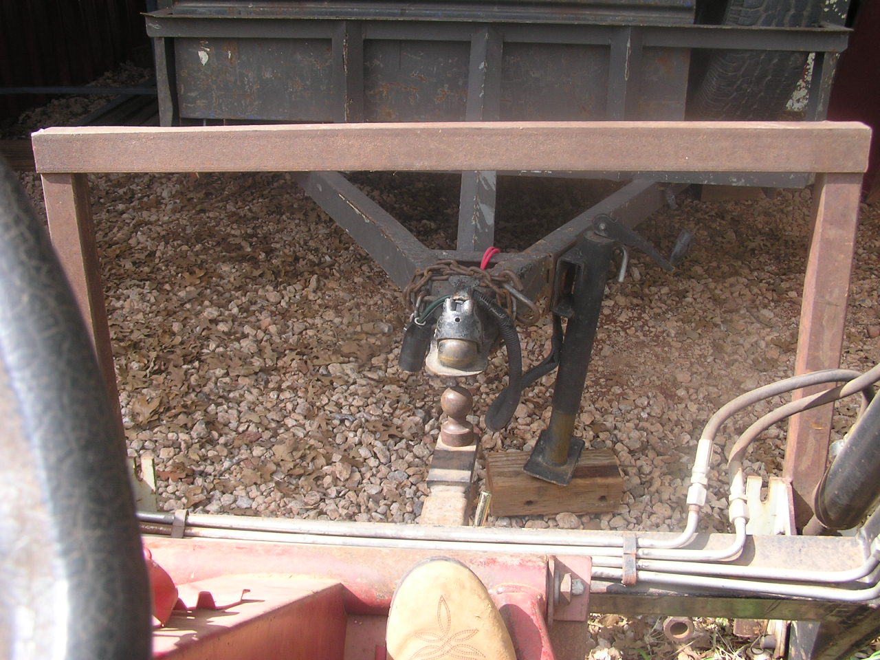

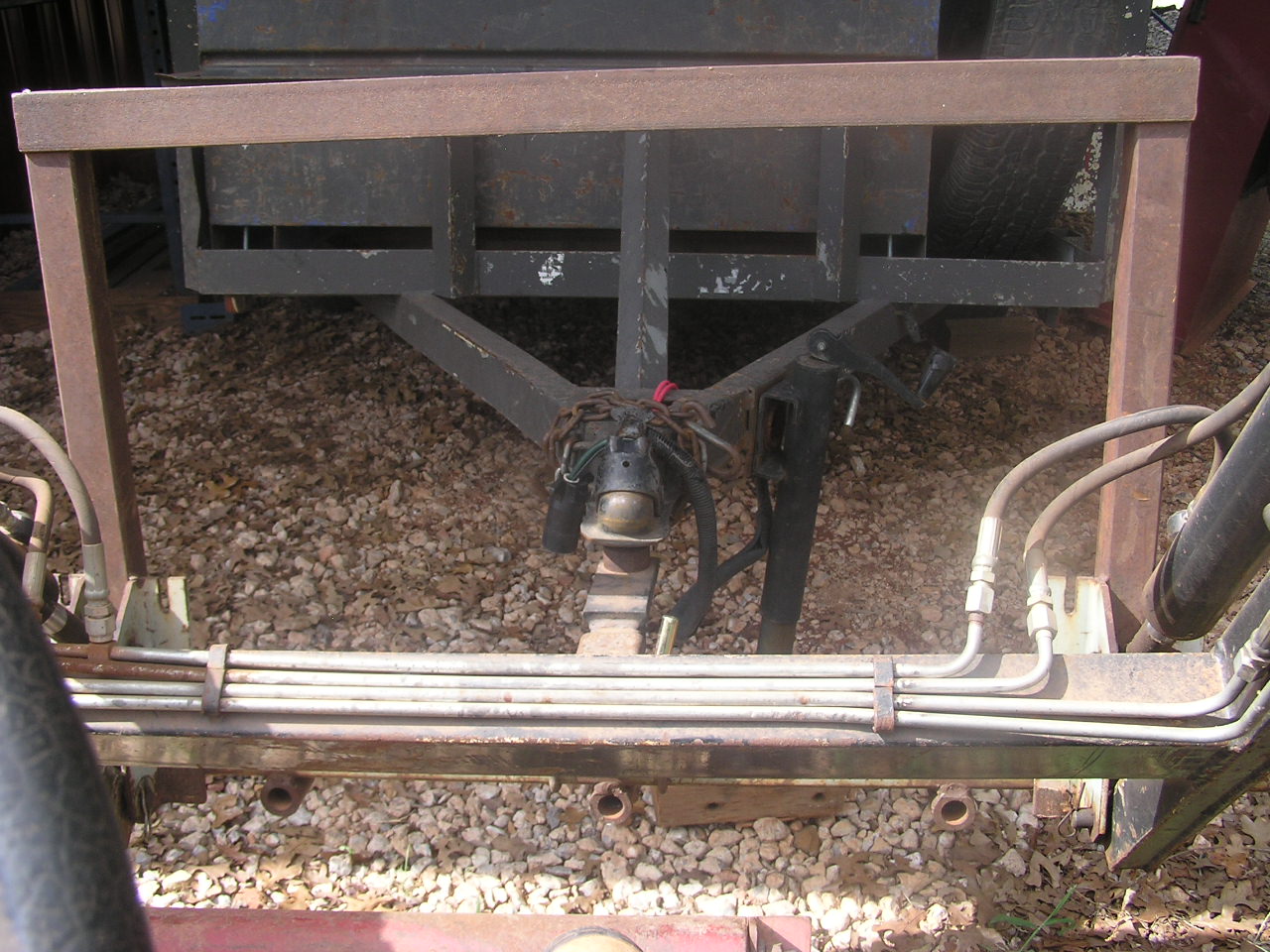

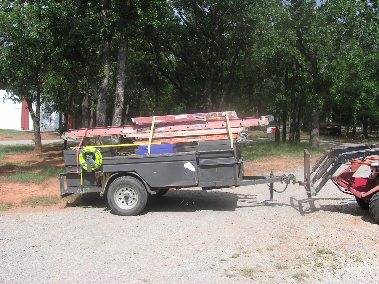

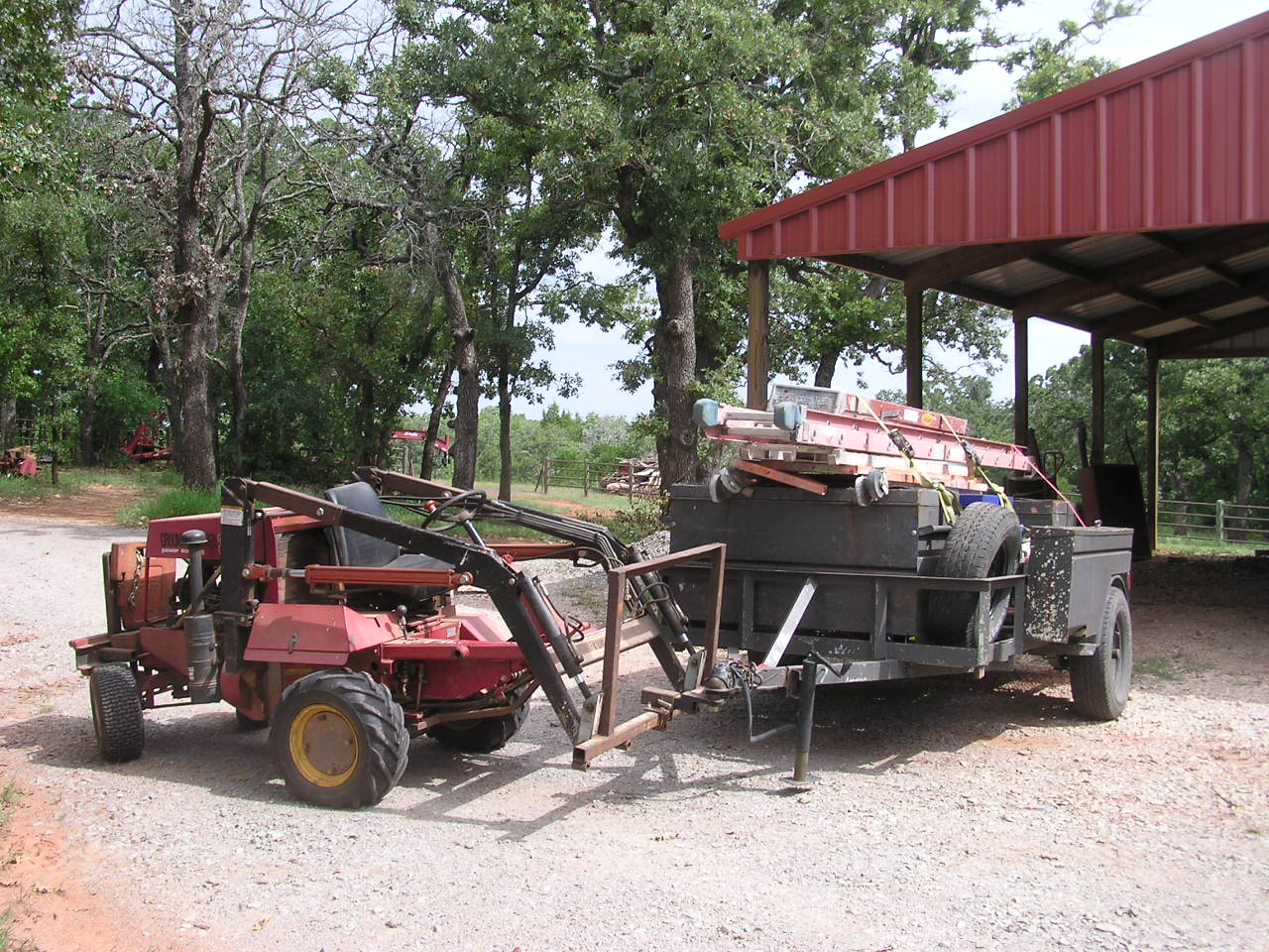

Made this receiver hitch many years ago for a garden tractor, sold the tractor, saved the hitch.
Bought two square U bolts and put the hitch on the brush fork frame. :thumbsup:
The view from the seat.
Very easy to maneuver a trailer.

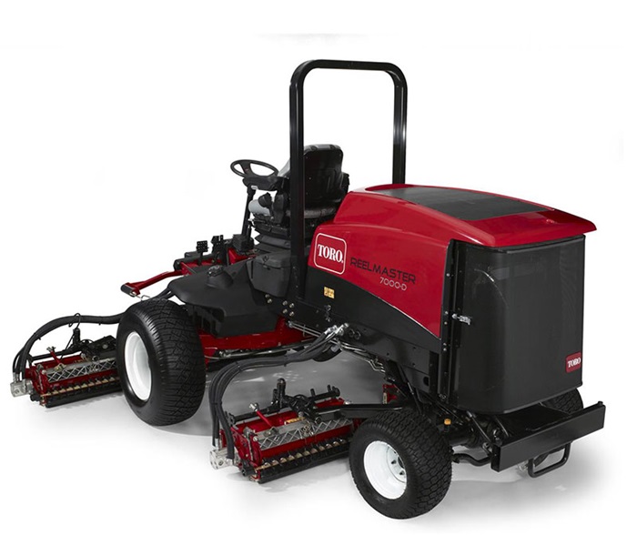

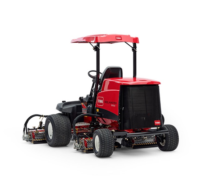

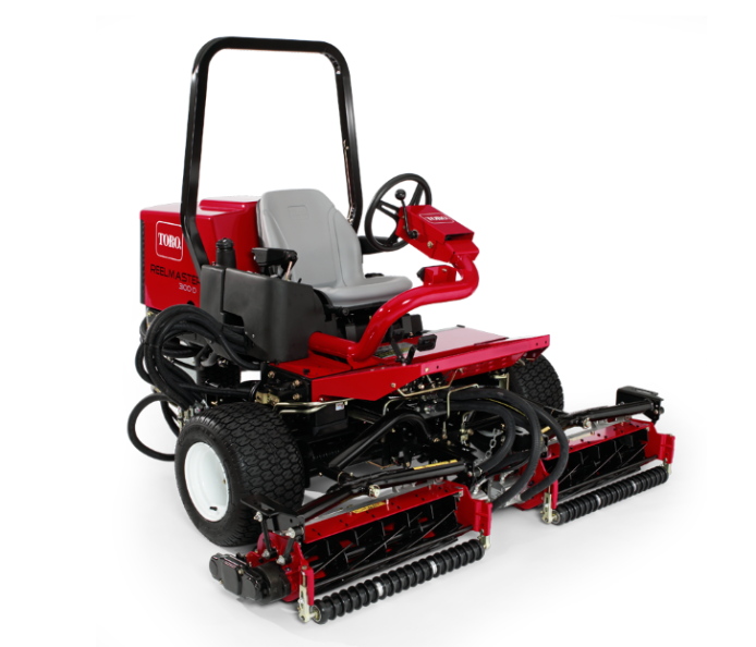

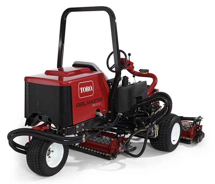

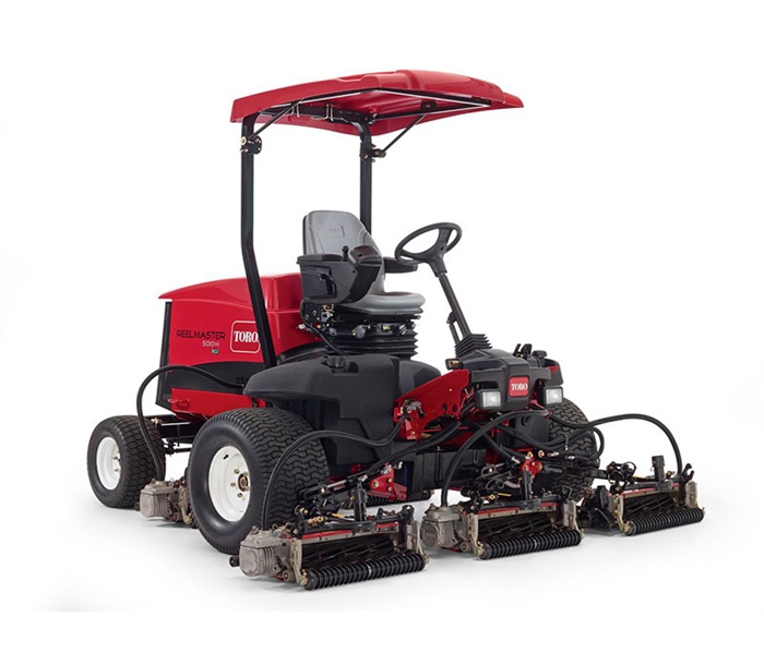

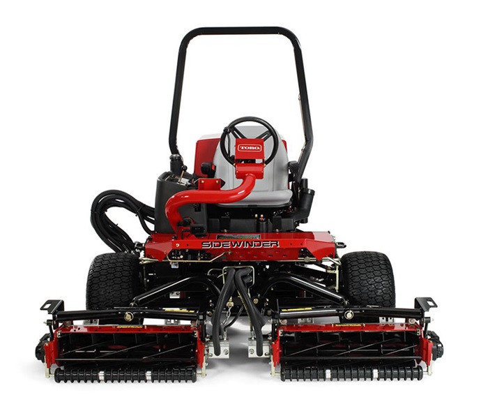

HAs anybody thought of doing something like this with a Reelmaster. They already have the big hydraulic reservoir and extra hydraulics to run the reels.
Don't know if that would make things easier or not
   / FEL, TORO Groundsmaster Put Together
#67

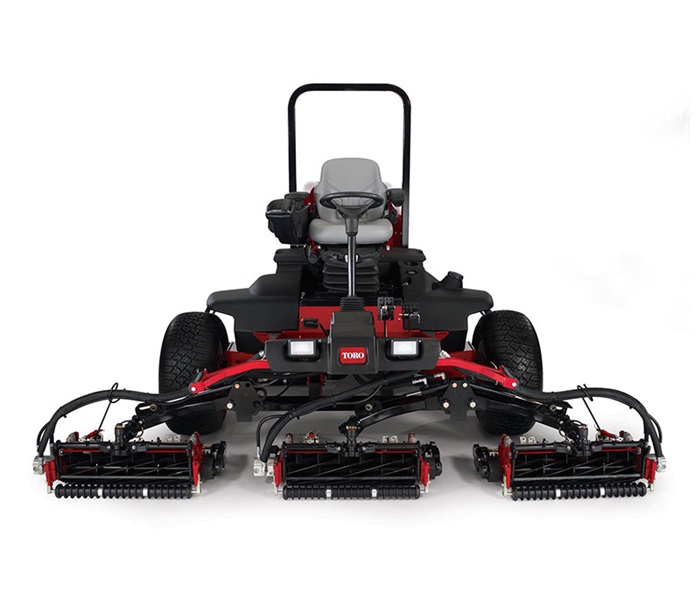

Yes, the first time that I saw a Reelmaster without the reels for sale on eBay. They are wider, so would be more stable on side hills with a loader added.
They come in many sizes: Toro | Fairway Mowers, Golf Course Mowers
   / FEL, TORO Groundsmaster Put Together #68
I recently traded a Toro 223D Reelmaster for a Polaris 500 Sportsman 4x4 4 Wheeler. I would probably want a bigger machine thatn that for such a project. The machine was huge. but the engine was only 23 hp
