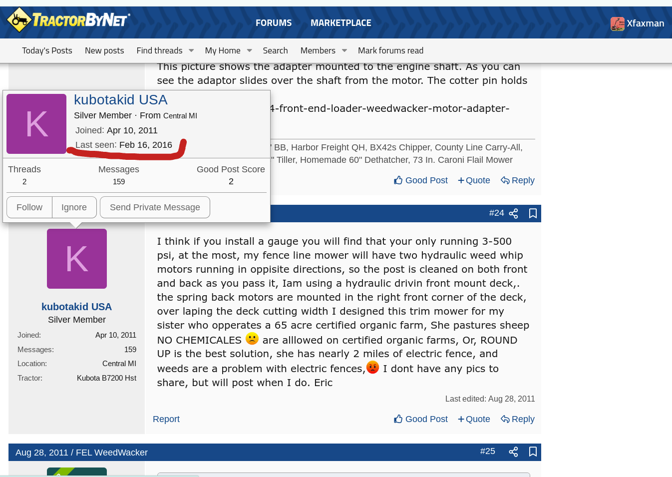

I think if you install a gauge you will find that your only running 3-500 psi, at the most, my fence line mower will have two hydraulic weed whip motors running in oppisite directions, so the post is cleaned on both front and back as you pass it, Iam using a hydraulic drivin front mount deck,. the spring back motors are mounted in the right front corner of the deck, over laping the deck cutting width I designed this trim mower for my sister who opperates a 65 acre certified organic farm, She pastures sheep NO CHEMICALES :( are alllowed on certified organic farms, Or, ROUND UP is the best solution, she has nearly 2 miles of electric fence, and weeds are a problem with electric fences,:mad: I dont have any pics to share, but will post when I do. Eric
