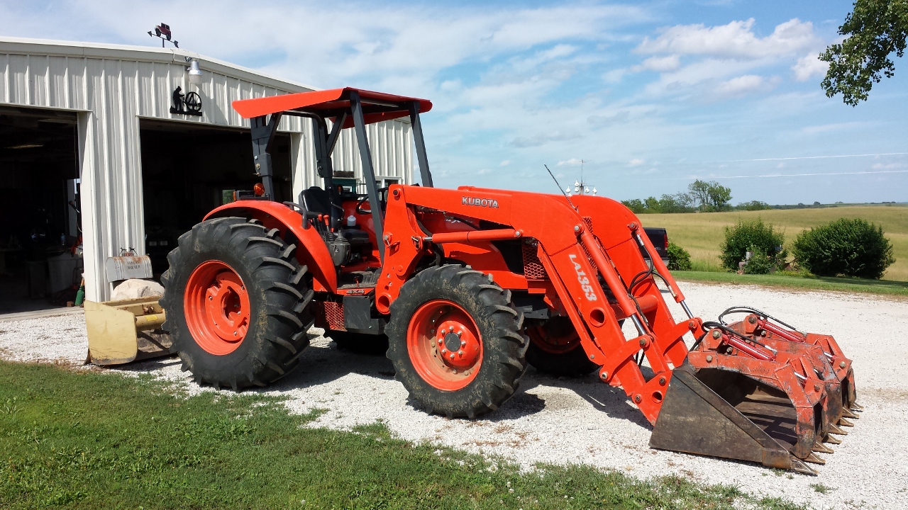

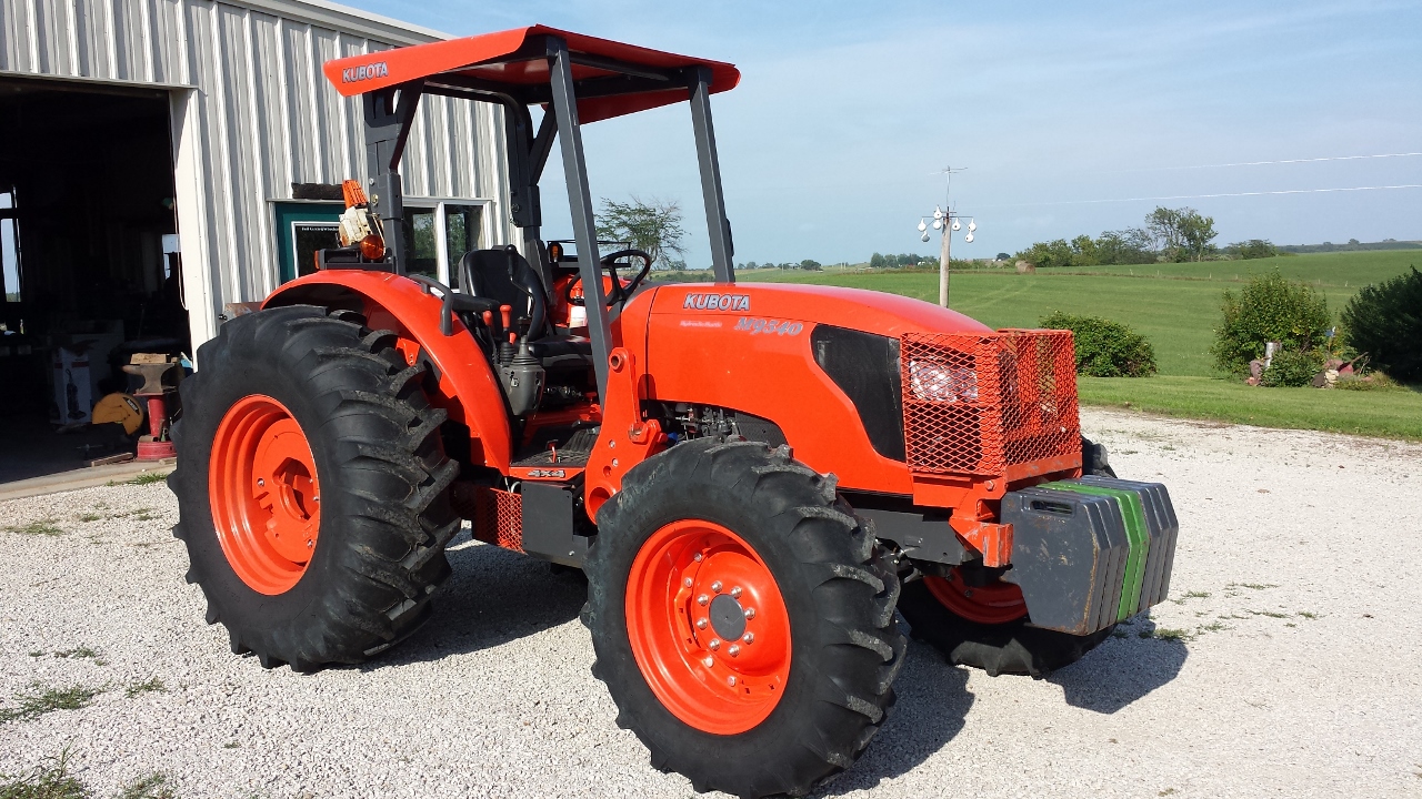

Wow, I wish my 584 looked that good!
I see little reason to take off any of my FEL's. I have had them off to split the tractor and to see how the tractor performed without them. At this moment, I can not see any future reason for ME to remove any of my FEL's.
I have hay fields, heavily wooded areas and lightly wooded acres.
