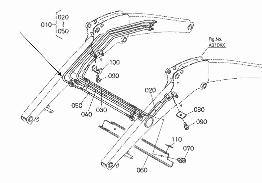

These are my thoughts and I could be totally off. If it was bent, it would curl slow both ways. It only curls slow when I curl back. I tested the curl back under load and even though it is slow, it hasn't lost any strength or does it leak down, so that is why I am questioning the seals being bad. I seems like there is a blockage somewhere and it's got getting the fluid fast enough when curling back.
The OEM steel line will be delivered today. I want to get that on so I can get that out of the way. When the hydraulic place made the line, they had to use elbow fittings for the tight corner bend. Sometimes I wonder if that fitting is a bottleneck for the flow of fluid since it would reduce the inside diameter of the line at the elbow. I know, I am reaching.
If you look at the picture below, line 50 is the one that burst and was made by the hydraulic shop. If you look at my arrow, it points to a 90 degree bend. They could not make that bend because the fitting next to it was too close, so they used an elbow to make that bend.

I disconnect both rams from the bucket and cycled them back and forth. Both rams were both very slow moving back. What are the chances that the seals in both cylinders blew? I wonder if the issue could be in another part of the system. I did remove the QD's and was able to push the ball on both and they both reacted the same. I also visually looked at both cylinders and they both look true and straight.
