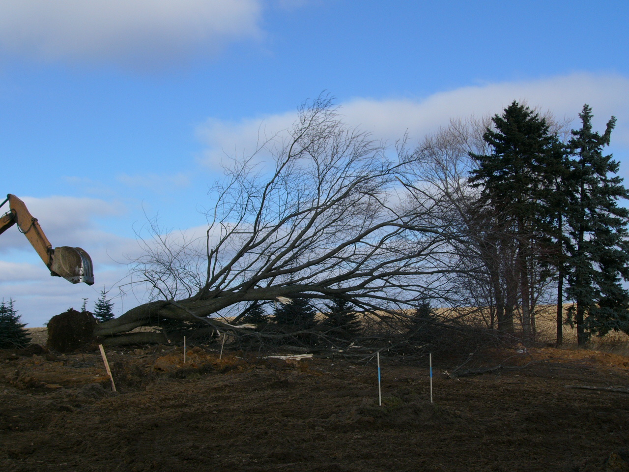

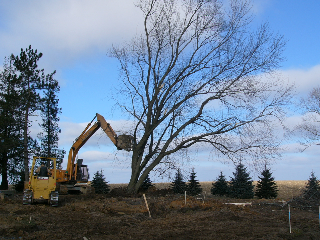

I dropped several big (100'+, 2-3ft diameter) pines last year. I had a neighbor help me - he is a tree guy. He tossed a cord using a lead-shot-filled bag way up into the top of the tree, then pulled a climber's rope into the tree using the cord. Once the rope was tied off, we had a pull point that was 70+ feet up. The rope was tied to a convenient object in the direction we wanted the tree to fall (but well farther away then the tree was tall), then made a "knot come-a-long" to winch the tree over and generate tension. After a wedge cut was made in the direction of the tensioning rope, I hung on the rope to add even more tension, and he back-cut the tree. Every one fell w/in several feet of the target.
I also dropped a dozen small trees (less than 40' or so) recently - I just dig a bit around the roots with my backhoe, then grab around the trunk with my 'hoe bucket and and rip it down, root ball and all, then drag the whole thing off to the burn-pile.
