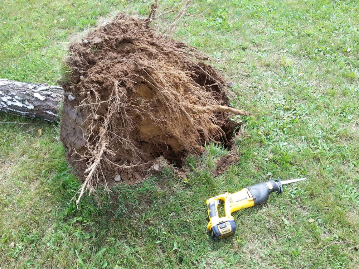

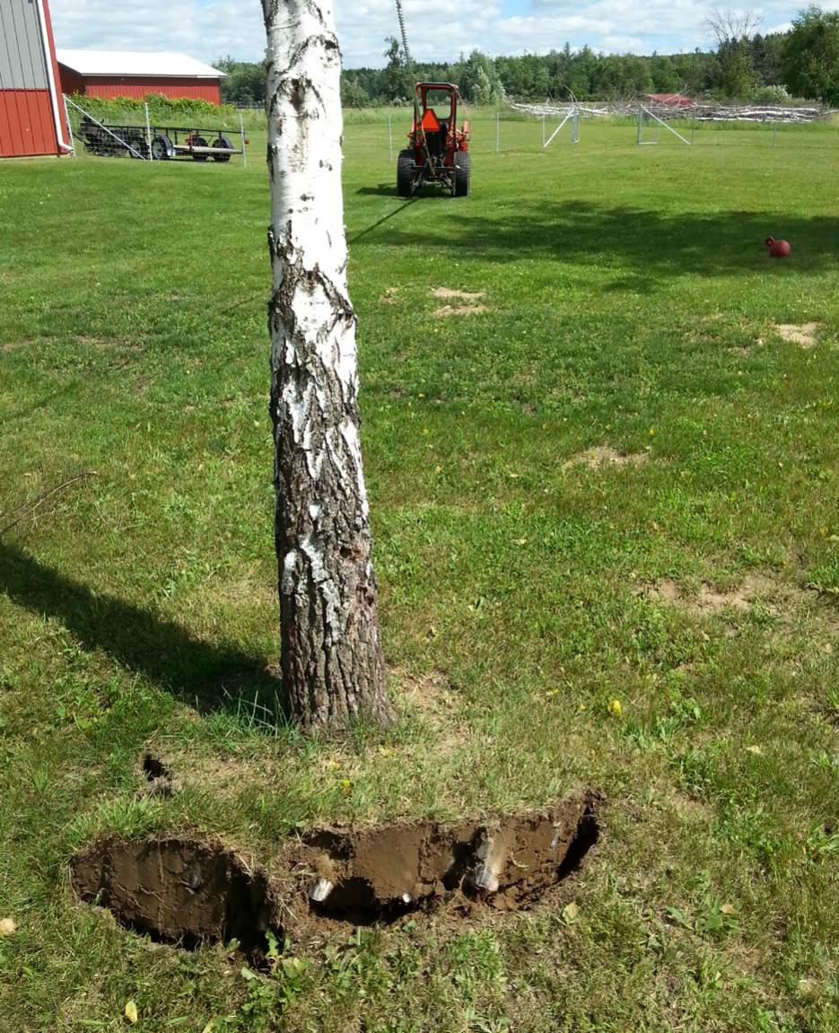

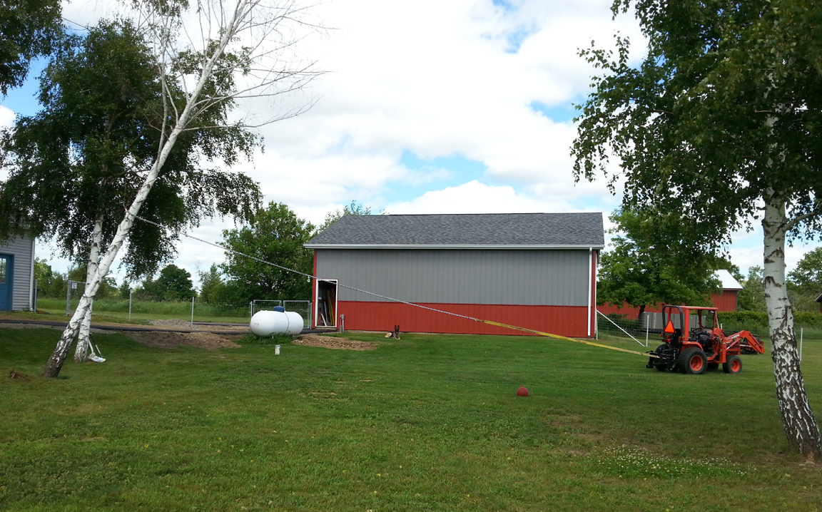

When I moved to my current property a year and a half ago there were many dead and broken birch trees from insects and a the previous icy, windy winter. I originally cut many down with a chain saw and then dug out the stump with my backhoe. A few months later when I had time to take more of them down I had a better idea. I would take my first length of chain up a ladder and fasten around the tree, usually about 12-13 feet up. Then I used my saws-all with a carbide tipped blade to go around the trunk and cut as many of the major roots as I could. Then finish attaching the necessary length of chain and tow strap and pull with the tractor in the direction you wanted the tree to fall. Cut tree into manageable pieces, poke the root ball with an ice spud or whatever to get off as much soil as possible and haul everything away with my fork attachment. The largest tree I pulled was about 18 inches in diameter. This method was probably a little easier than some other type trees since birches don't have a tap root. But then, I don't have a very big tractor either. Took 5 trees down, including cleanup, this way for my much younger neighbor in 3 hours. But the sawing method was too slow for him and he used an ax to cut the roots. Pics show me taking one down in my yard.

Yes, I've found that if you can push the tree over and then dig it out, it is by far the fastest way to remove a tree and stump. If you have a nice fire going I've actually fed whole trees right into the fire to burn them. Best way out there to dispose of Box Elders.
