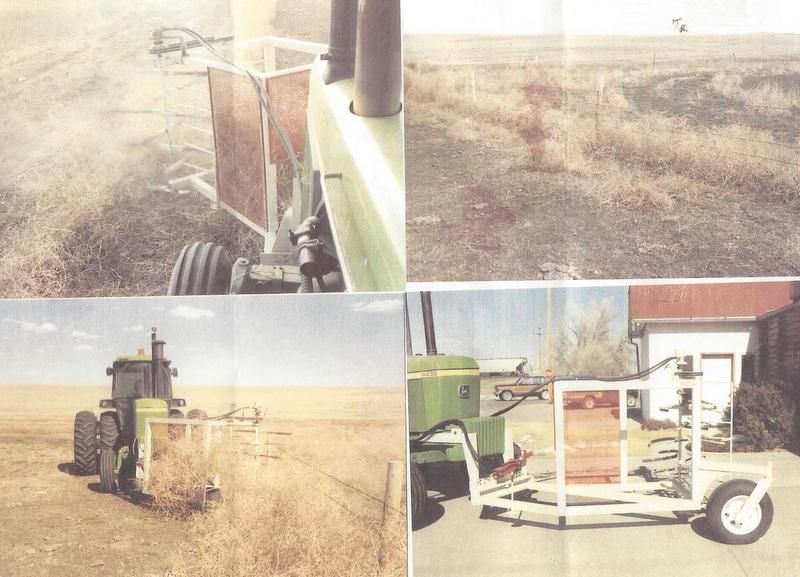

been considering making a fence cleaner, and I was sent the pictures below some years ago,
and looking on YouTube,
Innovative Tumbleweed Removal - YouTube
one other place.
Stelter Repair, Inc. of New Leipzig, North Dakota was founded in 1943
below are two pictures that are represented of the problem.
ANY IDEADS. I think the first idea is the better, it uses V belt sections like a string trimmer, works and if you look close there appears to be bars that the weed gets broke up in and the shield is to keep the "ground weed from coming back on the tractor, I was thinking some thing that could quick attach to the loader and then let the loader float, (to my under standing the guy that sent me the photos is no longer making them). and were more than I wanted to spend,

found a video on the shelter repair unit,
it uses the brush to sweep off the fence and a flail mower to beat them up,
the top one I posted the pictures for from prestige manufacturing, Prestige Manufacturing, Inc. - Home - Kimball, NE basically uses a belt system similar to a combine spreader to sweep the fence and to beat them up, as stated there are a few bars that the belt look like they work against,
the first one looks easer to use as a guide, as my thought was to mount on the loader of the tractor?
Any ideas on the rpm of the rotor belts to make it effective, combine spreaders usually are turning at about 400 rpm I would think some.
faster, the blue machine looks gentler on the fence, but much more costly and complicated, to build,
another idea is to use the sweep head, then make a roller to smash them and then use the PTO bush hog to chop them as crushing them usually does not do that much they spring back,
(one year I pitched fork them off and thought I would use a old bailer to smash them the knotters were not working so I did not tie them, most of them sprang back in a few day enough to blow back in the fences, and this was a old Massey #1 bailer, (small bailer),
so just crushing them is not that helpful,
I like the flail mower Idea, as well,
NO Ideas or opinions? I have about 12 miles of fences to maintain,

I did find a patent on the first one pictured, 3,444,674. Patent US3444674 - Fence cleaner - Google Patents
when looking at the pulleys in the drawings there using gas engine, and the engine pulley looks to be about 4 inches across, (drawing1/4") and the pulley on the beater is nearly 12" or slightly less than (3/4") on the drawing in Figure 3, now that would (if a 3600) rpm engine that would be 3600 x 4 =14400 divide by 12 =1200 rpm. for the beater speed.
Sound Right?

basically the first machine is about what it is but there are multiple (spreaders) beaters/flails spaced up and down that will clear the fence from ground to top of it, and to improve the "grinding efficiency" there are bars of steel between the beater/flails.
what I am thinking right now is to make a quick mount base so it will fit on my loader, but make it pivot from the center of the mount so it could be used on right or left hand sides of the tractor, and possibly make it tilt so if the tractor is in a slop like a road side ditch, the head could be keep at the same as the fence, at least that is where I am at currently, trying to make a decision on motor (most likely a hydraulic motor, but my tractors GPM is not that high, so I may end up having to use a PTO pump and make it's own hydraulic system, (which cost wise may kill the project for this year as a pump would be in the 500+ and oil tank, and enough oil to keep temperature down, plus the motor and hoses,)
