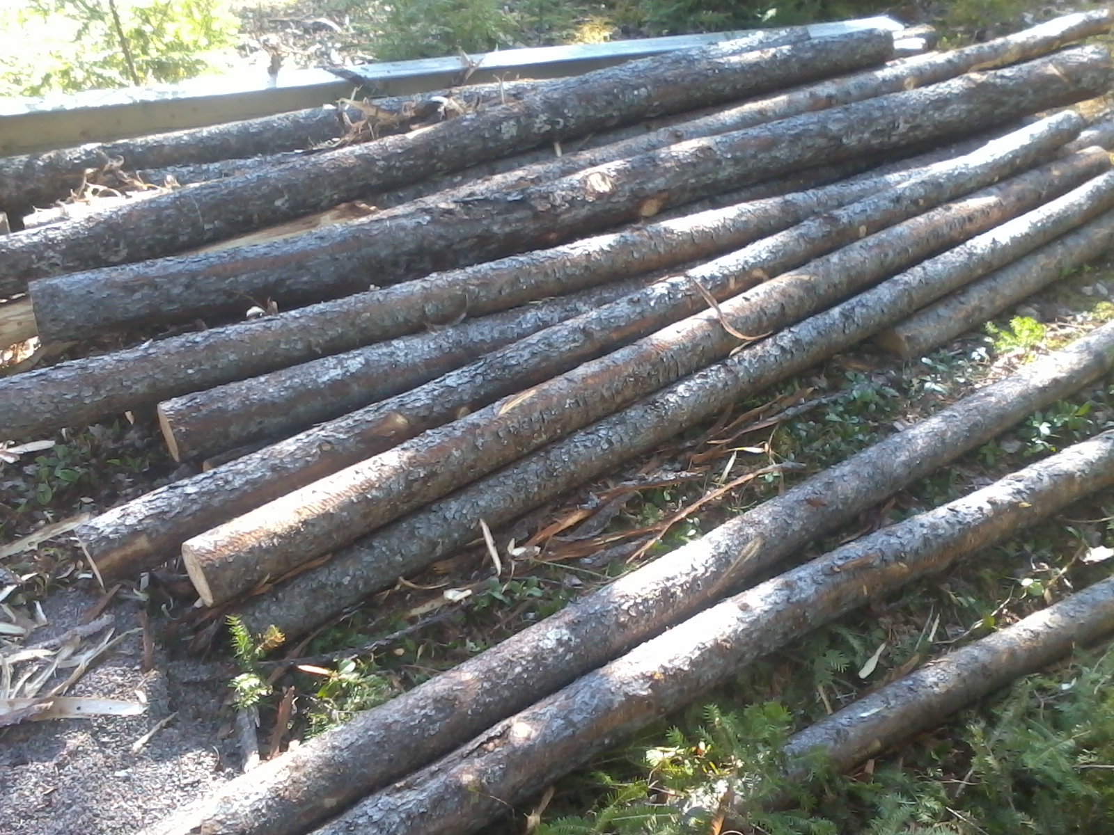

I just came home with 56 fresh cut cedar fence posts now I need to get the bark off. Back when I was a kid, we'd wait for the moisture to form under the bark and use a spud to peel them but I don't have 6 months or so to wait, I want to use them next weekend.

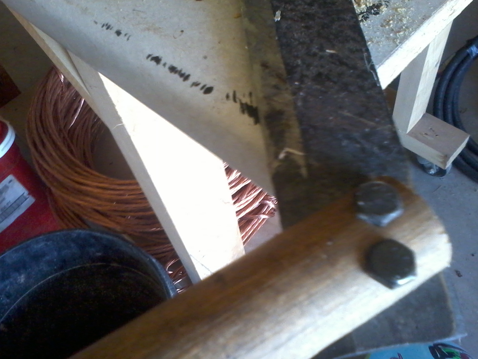

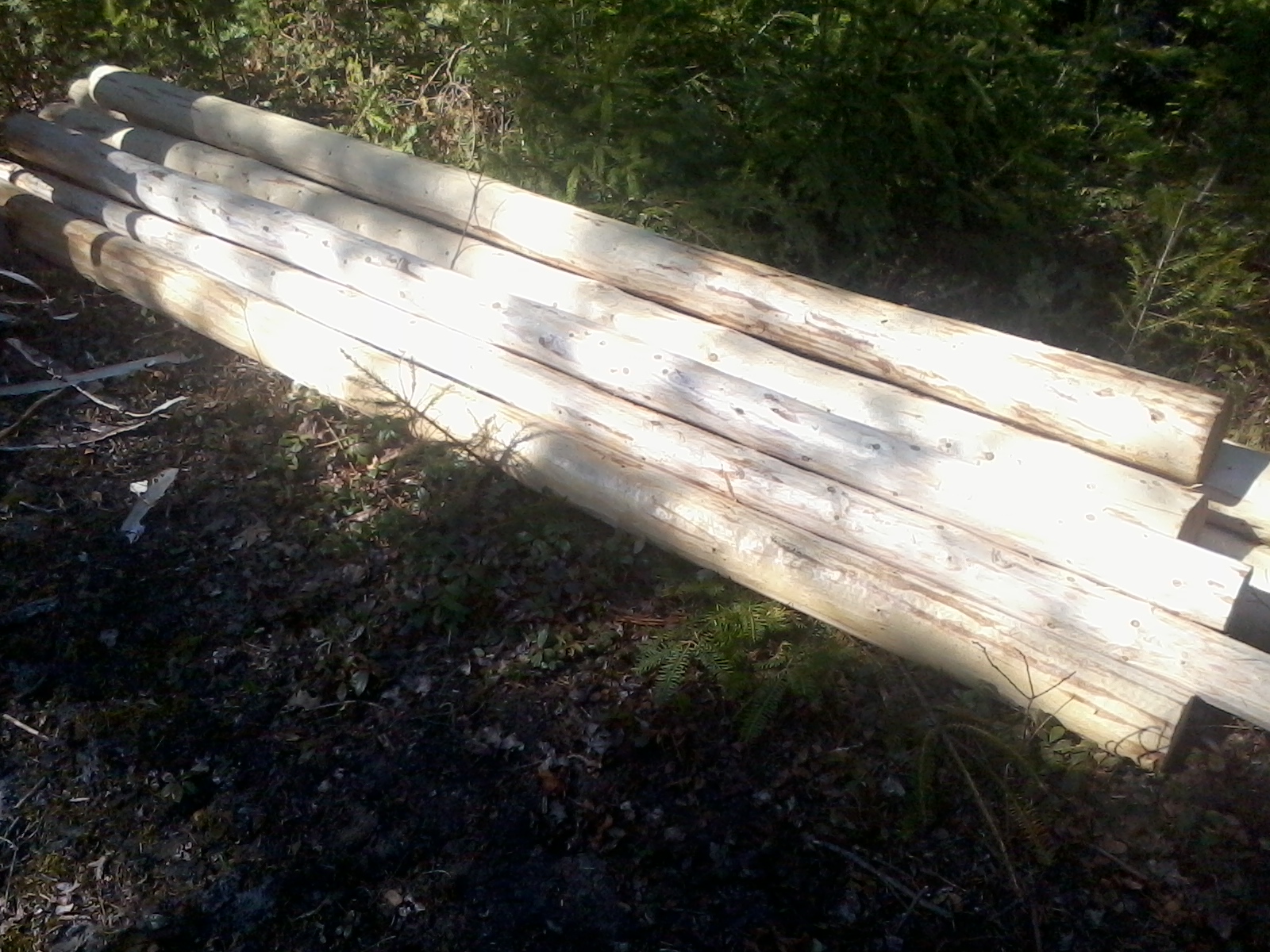

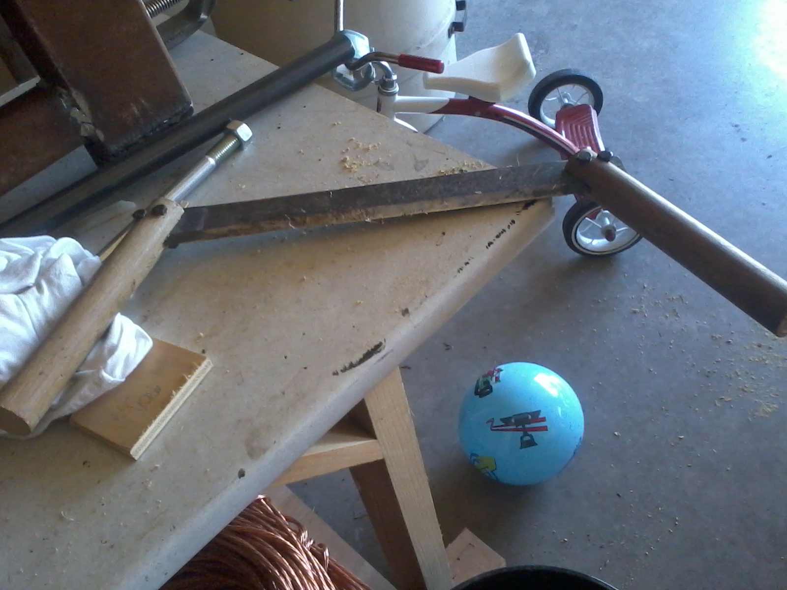

I just made a homemade draw knife at work out a piece of hard plate we use for wear liners in our concrete mixers and started peeling them by hand. Got about a dozen done so far (2 or 3 hrs into it so far). Just put the Peavey's out back and blasted some music while I was peeling. Can only do that while the wifey is at work, she thinks I'm going to deafen myself playing it that loud.

Some neat ideas brought forward, and sounds like the chains on a rim idea would work. At this point, my contraption is on hold and I've got my posts peeled.
I'd walked by the pile with a shovel on my hand and gave one of the posts a poke and a chunk of bark came right off. Poked away at it for another few seconds and more came off easily. Went to the shop, grabbed a spare shovel handle and a chunk of scrap steel and built a spud and started peeling. I was peeling strips several inches wide by half or 3/4 of the post on one shot.
It was working well but seemed almost easier to just pull by hand. Back to the shop, 2 saw horses and a 3/4" chisel (no idea where my draw knives are) and I was back in business. With the exception of 4 that the bark was too dry, I was comfortably peeling 10 an hr. By that math, I couldn't build what I had in mind in that time.

Steve_Miller,
I see your pics of the fence posts. Why go to all the extra work of peeling them? Does it have something to do with longevity? I use 100% T-posts because Ponderosa pine just doesn't last long at all. And about 35% to 40% of all my T-posts are in holes bored in solid bedrock.
