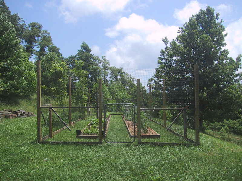

I intend to build a fence with "deer fencing" which is a plastic lightweight type of fence. The fence is to cover an area about 75 feet wide by 150 feet (these are aproximations) where I intend to garden vegetables. I will have to set a whole lot of 8 feet poles probably no deeper than 1.5 feet.
Having installed such a fence, I am a bit concerned about these specifications. Are you planning on 8-ft posts, or posts standing 8 feet out of the ground? My research suggests the fence needs to be around 8 feet tall, so the posts need to be taller. I used 12-ft posts, and set them 3 feet deep. I rented a PTO post hole digger for the job, and it was well worthwhile.
The corner posts especially have to be pretty substantial - the netting wants to sag and has to be pulled fairly tight, and with 8-ft posts you need substantial bracing, which means digging holes for brace posts too unless your line posts are close enough together to brace to them.
Some have suggested t-posts - I don't know that you can get them long enough, and if so I don't think are a good idea for a fence that tall, especially if you get any weather. The netting provides a fair amount of sail area, and will catch the snow if it's blowing, increasing the wind pressure on the fence.
Our fence:
