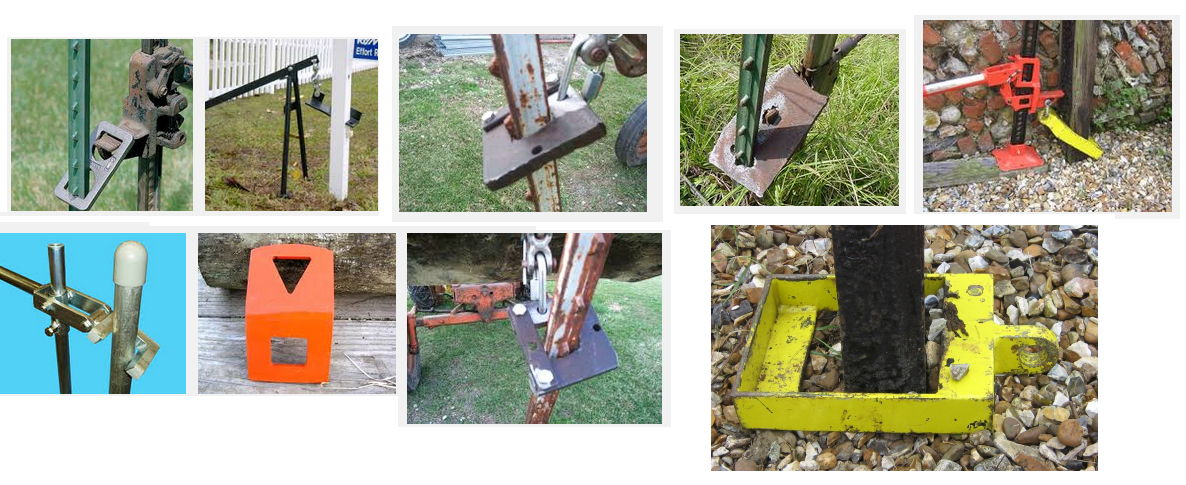

What kind of posts are you pulling? Are they all about the same size? Many posts can be pulled with a piece of metal with a hole in it, a little larger than the post. Drop it over the post, then pull it up from the side.
Here is the basic idea in several versions, both "C" and "O" style.

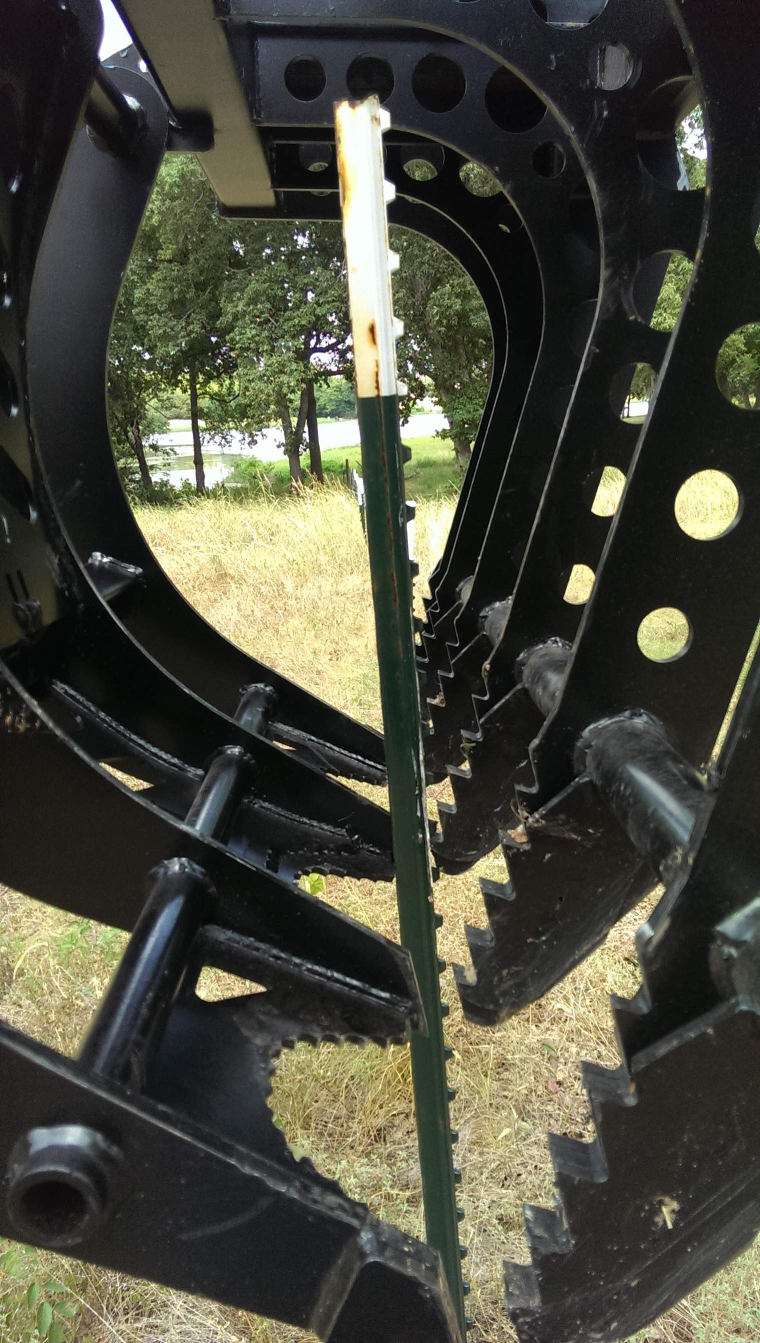

My T-post puller...

A little overkill, but I'd have a lot more use for that than what was in the link
