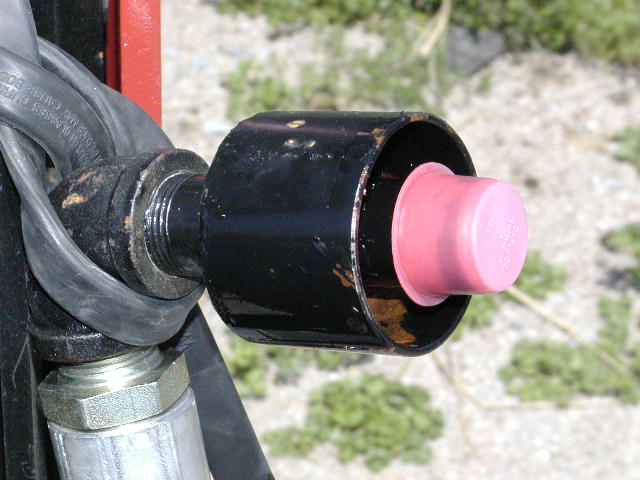

Also, the return line that dumps the fluid back into the sump on the Worksaver drivers is poorly designed. The instructions say to remove the fill plug and bungee cord the line in place. What a mess. A TBNer modifed my fill plug that allowed me to use quick connects. Male coming out of the fill plug, female on the end of the return line. Almost 0 lost hyd fluid. Much better solution.

I've also attached a picture of the end of the return line that doesn't work so well.
